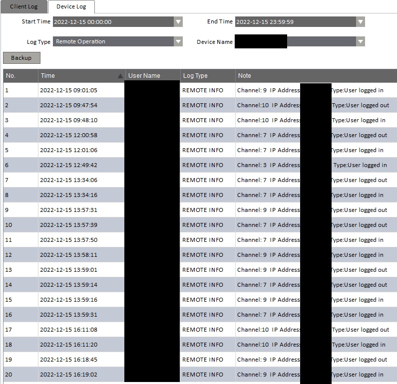

Hello, I am having an issue with IP5M-B1186EW cameras (seemingly) randomly disconnecting and connecting throughout the day. I have a QSee QC826 16 channel NVR (I believe this is a re-branded Dahua unit) and recently two of the QCN8099B cameras (also Dahua rebrands) died. I replaced them with two Amcrest IP5M-B1186EW. They were detected and connected fine, so I ended up purchasing two more to gain more coverage. However, when looking back at recordings, I have noticed that at least once a day since install, and frequently more often, they have had multiple dropouts of about 10-30 seconds, sometimes longer. However not all the Amcrest cams drop at the same time, nor for the same length of time. The camera dropouts correspond to user logout / login events in my log, which look like the attached.
None of the original QC cameras still in service show these issues.
Aside from this there does not appear to be any issues. Any idea what could be causing this behavior? All Amcrest cams have the 2.82 firmware (one I had to upgrade).
IP5M-B1186EW connection log out

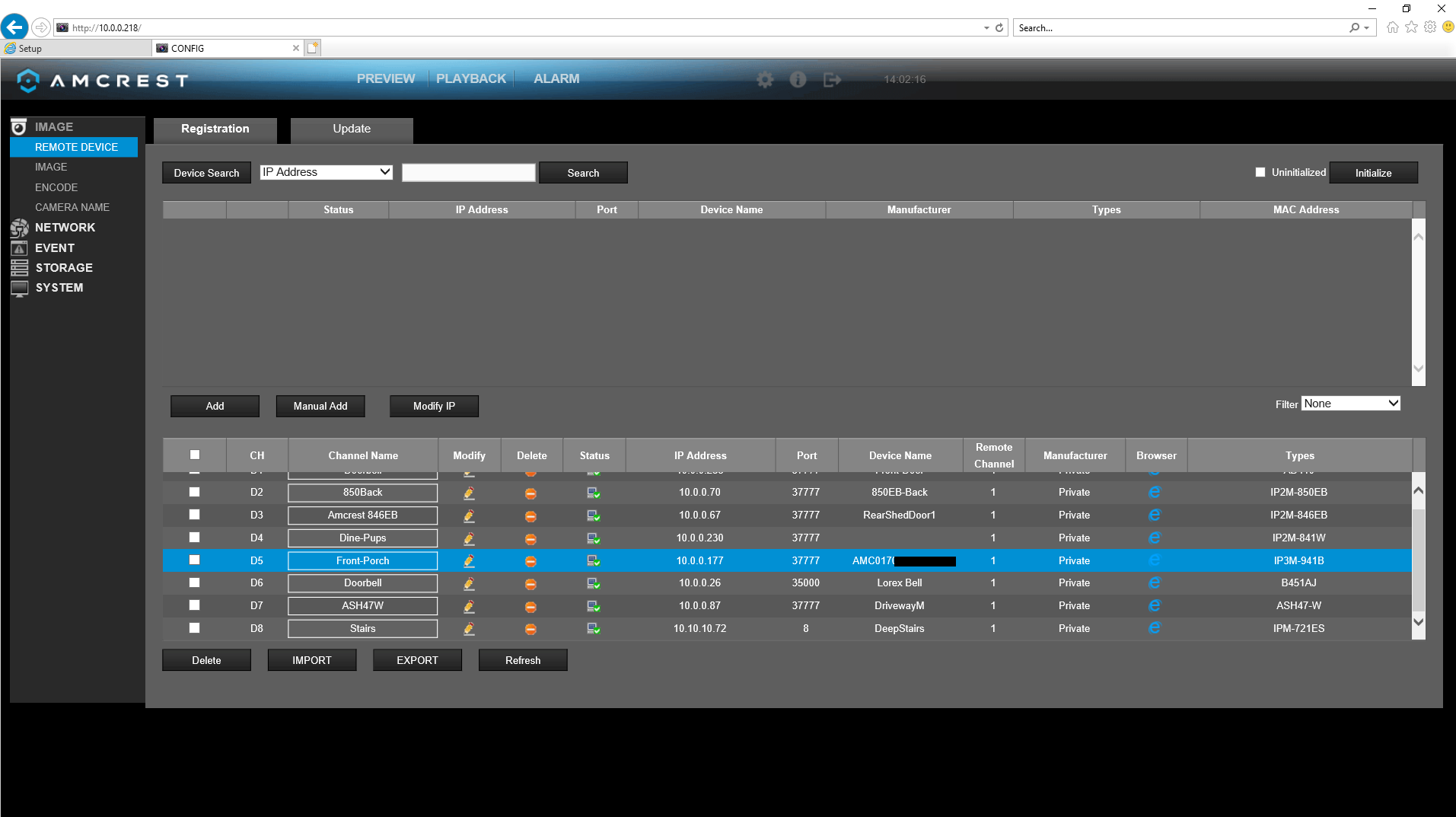

So I don't know what your system looks like. It has been a long time since I see your menu type. I do have a NVR with it just have to dig it out lol. So looking at the oldest one in my lineup in use. When you go to your NVR's WebUI setup, camera, Remote Device does it look like the picture below? Or something that at least looks like you could click the e to get a connection? You might have to enable it under the normal Network Tab. If you have to enable it there would be a box that says Enable Virtual Host or something to give you the ability to make a connection to your cameras behind your NVR's POE.. If you look at this picture below, Port 8 is in use by the NVR POE port the rest are just normally connected. If I hit the e on the ch8 aka port 8 I will get a NVR ip with a port number and I can log into that camera to make adjustments within that cameras.

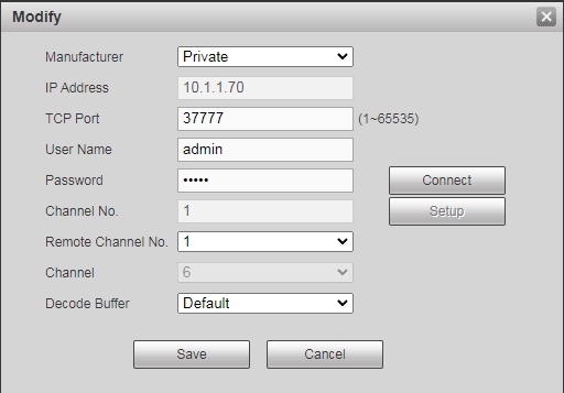

Hello,
Yes, I have a screen that looks like that, but no IE icon to open up any connection. If I double click the Modify or Status icon, it opens the attached window. However clicking on Connect does nothing (for either the original QC cams or newer Amcrest cams) and the Setup button is grayed out.
- AMCam2.jpg (55.31 KiB) Viewed 689 times

No not that.. That is to mod the connection of the camera..
Look in your Network settings and see if you have a Virtual Host Button to enable... if you don't as some don't have the option then only way would be to use A switch aka POE switch or run power to the camera if it is reachable. Then connect the cable to your router..
So Switch with POE to power the camera connect direct to camera to make changes or An injector or 12v power supply at the camera and cable connected to Router/Hub/ or Switch..
