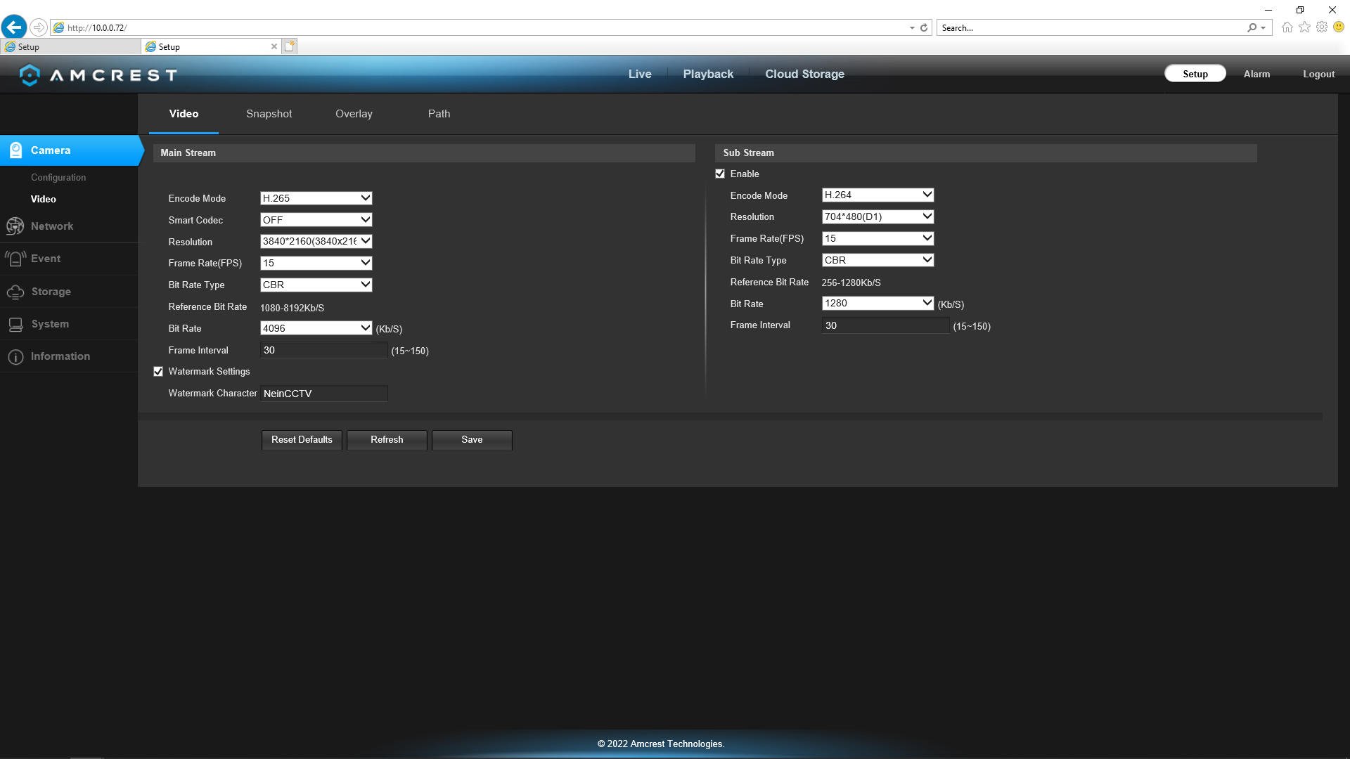

So here is something to try. I would use if you have a POE Switch, or Power Injector or ext power supply to power the camera and connect to your normal network, Log into the Cameras WebUI, (going to the cameras IP address) and once you get in there click on setup top right, then you will already be on Camera however in the left area click on Video. In there I would double check that your numbers are within good numbers for your NVR. Meaning I would get them as close to your QC cameras settings as you can.
It might be that your camera is working in 1 stream the right and in the other it isn't looking at the picture below might give some better idea what I am trying to explain..

Also I would double check your QC cameras settings as I was saying because it might be they are setup for VBR and your Amcrest are setup for CBR.. IT could be that the issue is the Encoding the Bit rate and even Frames as I don't know the true specs of the NVR it is hard to say what it should be running in by default...
I know that you can make changes in the NVR for Encoding, However the reason I said to use WebUI for Camera is because if the NVR and Camera are not 100% on par with NVR having total control of the IP cameras then making the changes in the NVR would not give the results your looking for. Access to the Cameras WEBUI and making that change in the camera you know that change has been made in the camera...

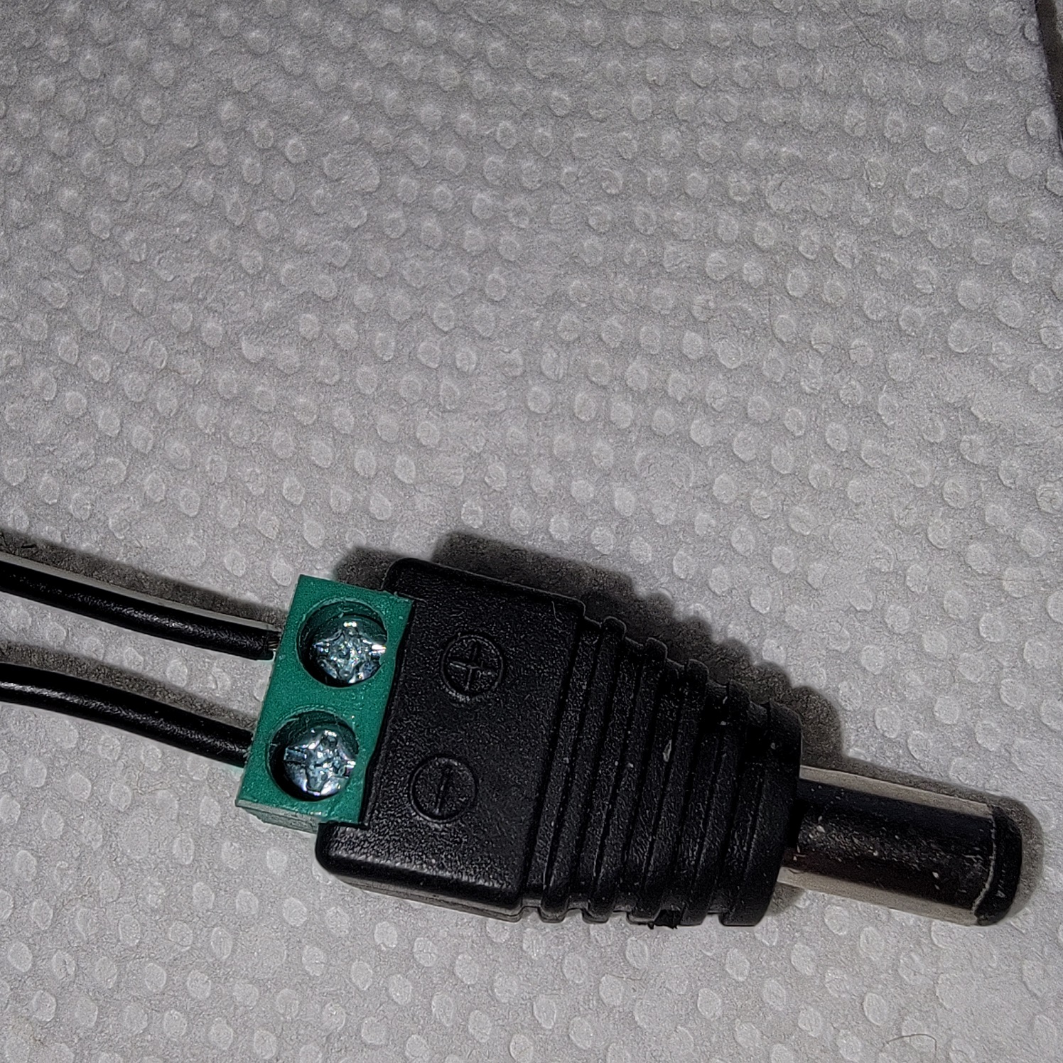

I understand what you are suggesting, I just don't have a POE switch or injector. I do have an adapt-a-plug with a multi-voltage transformer, so I could power it and hook it directly to my router. Do you happen to know which is +DC and which is ground for the power connector?

Normally when you are connecting a DC to a camera the outside of the male end is Ground and the inner side of the jack is Positive. So in the picture below that silver part showing is Ground.
Normally cameras that are POE are 12vDC when using a Power adaptor.

Yes, I believe sleeve is usually ground, but not all manufacturers are the same. I couldn't find any documentation to back that up and the plug doesn't have the usual polarity marking and I didn't want to fry the camera. Just for clarification, did you find Amcrest info, or just going by typical specs?
