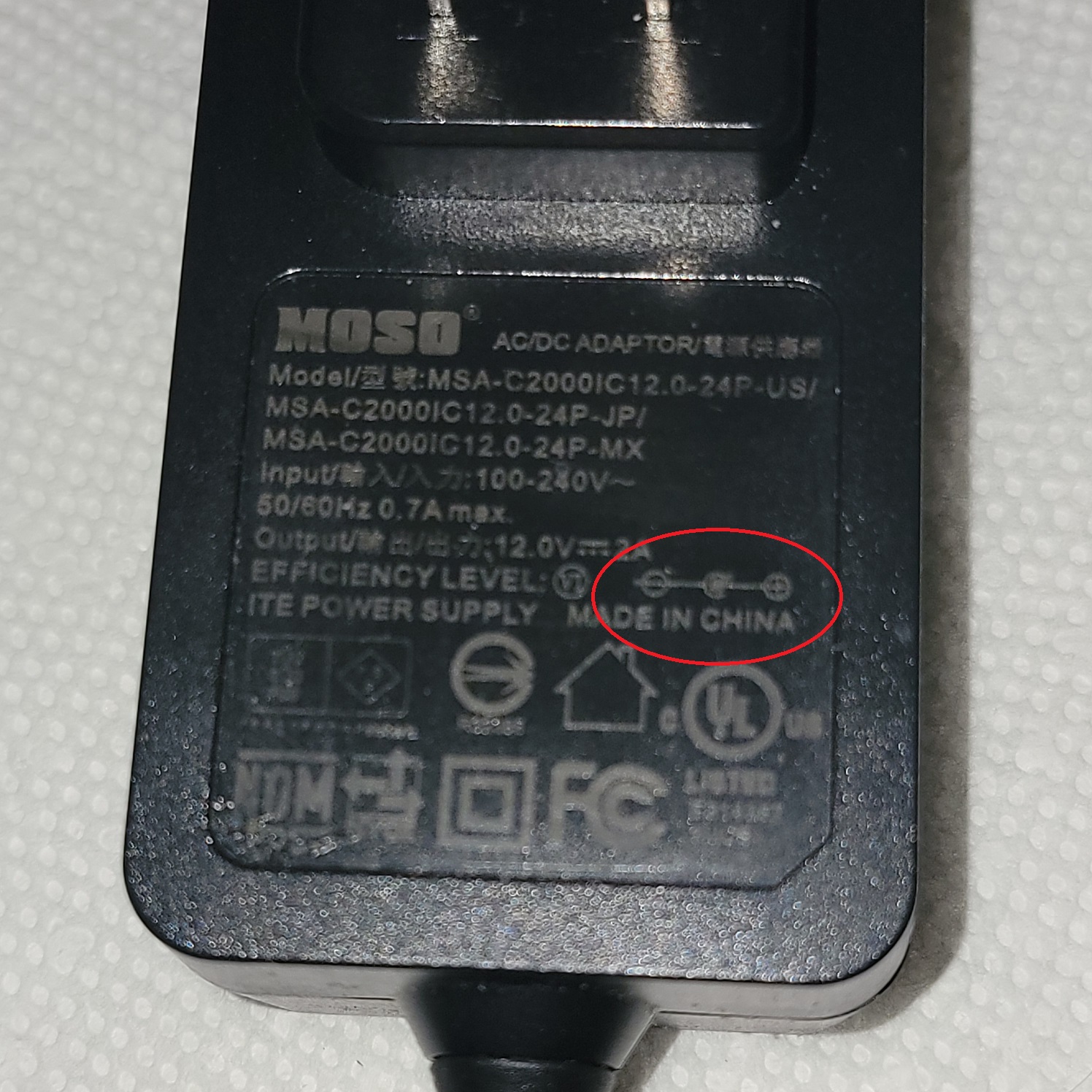

Oh sorry, Also now that I think about it. If you look at the Power supply that comes with the Amcrest cameras. They will have the Diagram of how you should connect it. Some POE cameras come with a PSU even though they are POE if yours did it would have a Picture like the one taking from one of mine that is POE but came with a Power Supply..

Hmm, if the POE and adapter power rails are not isolated, then I can hook a cam up via POE and then probe at the plug to find which is + and -. That would verify what the adapter you pictured shows. None of the QC nor Amcrest cams came with adapters as they were POE.
EDIT: It's too late tonight to pull a cam, but using my dead QC cams I verified on those sleeve is GND. They were showing only about 8.25 vDC, so perhaps some component(s) have failed and are drawing down voltage (unless the 12v requirement is a max and cams can run lower, I defer to your knowledge on that).

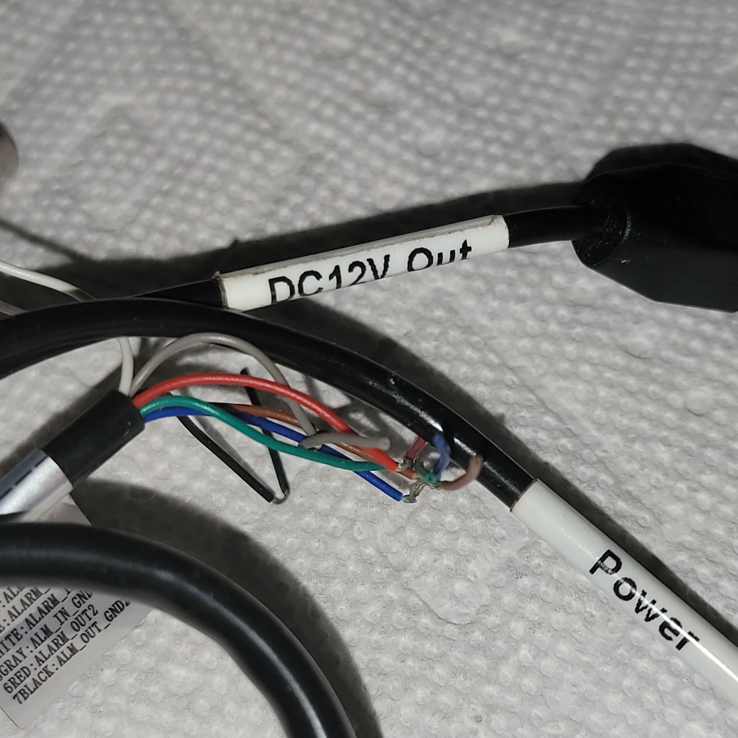

That is interesting. Just probed one of my back up cameras that has 12v out (kind of noisy) also only shows 11.11v on output when I used for mic. Anyway that camera has a 5v output at the DC jack when connected to my POE nvr port.

Yeah. Well I don't know really. I have another POE from Hikvision I just plugged into Port 8 of the NVR and tested that one it was 9v. My guess is that the first one I tested has a 5v as the last area. Most of the cameras I own have 1+v, 3.3, 5, and 12v. I find it really odd this Hikvision is 9v lol. That isn't a normal V within a Ip camera. However it could be a 12v that is coming through and that is the Voltage drop.
