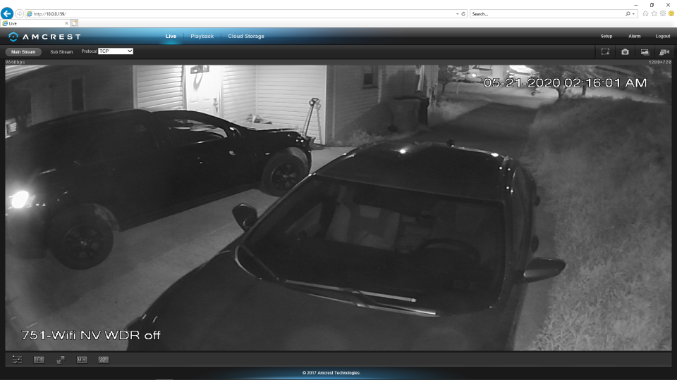

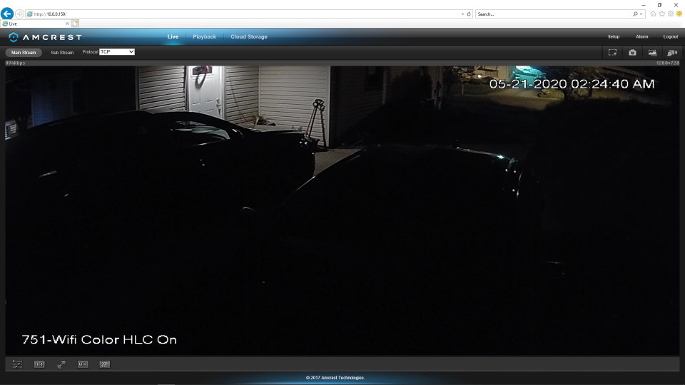

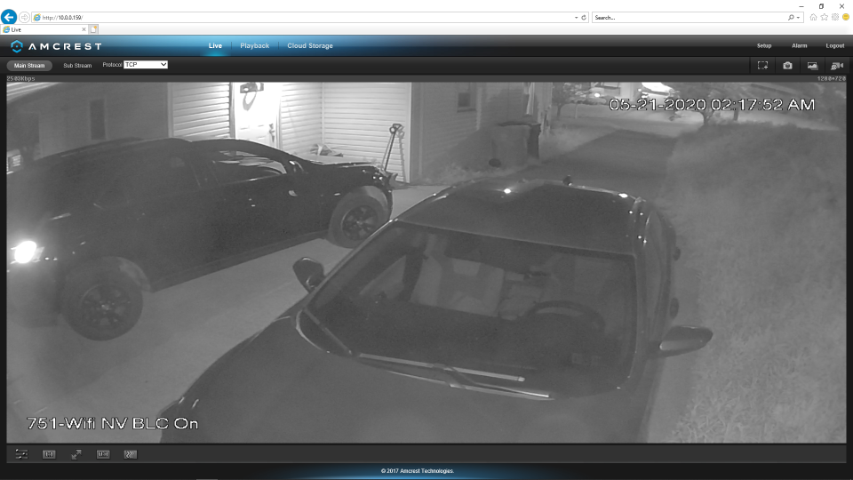

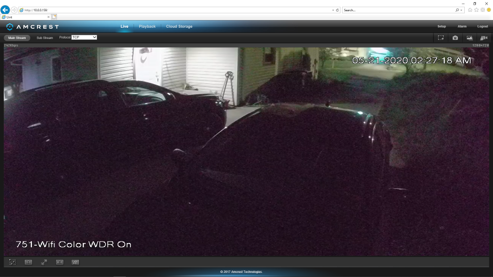

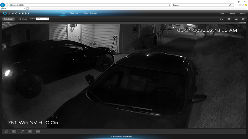

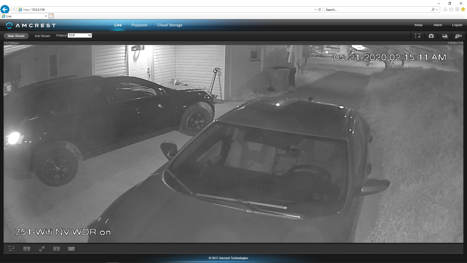

I would say try a few different things on a camera that is say facing area with light and you want to use your camera in color mode HLC can help Also in Night Vision with Smart IR on and even with it all the way up using Manual Settings..
I know this camera isn't anywhere close to your Ultra MP camera but is one that I have the ability to show some different settings... Also in your Settings there is the ability to set a day and night profile if want or need WDR at day time and you choose to use HLC at night...
So I only changed the Image size to try and keep space low as most of them was over 1.6meg and the last one is still over 500KB but reduced only size all other is pure image no doctor outside of the Camera it self... I renamed them in the camera each setting is Pic name.. NV is Night Vision

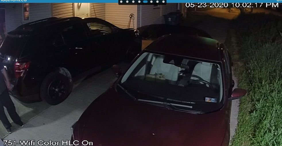

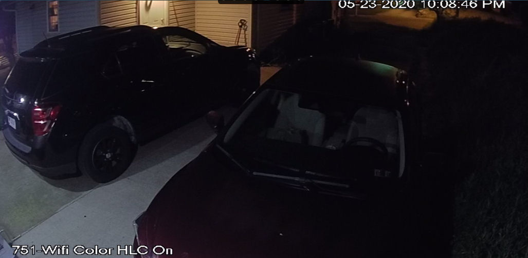

So here is my Take.. I run this camera full time in HLC day and night in Color.. I have a light that is not on right now when there is motion. That light is setup to run a full 10 min so things will get captured when needed..
I have a 10w LED light that runs on 12v that is connected to my PIR and when the normal lights come on that turns on and makes for more then enough light on the driver side of the car.. With WDR in the last picture. With it on and that light comes on it is like the back porch overly bright so I use HLC full time...
So when the PIR gets motion I have 3 12watt led bulbs that face the ground in the drive on the right I have a 10Watt Spot light.. The light on the back porch is a 9watt led bulb
Edit: Also sorry there are other cameras in the area and you can see one if not 2 of them in the Reflection in the car with NV on because I have them in another area with IR on.. I have 2 that are in Color but sadly the IR comes on anyway because they are only on and off with light not by menu or there would only be 2 cameras IR's on the Driveway however now there is 4.. I keep telling myself I am going to remove them but I keep them in there to use as heaters because it does get cold here in the Winter...
Edit-Edit lol... Sorry I just remember another thought... When you make your changes you will want to have someone go check them because with Low light Night Blurr can happen because of Exposure times needed to process a Scene

HLC is pretty dark and I prefer color over IR, I LOVE WDR/Color modes, it is a HUGE upgrade for me. There is quite a bit of lighting in the area and when the sky is overcast, the light reflects back and I have a good range of about 300+ feet. But, like you, I have an area, I would like to boost with some type of 12v low what lighting that is near a truck. Where did you get your lighting from and do you think it was a good investment?
I think what you are calling low light night blur is the hazy image that is bothering me. While I can clearly see someone walking, I can make out a general description, but there is a blur to movement and a hazy look.
This is a small crop from a front view, which is fine for me....
Front: This is a small crop from the rear view, which is what I want to increase the lighting a bit.
Rear: Since I am in an apartment, I don't want to put other peoples cars/lives on the internet. Respectfully.
Mind you, those images are at 4AM. Pretty light with the WDR.

You mentioned the IR image was hazy, but lack of illumination would normally result in a darker picture rather than a hazy one, so I suspect some of the cameras IR illumination is bouncing off something you dont see in the picture and creating a "veiling luminance" that severely lowers your contrast (making it look soft and hazy).
You may have to reposition the camera to avoid the reflection, or treat the reflective surface with something less reflective like matte black paint, felt, or Cinefoil.

I have tried BLC, HLC and WDR. WDR gives me a good overall color night view.
With HLC, I do not get the lighting, it just gets read dark.
WDR gives a good general view, but I tried play back of people walking a dog and it was as bad as my Foscam jpeg camera quality. I believe you referred to it as "Low light Night Blurr". Sort of a ghosting affect. I tried to add a video to this, but it is not allowed. Bummer.
Do you have any suggestions, I don't want to capture the ghost of someone up to no good?
The picture is great, if nothing moves,,,,
