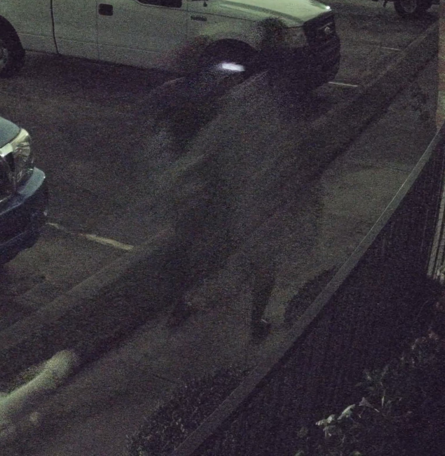

This is a crop of two people walking a small dog at 5AM. Exported from Amcrest Surveillance Pro software.
Is this the quality image to expect from these IP8M-2597EW-4MM?
Quite Disappointing... It's no better than the Foscam FI8905 it replaced.
I SURE HOPE this can be improved!
Please help...

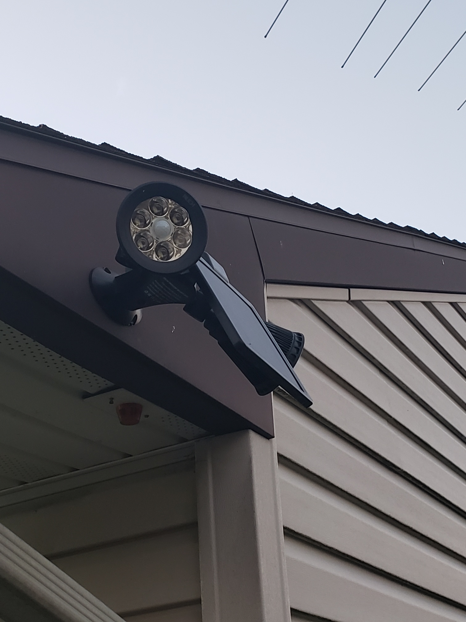

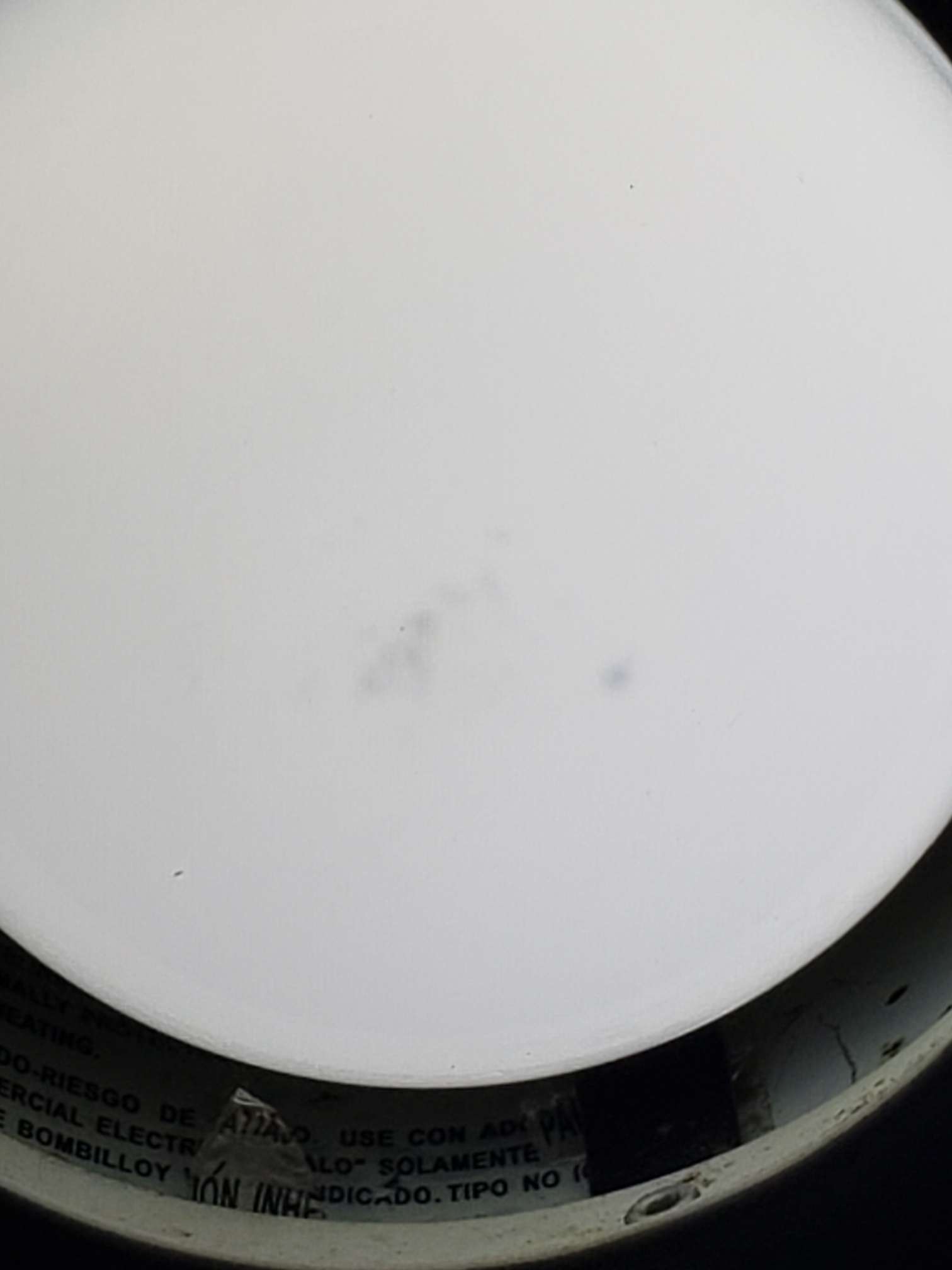

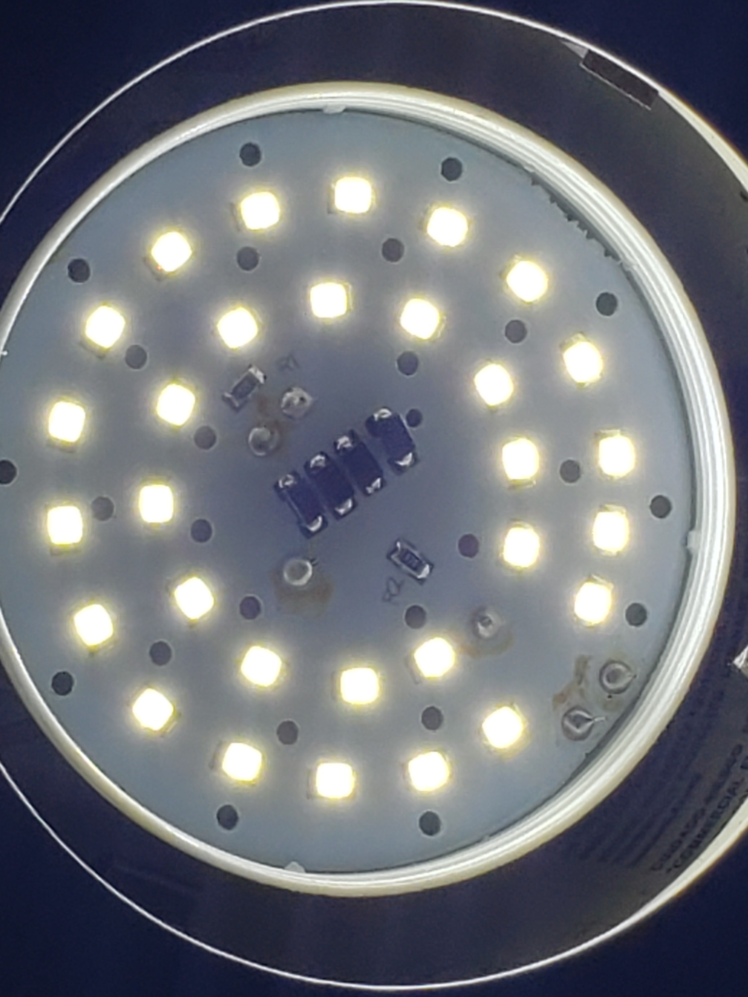

Anyway I took some pictures of my Can Lights I have installed.. The LEDS that are in the bulb are placed this way for best light for my use... The LEDs that was in there didn't put out enough light so I took the junk they had in there bulb made my own and used the little bulb housing.. I have it setup on paper as being a 12w but when I tested it I might have to large of a Resistor behind the plate because it was only using 9w and the power factor was not so good but testing this light with a 9w GE led mine was much brighter.. With the way things are going today I would just look into buying a LED like GE or some other UL listed brand the prices are going down and the quality and life of them are going up. plus they are Sealed and can't access them like I can mine. I don't expect anyone other then myself to use my LEDs..
The outdoor light you can see the motion sensor it is on both sides and at first when I bought the light I was really only buying it for the outdoor housing to make my own LED light in it but again liked this setup so much I have not taking it apart to setup my own in it as of yet... As soon as it dies I will put my own LEDS in the system and might turn it over to 12v rather then solar..
Solar Motion light with 2 led array and there own Motion sensor in each light My 12w LED that is un-covered The Led with Cover in place yes sadly this was taken before I cleaned out the bugs.. There are large holes on the back of the bulb to help cool led lights..

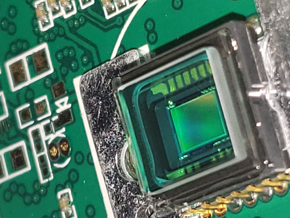

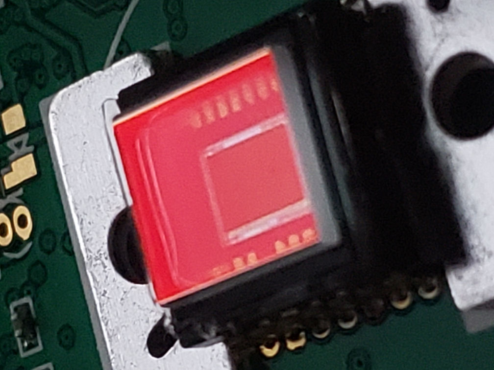

So I thought i would show what a Camera without a IRC looks like that can run at night in B/W... This is the CCD from my 2005 27x zoom camera from my PTZ dome.. Sadly I can fix a lot of things but when it comes to cameras CCD sensors going out I am not sure where to buy one so I just replaced the module and took this one apart for my brain Education lol... Anyway this PTZ is older didn't have built in IR and wasn't as costly as some of my other PTZ domes that have better hardware in them...
So camera had this lens infront of the CCD... This unit used software inside the hardware to work the B/W and as such the lens would detect IR at night and because of the coating and software it had good color at day time... I took a picture of this lens to show the Green color and the pink color. If you get a camera at some point that the color at day times makes trees look pink that is because the IRC is not working and has not removed the night time lens from the sensor and it is running the camera in color with the IRC over the sensor.. Repair can be made to replace the filter... That is because that camera with real irc isn't setup by software to work with that filter in place...
These pictures were taken a while ago I resized them to something better then the 2mb that they were.. Anyway I thought it might better explain what I was talking about when you asked about IR light working in a COLOR camera.. now there are some cameras out there that can work in Total Darkness and with IR and software can make some light that the camera can detect but the ones I have had was a Faint green color in that mode...
