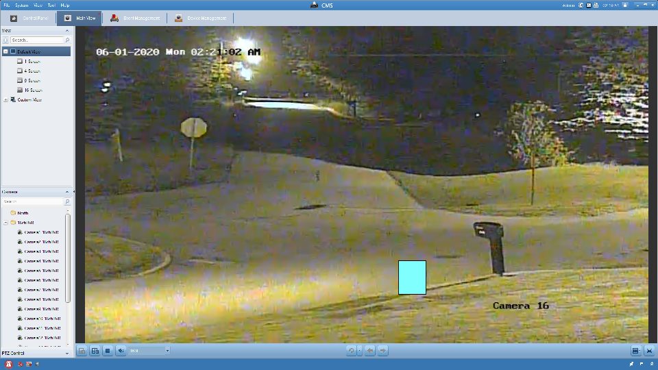

That video, clearly shows exactly what I am dealing with AND I have much more light from porch light, street lights, outdoor lights.
Image 1: Image 2: I have plenty of "white light" and have tried settings all the way down to 1080P and 15FPS. While the lower resolution settings improved the image of people walking, significantly, it is still not enough for a satisfactory image. Still images or pausing is still very blurry.
Why doesn't Infrared Light help enhance color images as it does B&W?
There is no way I can afford $2000 cameras. I don't believe my expectations of a $150 camera is too high, it absolutely should produce a usable image to identify a moving person, in close proximity (4MM Lens) with the amount of light shown in the pictures above. I am on 10 Feet from the camera when testing.
Why does ANYONE need a "surveillance camera" that produces blurry ghost like figures? How is that helpful?
I am not looking for studio quality images at night, but, it must at minimum help identify whom is captured in the video. Isn't that, everyone's expectation? Ugggg...
Thanks for you help...

Sadly the Pictures of Still look beautiful...
So issue with Ghosting.. Looking at that image I am going to guess that the biggest issue sadly is there is to much back light... So what that is doing is making the camera work harder at the images...
Sorry you asked what FPS was and I failed to answer... FPS is Frames Per Second... So if your system is set to 15 FPS then your camera is taking 15 frames every second to make 1 picture... So then there is some other things that can happen as well but let me get back to that...
Question!? Have you tried to remove Sub 1 and or 2 if you have them enabled?
If your running at 1080p you would think that your camera should be able to do at least 30fps? Then below that keep the iFrames at 60 or double what ever your FPS is should change that way Auto...
That Picture and settings have your tried just changing it to B/W at that point and see if the Ghosting has gone?
Crazy thing is you have 10000000% better images at night then I do that is for sure... Everything is clear...
I would try B/W with IR off and then test some... Then i would try to add smart IR and then Manual IR at 25% need to fill in some of that light in the back of your image aka by the other side walk to give image a chance to get faces and no blur?
I know it is hard to keep trying this as it is a PITA...

HiYa James, I stumbled onto something, you might understand way better then me.
First off, I agree, the still scenic images these cameras create are awesome. I have no complaints there. It is just the movement of people.
I was just screwing around changing the settings for 1 camera. I changed it to HLC at 100%. Just to see...
It made the picture very dark, but when I tested movement, there was much less ghosting.
Then I moved gamma to 100%, sharpness to 100% and Brightness to 55% and the resulting image is an acceptable low light color capture. There is room for improvement and tweaking the settings down, but at least I know it will work for two of the cameras at 8MP, 30FPS.
Yeah, progress....
The other area, needs a white light solution. I have a patio light I will try and work with.
As for Cat5 and Cat6 cables, I bought 4 60' cables from Amcrest and they were not all the same size length, several inches difference. I still have them, but replaced them with Cat6 PoE from Amazon. The image stayed consistent with both, I used the Amcrest cables the first 3 weeks and then changed.
Does the bit rate matter? I have it set to highest.
I am going to leave these settings as they are for a day or so, then review things.
Thanks!!!!
