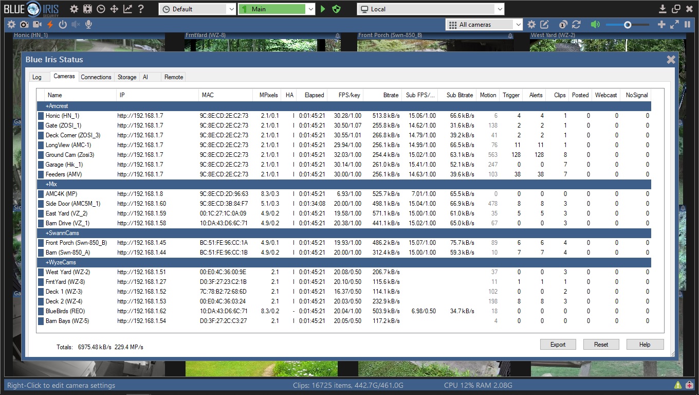

The Status window will show the trigger, motion and alert activity among a variety of other valuable items. Multiple selection tabs navigate to other areas of interest for their status as well.

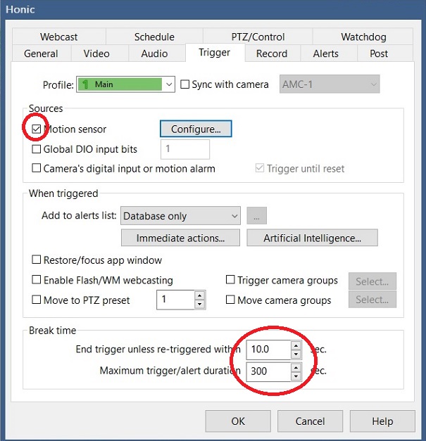

Basic motion activation with basic trigger parameters. The re-trigger setting of 'within 10 seconds' allows for additional triggering of the same event or a series of shorter events totaling a maximum event(s) duration 300 seconds / 5 minutes for that particular series of triggers, then starts over if the activity is ongoing. I find it a good general setting as a clips-based user. It also ties into my storage settings which provide for 15 minute clip segments which can actually span a significant period of time depending the number of triggers and amount of activity involved. Easy to quickly scrub through several hours of clips in only a few minutes using the Clip Viewer in 'selected camera only' mode which singles out clips for whichever camera is selected.

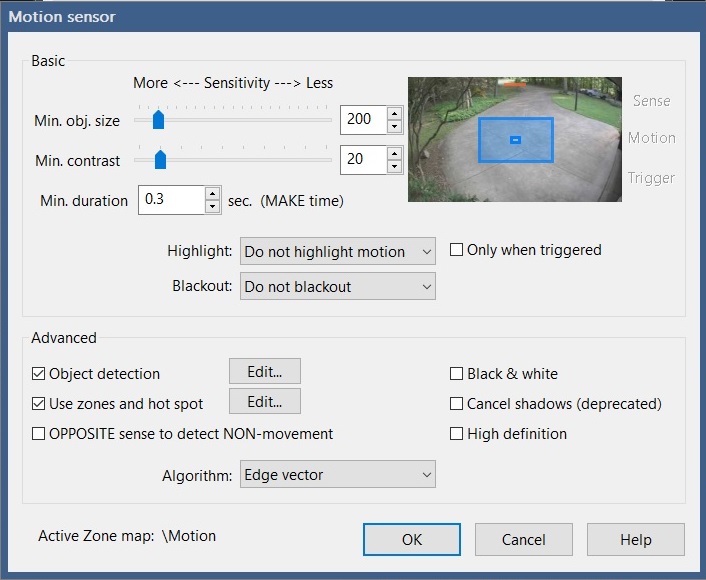

General sensor sensitivity settings for a fairly trigger happy result on the surface that is actually tempered quite a bit by the motion object detection parameters which are movement related vs. just motion alone. Zones are self-explanatory with hot spots having no rules or parameters whatsoever and anything that occurs in a hot spot causes a trigger -- sort of the "In case of Fire Break Glass" zone.
The 'Make Time' is how fast a trigger will initiate and can be set according to the type of activity anticipated (or generally encountered).
The algorithm is debated with the general consensus being Edge Vector for basic use and 'Simple' when AI aspects are more prevalent in the setup..., or maybe it's the other way around, or it doesn't matter? I stick with the Edge Vector default and it seems to work fine for my purposes. I've tried Simple and detected no difference.

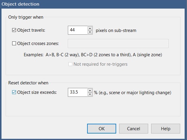

Tuning basic motion detection settings by establishing object qualifiers is helpful in reducing random triggering from bugs and other such annoyances. It obviously works alongside the other settings and requires a fair amount of trial and error for any given application until you have a feel for it. It's not a must for every situation, but can provide a bit more finesse to the power of the sub-stream pixels in determining the effectiveness of the other settings involved. Understanding the sub-stream resolution and the associated pixel size relative to the image is essential to taking advantage of this feature.

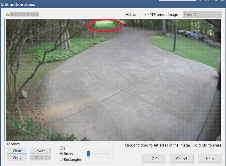

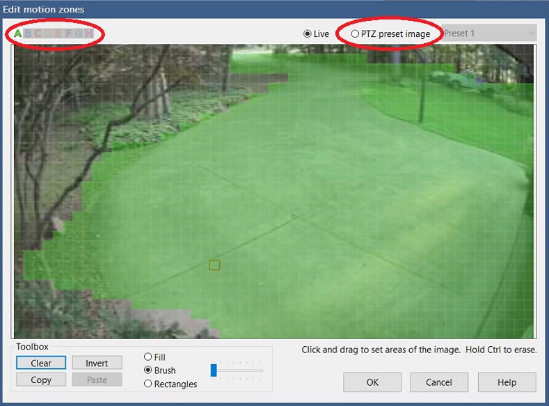

These are simple zone examples using my main driveway. Zone A is the default active zone for all cameras. Additional zones B through G can be added in a variety of combinations for any number of actions with object zone crossings as triggers being one of the most common. Zone A is self-explanatory with respect to the most common settings and general motion setups. Zone H is a Hot Spot zone that does not use any rules or settings and simply provides a trigger for virtually anything that occurs within the zone -- basically an "In Case of Emergency, Break Glass" solution for very few situations (and I believe I'm repeating myself).
The blanket Zone A setup for my driveway is generally based on the settings in the previous examples and is pretty effective at just grabbing vehicle and larger object traffic without too many nuisance triggers during the day but can also detect a chipmunk running across the drive out around 30 feet from the camera. The same settings are susceptible to a certain amount of annoyance triggers at night due to the high contrast settings being used to more accurately detect night time wildlife. The Object detection settings in the previous post help reduce triggers from bugs and other airborne stuff and can even handle a fair amount of web activity without generating a trigger. Took awhile to zero in, but it's working pretty well for the purpose with no dedicated AI support involved. This camera is only for recording clips. No alerts involved.
The next example is a clone entry for the same camera, again using Zone A. Cloning creates another virtual camera from the streams of the original camera with almost zero additional overhead put on the CPU. A very handy way to easily create 'on the fly' zone and trigger setups and very useful for performance comparisons of different settings applied to the same camera simultaneously in a testing or lab environment. Pretty cool. The following example is the result of just being lazy instead of figuring out how to do it effectively on the main camera along with the main blanket A zone. Sounds like it should be easy, right? Not exactly. LOL I bailed and went the easy route to basically set a very small A zone at the drive entrance to trigger an alert via SMS to my phone which is subsequently supported by the clip settings I have for the main camera to record any subsequent activity. Very, very few false alerts with this particular setup -- basically a 'poor man's trip wire. Klunky and could still use a tweak or two, but works well.
{attachment=0]Zones B.jpg[/attachment]

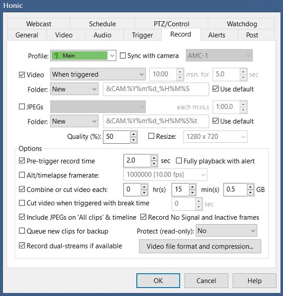

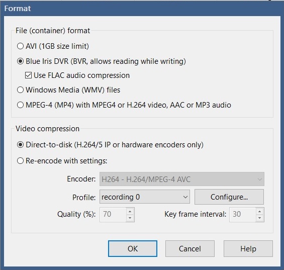

I'll close this out with my basic clip recording settings. When triggered, recording starts with the 'New' folder as the destination. A 2 second pre-trigger record buffer works fine for my general purposes. The Combine or Cut settings are very short and small compared to the defaults. This accommodates the Break Time trigger settings shown in the first post which effectively provide 5 minute clips of single or combined events that are then saved as 15 minute shorts with the 500MB file size being set way too high on purpose knowing it will never be reached. Using the 'Selected Clip Only' feature in the clip list / viewer to list only the selected camera's clips for review is an extremely efficient method for scrubbing through a day's worth of clips quickly and identifying areas of interest to be further investigate via the time line.
The remaining settings are the defaults with the exception of the 'Video file format and compression' setting which defaults to 'encoding' when Direct to Disk does exactly what it sounds like it does and saves the encoding for the export process resulting in a huge benefit for CPU efficiency. Direct to disk is what you want.
