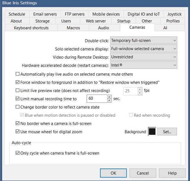

Lastly and probably most importantly, and in concunction with Direct to Disk, is selecting the appropriate GPU as the default for all camera configurations. This is done in the main BI settings panel under Cameras and is then automatically applied to each new camera configuration. Straight up Intel is what you want. This will establish Quick Sync GPU hardware acceleration resulting in an additional reduction in CPU load -- by a lot. I run 20 cameras on an i7 4790 at an average of 12% ~ 15% utilization. Your big gun processor won't even know it's plugged in. LOL

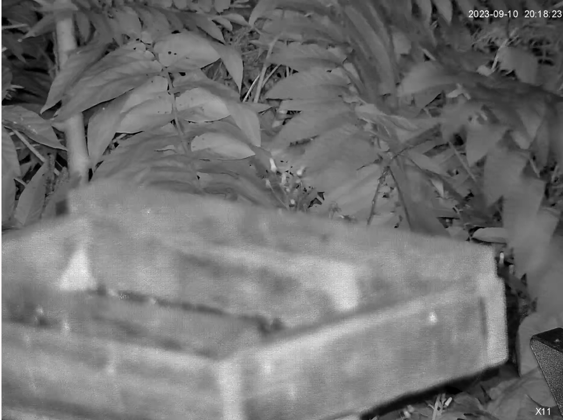

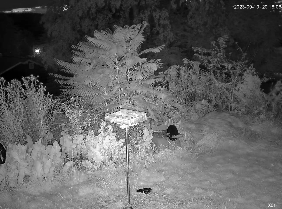

You don't happen to know how to setup rules In Bi that I can set different zoom or focus on a camera. I have a camera that at night requires a different focus point then in the Color Day time? I am not sure if you have done this with any of your PTZ cameras or not? normally my cameras are able to focus without an issue. However my Second Hikvision NVR blew up and so I had my Son pack my cameras and NVR from the NW and I right now have my 4216E-AI NVR and 8 AI cameras there in the place. So one of my newer Hikvision PTZ cameras don't focus well in the night time. I was able to setup in my NVR the ability to focus the PTZ different for day/night. I think you mentioned this to me at some point a while ago. Or maybe someone did when I was working with my 4mp Hikvision Mini PTZ until I found it had a better close focal point. While my 5mp 20x zoom PTZ has the option it only offers 1 setting for it at 2m. It is longer distance to the area of interest and the issue is that it focuses on item behind area I want it to focus on.
Here are 2 pictures of the area. One is at 1x and the other is at 11x. In the 11x you can see the focus is behind the feeder and would like to have focus at the feeder.

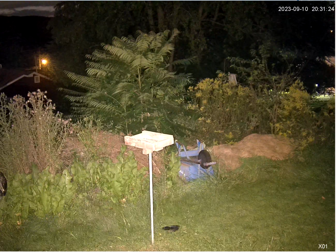

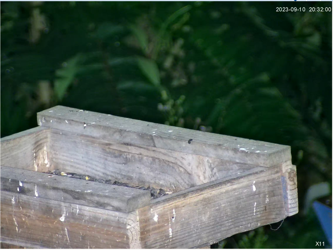

However it is a color at night camera as well as IR at night. It works well with the White Lights and zoom/Focus is at the right point in color. Only issue is this cameras White LEDS are very bright at night and would rather just use the IR until trigger when it turns the white lights on and color.

You should be able to set up a preset for each condition and simply schedule each one accordingly (like you probably did with the NVR). You could also change a preset using a stationary camera action as a trigger.
Pogo
Posts: 396
Re: How to test that Bi is detecting Motion or IVS events
Post by Pogo »
Repositioning the camera slightly at X11 may also assist the desired focal point in IR only mode.

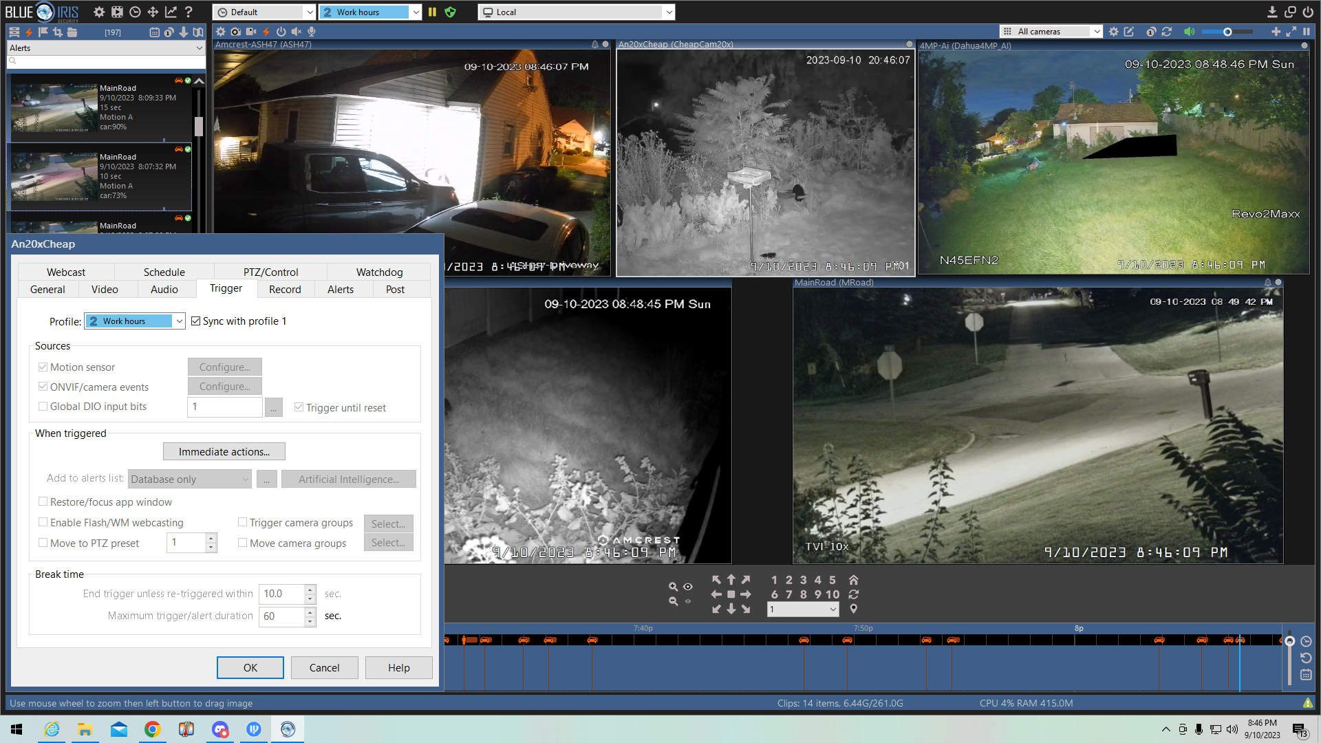

Ok I mean understand how to add Presets per setting. However there is something about ONVIFER or something where I can setup a preset and focus point. Using that program to get the data for the preset and add it to Bi?
Not just looking at setup a Preset Schedule to go to a set preset from the camera but use data of a preset to keep it predefined in Bi?
Or is this not a thing?
