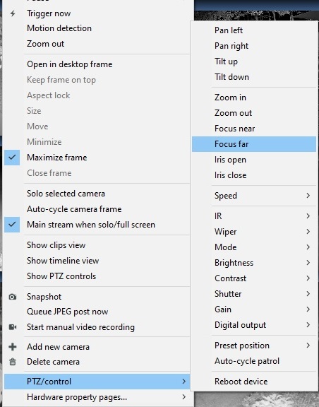

Have you tried using these controls to set and store presets in BI for the camera? I know there are a couple of ways to do it, but the effective success is dependent on the camera response -- if it will.
Preset Controls.jpg (69.87 KiB) Viewed 14400 times

Well I will figure it out and when I do I will post the info for others that might need to setup something of the same. Funny thing is my 2mp while it is a zoom camera that is Hikvision on my Amcrest DVR. Oddly Bi don't zoom it in or out the DVR will but the Bi don't understand it has the ability I guess. Also the PTZ camera while it works with all the Presets and zoom in or pan/tilt the menu you showed in your last post with Focus far or near don't seem to work with the camera I have to use the WebUI for the camera. Sadly even the App don't offer focus like the Amcrest one does for my Ancrest PTZ cameras..

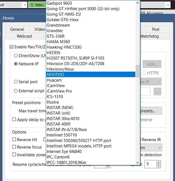

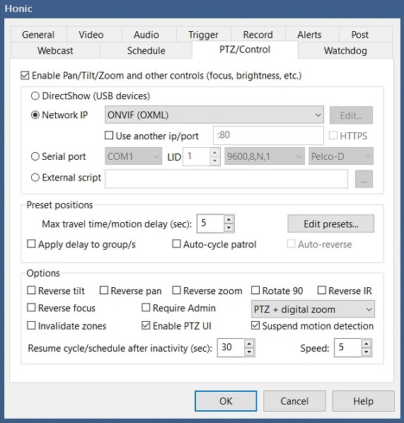

A couple other areas to look into...
PTZ Control.jpg (101.49 KiB) Viewed 14396 times
PTZ Control Vendor Base.jpg (109.63 KiB) Viewed 14396 times

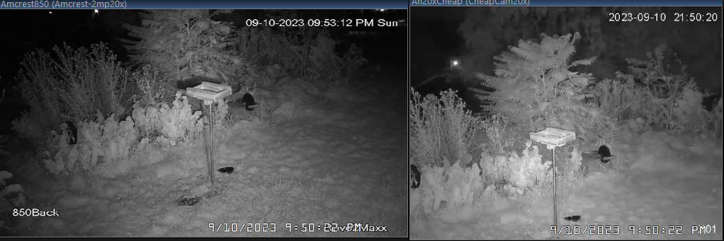

Also thought I would mention. My Amcrest 2mp 20x PTZ is better quality then my Hikvision 5mp 20x zoom. Just thought I would say seeing both are in the same area looking at the same feeder. I just have 1 at a different preset then the other under normal day use.. Night time for now seems I will have to just use full zoomed out until I figure the Bi thing out lol..
Screenshot (115).png (310.93 KiB) Viewed 14395 times

I ran the commands on my Amcrest/Dahua cameras this command don't work on the Ip2mp=850EB or my ash47 anyway the result for one of my Zoom cameras was the info below. Now so I am clear. In the Bi under PTZ/Control you will want to setup for Custom HTTP. Also there will be some need for setting the right time for your cameras in Bi and making sure that your setup in Bi reflects when you want to set day and nigh with the 0 and 1 URL below for VideoMode CGI command. This is going to be changing your Normal or Full time running Day within your camera settings so you might want to make the changes within the camera as well just to make sure the camera is changing the right time for IR and day time on the camera.

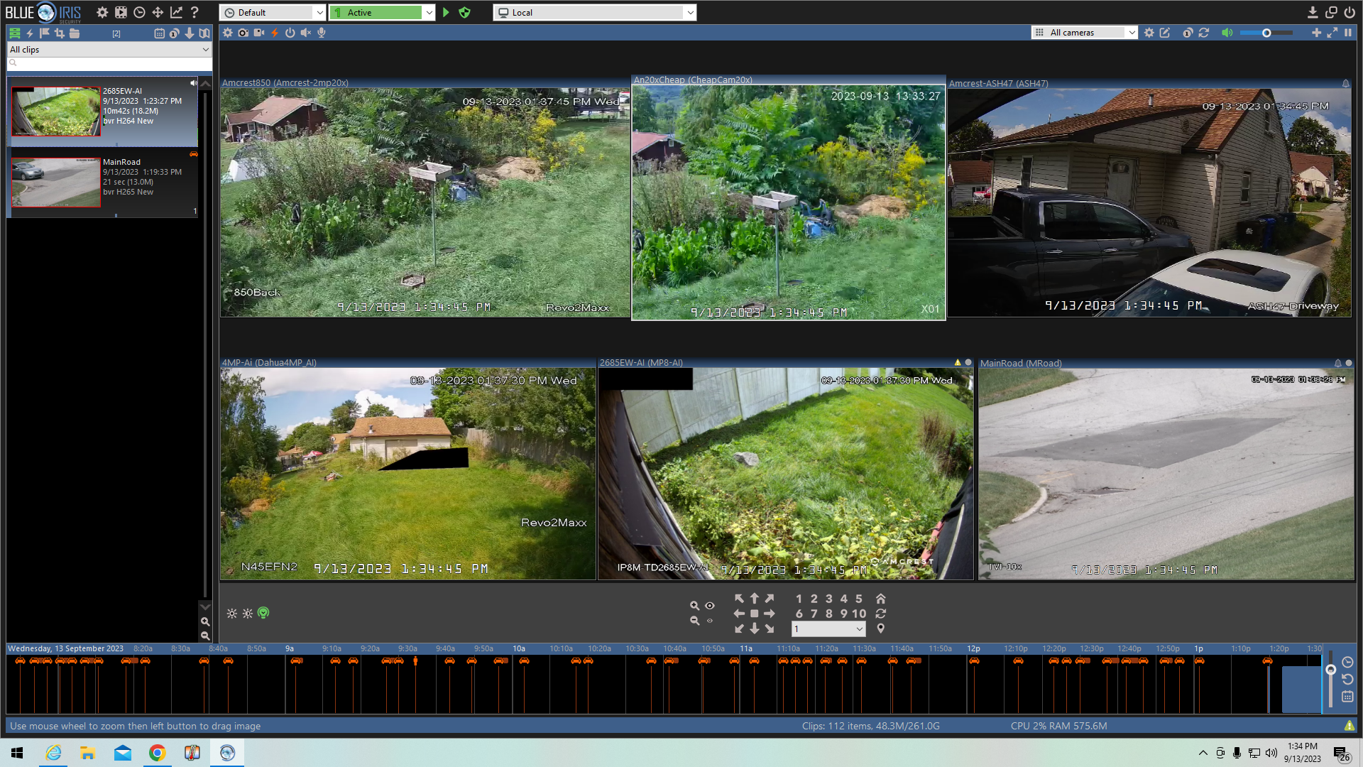

So wondering if there is a way to I can get the time line below to clear out. I thought after i cleared all the images from the left. THe 2 there now are new after I removed the rest. I thought the trigger info below the screen would also be cleared out. You know of a way to clear that while clearing all the data from the left.
Screenshot (124).png (2.1 MiB) Viewed 14375 times

Toggle the clips and timeline on or off using their respective icons at the upper left.
Overlays are an entire subject. They will be present when viewing clips for obvious reasons whether recorded or not. They aren't necessarily included when encoding/exporting final files unless selected to be in various configuration locations including the camera itself.
Pogo
Posts: 396
Re: How to test that Bi is detecting Motion or IVS events
Post by Pogo »
As possible points of interest for enhanced clip viewng flexibility, the calender icon does what you would expect it to do. Click it and pick a day -- or month depending on your storage capacity.
The icon next to the calender allows for selecting a single camera to occupy the entire clip column with 24hrs. of its particular clips for very convenient and rapid cruising. Just click the camera view in the desktop display window and then click the 'selected camera only' icon to activate the feature. Repeat for other cameras. Toggle it off when finished and the clips window (column) will again be populated with 'all clips'..., or whatever category of clips is selected from the drop down menu available at the top of the clips window.
The main playback (clip viewer) window also offers considerable flexibility once familiarized with its features. Everything at once to a single camera to whatever is selected from the groups feature.
Then there's the customization of the desktop window display itself if desired to be used for general live monitoring or to conveniently view or sequence different groups or cameras.
There's a lot going on. Getting the hang of it doesn't happen without some effort put into the learning curve.
