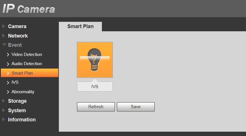

The NVR is NV5216E-8P, camera connected to the NVR's poe port directly.
Works fine, motion works, IVS (tripwire and intrusion) works,

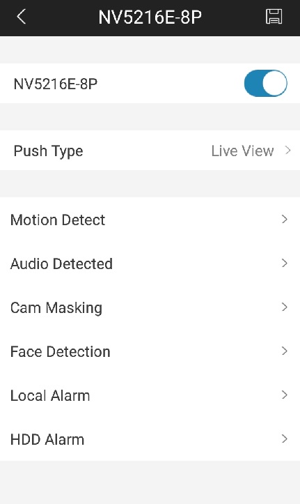

on the android phone app, in the push notification setting list, I can see a push for motion detected, a push for face recognition, but nothing for the two basic IVS.
My camera doesn't support face recognition (also I want vehicles to trigger IVS too) so that face recognition push isn't useful for me.
Any type of work around can somewhat substitute IVS push? (could probably go with email but I would then have to setup email immediate push upon new message etc...) Just wanna check if the software developer team can add an IVS option to the Push Notification type list.
Preferably an IVS option under this list:
Thanks
Can I have push notification only for IVS trigger, and NOT general motion?

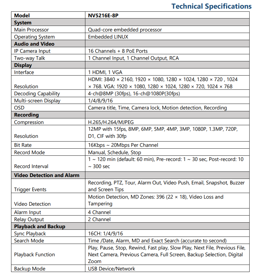

Just looked on the NVR pages and 5216E-8p don't show IVS as a feature of that NVR.

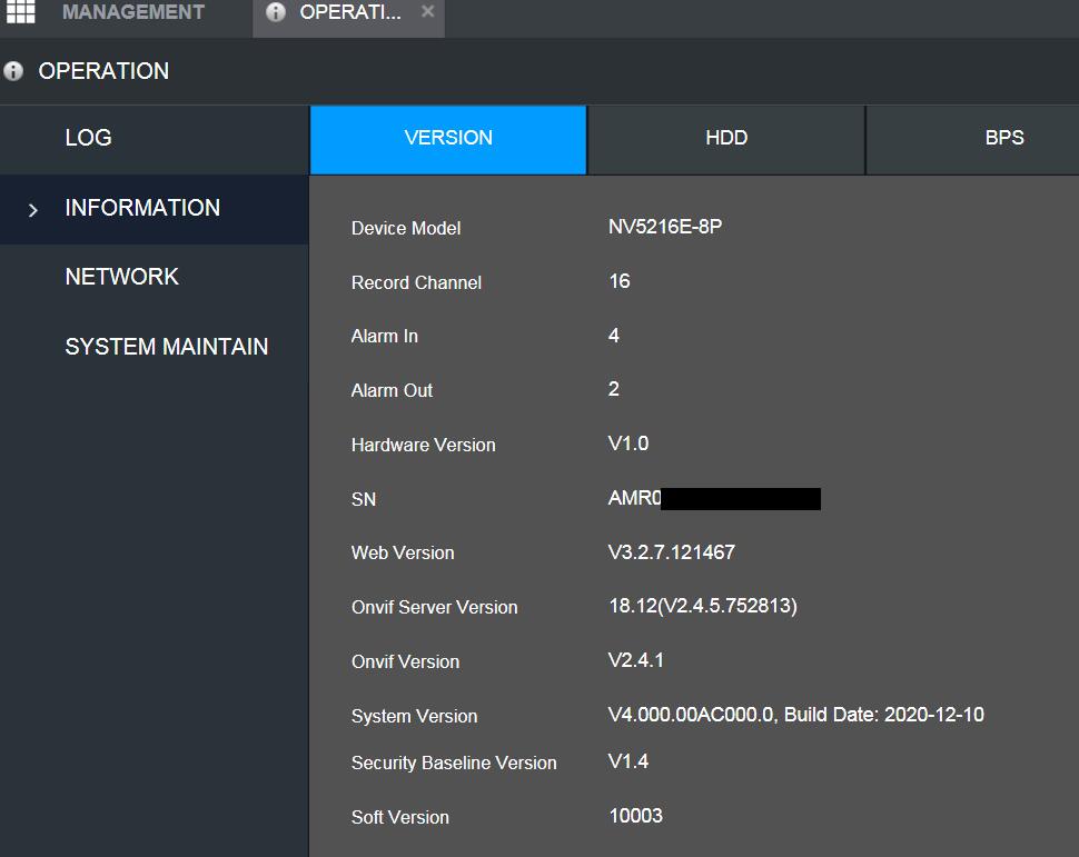

Here is the Stats for that NVR you can see under record and motion types there is no mention of IVS. Maybe you were lucky and got one that someone opened to work with IVS. Might be hard to get Support for it if there is an issue in the future.
Re: Can I have push notification only for IVS trigger, and NOT general motion?
I just checked the info page again, and it is a NV5216E-8P.
I think it's the same NV5216 machine (52 series, 16 channel), but this one has 8 POE ports.
From memory amcrest doesn't offer a 16P version while they do have 5208 (8 channel), and non-poe versions of both nv5208 and 5216.
Maybe a 5232-16P?

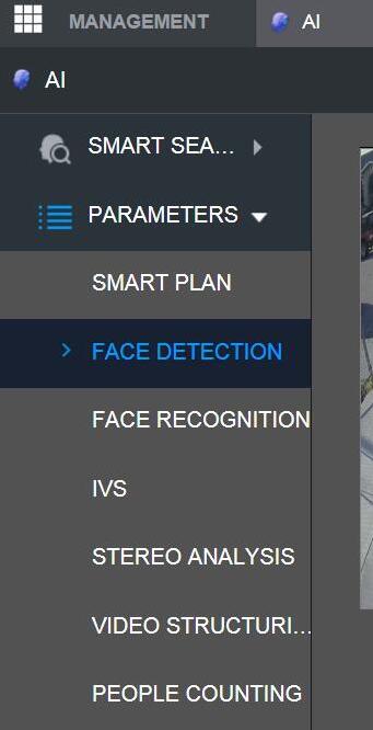

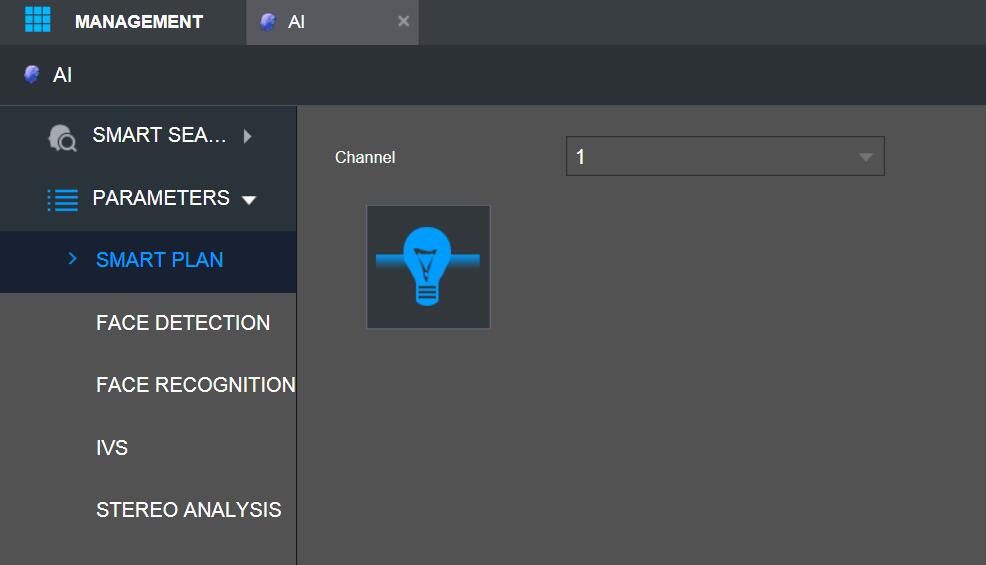

For the AI, I tried a few setups to realize that if any one of the cameras has any sort of AI enabled, the AI option will show up on the NVR's screen.
If none of the cameras supports AI (or AI supported but not enabled), the AI option won't show up.

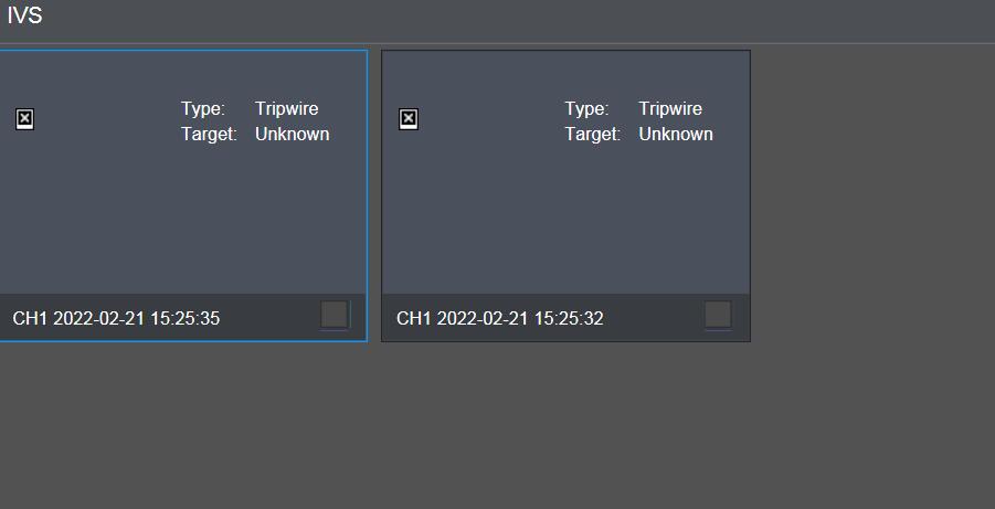

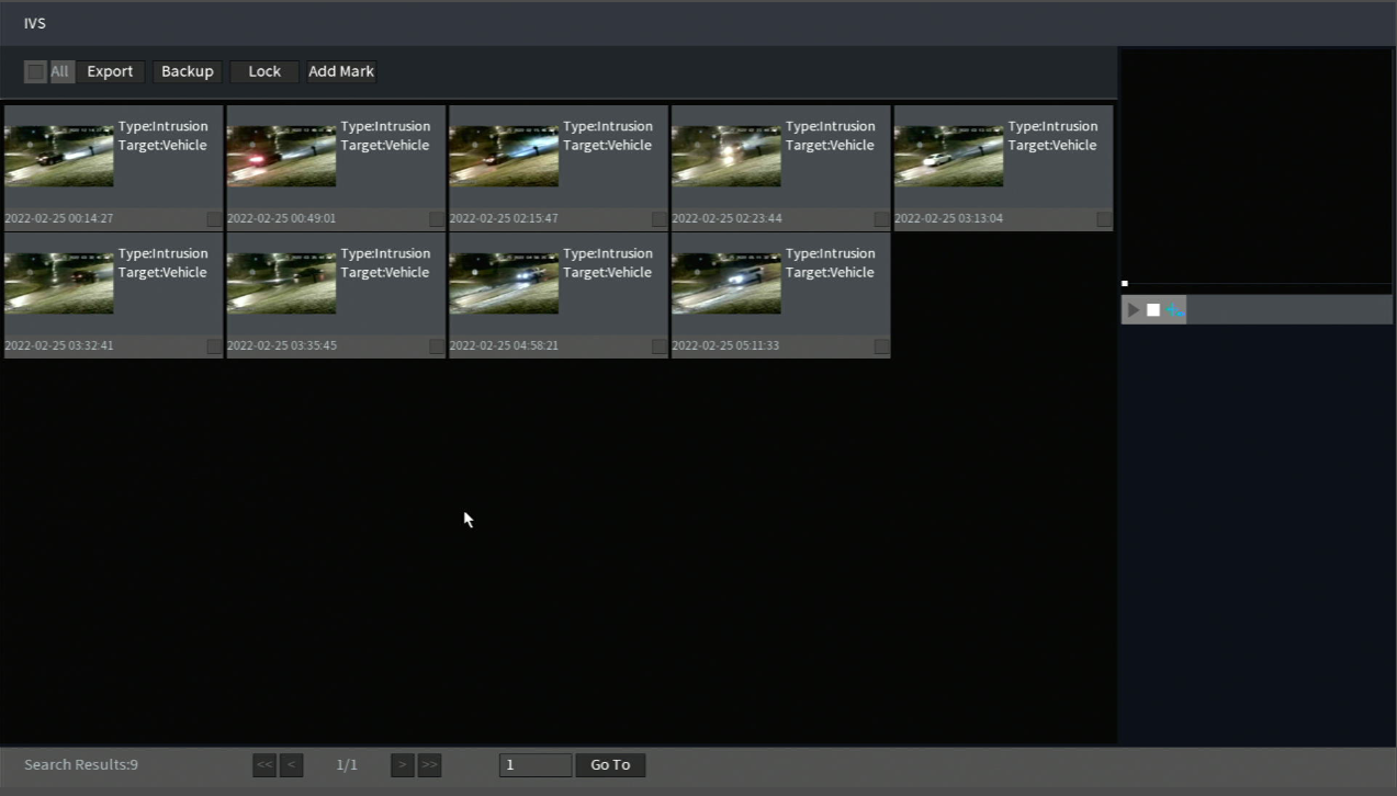

Model# of the NVR: I enabled the IVS on one of the cameras so the AI option shows up on the NVR's screen: In the NVR's AI section, I can search what has triggered the IVS, but the icon/preview-picture doesn't works, it just shows a broken image icon with a red cross.
Looks like AI works even though not showing a capture/preview image for each trigger. The clips play normally(if I select one and click on the triangle play button near the right hand side of the screen); maybe it's a bug that it doesn't show a preview image? Please relay to tech support for possible bug fix (not sure if any amcrest personnel here anyway

About your image not showing up oddly on my 4216E-AI NVR when I do a seach mine don't always show up either. However I will admit I have been working on the system and did just install a different FW from Amcrest and I have to admit I have not looked at that area since I did the update and Reset and yay there is pictures there now lol right now only 9 images since midnight..

Wow I just looked at the stats for that 5216E-16p and that is crazy... Now I wonder if yours offer any.. I mean looking at the datasheet for the 8p it don't even say it has AI..
On the 16p says it is also a 16mp NVR geez.. It has 10 IVS rules per channel, it will track Vehicle data. I mean my AI NVR has the drop down but never comes up with anything outside of the normal Vehicle being the target or human.. Now the Face detection and recognition if enabled does say glasses, mask, and what not maybe the other data needs a ANPR camera for the data to work.. Anyway the 16p says it will know color of auto and if there is a sign again wondering if that is with special camera.. I will have to save up and get a 52xx series to add to my collection of recorders lol... Don't have 10k floating around for the thermal system so NVR only. Right now have a 8ch DVR AI and my 4216E-AI NVR that I have had almost a year now. Have another brand 8ch AI DVR as well. Junk compared to the Amcrest hardware.

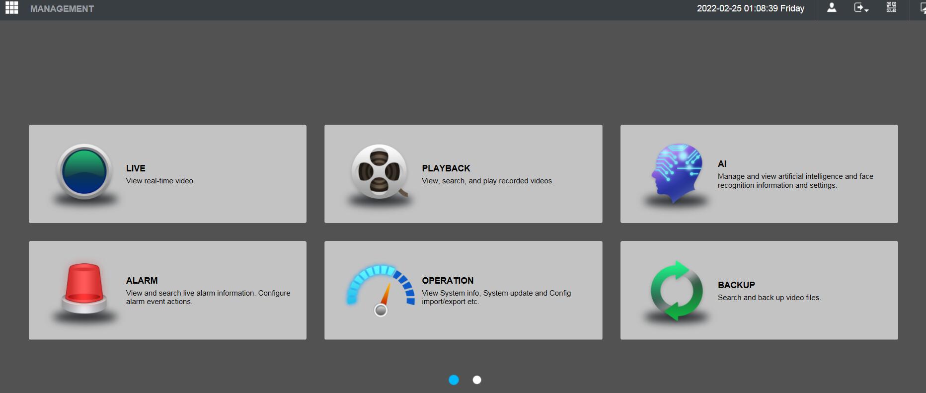

@Revo2Maxx
Not quite sure what you meant by the preview menu; I've already put the NVR up on the rack so not really convenient to check the local physical screen via HDMI/VGA. All the screenshots are on the web management page.
The NVR is able to see though the IVS settings on the camera, can probably set various settings via the NVR too but I tend to setup each camera directly on the camera's management page (the NVR has a generic page which sometimes show extra settings that the camera itself doesn't actually support).
Camera itself supports IVS (tripwire and intrusion) only: but if I visit the AI page on the NVR, it enables a full list of smart plans such as face detection: The smart plan page correctly reflects the camera's ability though: So am now wondering if the NVR is only able to passthough what the camera has done, or the NVR can also do AI stuff by itself in which case the camera just feed a video stream to the NVR, and the NVR do the AI detection (like Blue Iris can).
