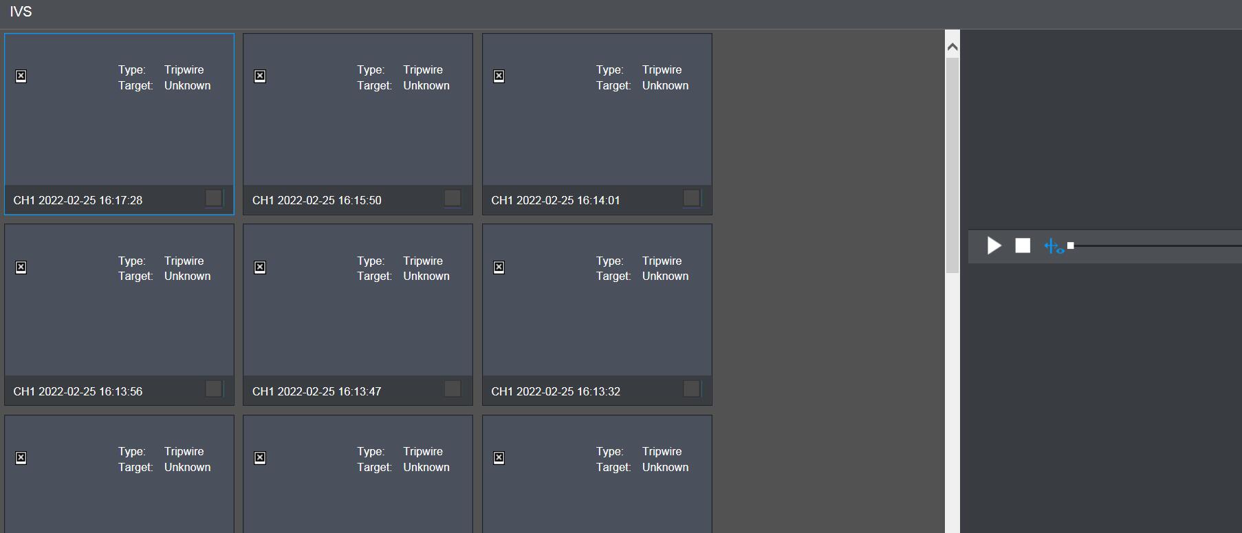

BTW, the NVR still can't show any preview image on the IVS search list:
If I select any one, and click on the triangle button, they all play fine though.

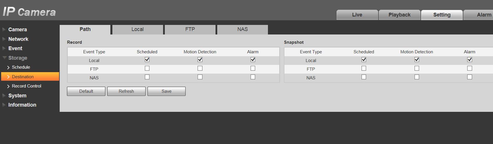

also found out a quirk, the local path on the camera needs to be enabled for the IVS to register.
There is no SD card in the camera so I thought I would just leave every thing empty;
wrong, if leave them empty, I can see objects triggering the IVS rules (blue/yellow/red line flashing) but nothing will record. :?:
Not sure why it works this way; spent hours toggling every setting just to come to this conclusion :evil:

Well about the Local on or off for working with NVR that is one of the things after 2019 FW update that was noticed when people were not getting snapshots anymore after the update. It was found out that before the 2019 FW a person could get Snapshots on NVR or DVR without having to tell the camera to setup snapshots. Then after update in software the snapshots stopped and found that the Trigger for them on the camera was a must or no snapshot in the recorder would happen even if there was no Micro SD installed it would need to be triggered and treated like there was one for them to be active.

About the NVR getting an update, I would guess they might have one to make the IVS search display right with images seeing the last FW update for my NVR corrected my issue of no image displayed. However my 4216E-AI was a AI NVR has 4ch built in AI where I can input trip wire or intrusion on 4 normal cameras. The 4116-A2 NVR is a AI NVR that works like yours only if the camera has AI will the AI option come up no Built in AI and seeing on the Spec Sheet for the 52xx besides the 5216-16p there is no IVS data offered at any level.

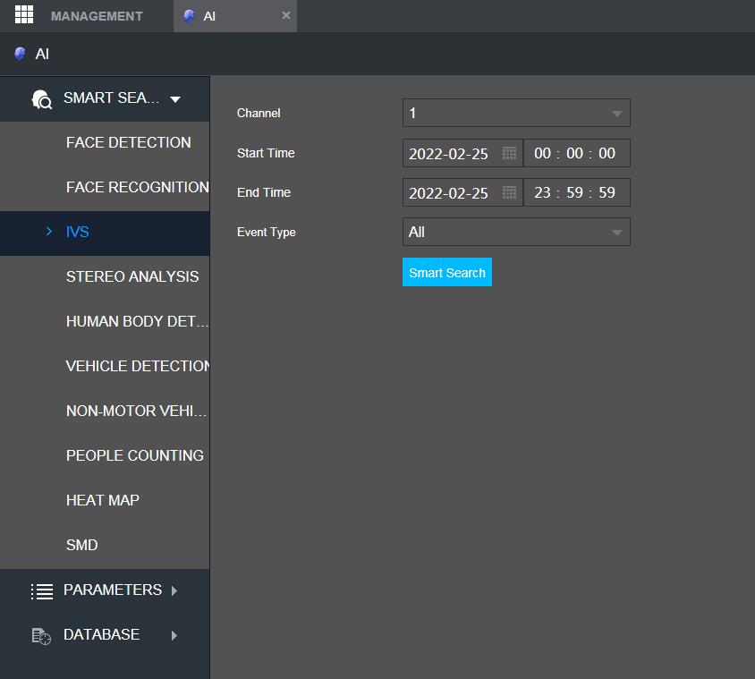

For AI search on the NVR, yes it allows a specific type of search:
Also seems like a full AI feature set:
But the camera is doing the actual work while the NVR is only a passive recorder; so I assume many of those settings (such as setting face recognition on a non-supported camera) will have no effect.

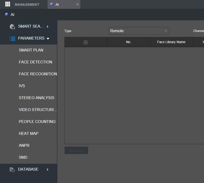

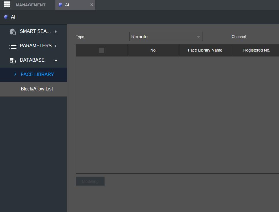

For the AI settings on the NVR, if I select a function's page (under the Parameters category) without having a supported camera connected, the NVR will pops an error message near the top saying something like no available channel, and the channel list will be empty.
If I select the IVS page, I can then select a channel to view the settings on the camera (as the camera connected supports IVS, and enabled).
Looks like all those AI settings on the NVR will work for any capable camera connected.
Those AI NVR on the other hand can do the AI on the NVR level, which doesn't require an AI capable camera.
centralized heavy loan on the NVR's CPU then, especially when more cameras added.
