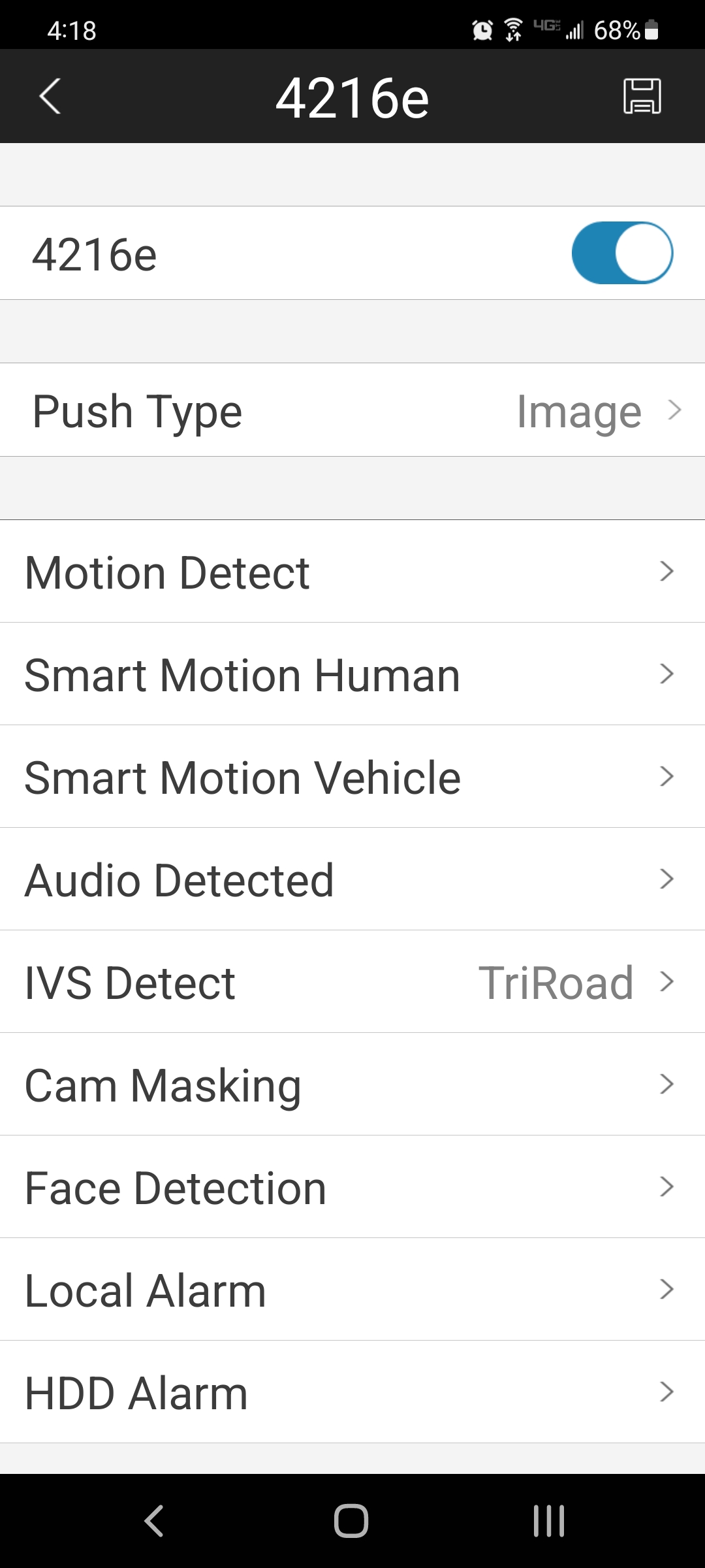

Re: Can I have push notification only for IVS trigger, and NOT general motion?
WOW AVP Does.. At least it does today.. Odd thing is I have been looking and looking on the App Store to see if it would show up to DL new Version of the APP.. I bring up app tonight and while I almost over looked the IVS I seen it say IVS I was like WOW what... I have it turned on and it is at the Witching hour and there is very little traffic right now lol SO I will have to wait to check it out BUT YAAAAaaaaa. I guess I was expecting it to look different but the app looks just like it did before the change.. SO it is still the same look and feel and I am guessing that is why they did that so people that have been used to the old look can keep going without wondering how to use this lol.. I mean I remember when the 4.0 NVR and DVR FW came out I was like Nice looks great but I am so lost over how and where things were before the update lol....

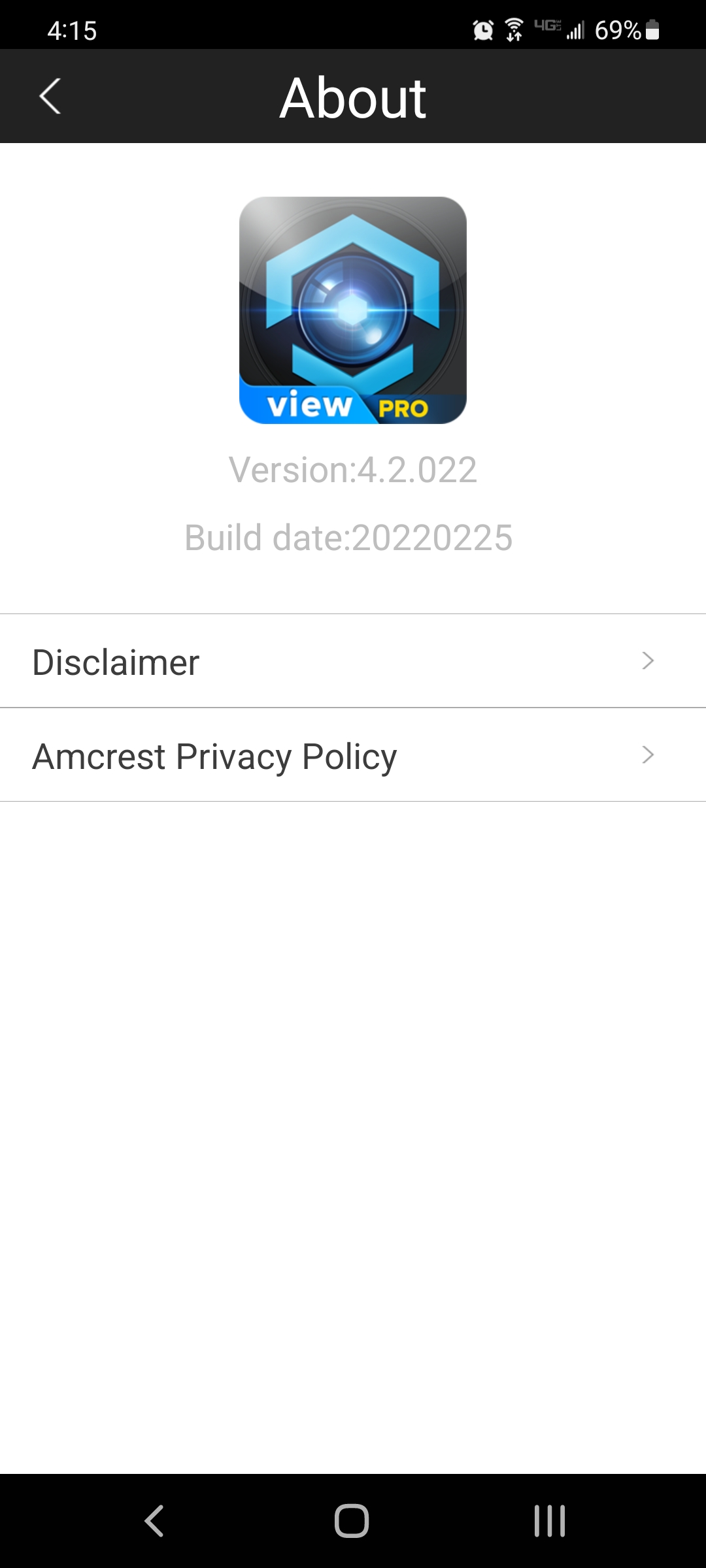

Build Date 02-25-22 and it wasn't there for DL just the other night maybe 2 days ago when I looked on the Store. I am glad I have my phone setup for auto updates.. Seamless didn't even know it had updated...
Screenshot_20220302-041521_Amcrest View Pro.jpg (176.98 KiB) Viewed 3447 times
Screenshot_20220302-041807_Amcrest View Pro.jpg (238 KiB) Viewed 3446 times

:lol: Yes IVS option now available after the update.
