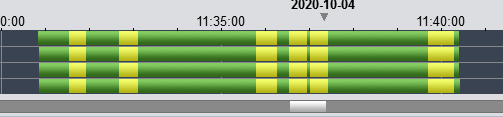

Been fighting with this for a couple days now and have no where else to go.
Using PC-NVR on a windows 10 machine. Have 7 Amcrest cameras. Whenever motion is detected on one of them, it triggers motion on all cameras making it difficult for me to find which camera actually has the motion event. I have followed every single guide I can find on how to set this up properly. I have uninstalled and reinstalled, tried on another machine, and even tried other versions of this software (Flir Cloud Client, and Smart PSS) with all the same issues.
I have a feeling it has something to do with the channel each camera is set to record on. I only get one option which is channel 1.
Any ideas?
PC-NVR issues with MD
- Motion Snip 1.PNG (8.93 KiB) Viewed 3815 times

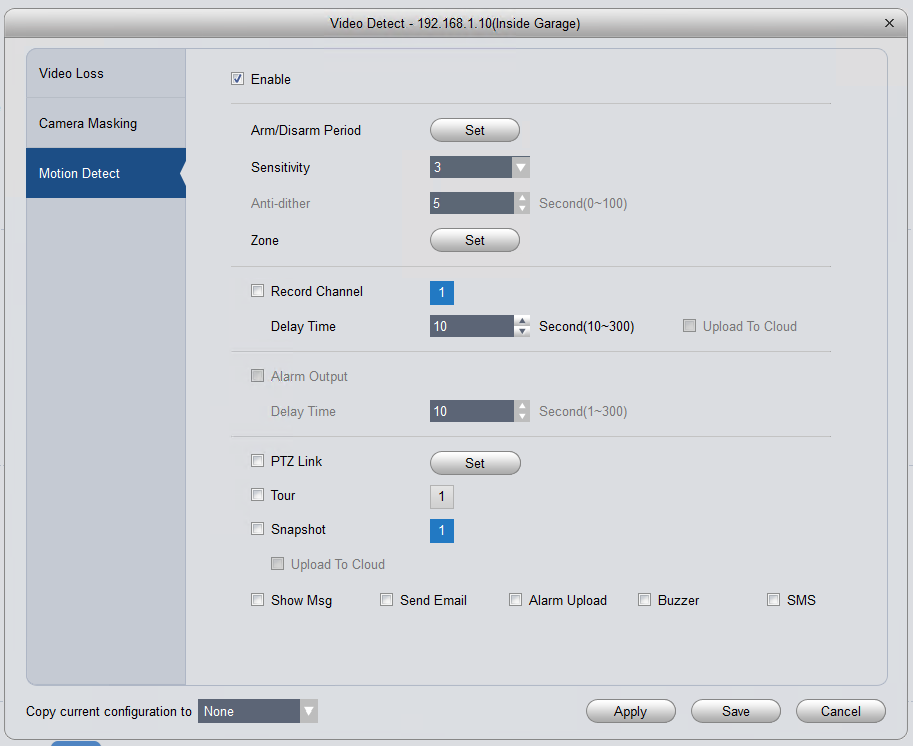

At this point I am unsure as to why I only get 1 channel to pick from. This is how all of my cameras are set up at this time:Revo2Maxx wrote: ↑Sun Oct 04, 2020 1:08 pm Hello and Welcome to the Forum
I would double check your options and make sure that it was not setup to record on all CH when motion is detected.. Right now my network is messed up so I can't look at my ASP computer ATM.. I know it is the same with all my other Amcrest Recorders and Dahua systems that I own so I am wondering if they also added it into the PC-NVR..
Motion page, There is a TICK box for Enable, then below there is options on what to do when motion is detected, then in that area is Record and boxes for 12345678 and so on.. On of the biggest mistakes is that people will check them all trying to get all channels to record at 1 point not understanding where the right record area is.. I am not saying this is what you did but either ASP and PC-NVR is setup Wack by Design or more then the normal channel has to be picked when motion is active.. Sadly I have mine set up for Full time recording as Backup to my Normal Recorded devices..
- Motion Snip 2.PNG (53.68 KiB) Viewed 3811 times

Yes I just got a New Router in place for my Main network hardware and first thing before rebooting all my computers was went to the one with PC-NVR setup and sure enough your right It looks just like that with only 1 number option for Recording when Motion is detected.. So I am going to guess that it is a Software Fluke and maybe Amcrest has it in the works for a fix or maybe already have a different one out testing.. I know I read somewhere that someone on the forum here got a Copy of a different ASP and it might have been PSS I can't remember.. Age wasn't nice to my memory...

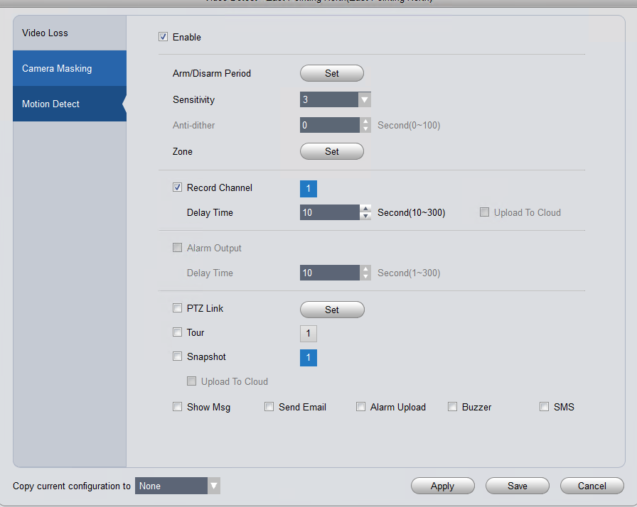

I gave this a shot and this is what I found. If I go into the web GUI for each camera and set up the motion events, ASP will then have the check box ticked and act as if I set it up via ASP. The first screen shot is what ASP changes to after I make the changes in the cameras.jack7 wrote: ↑Fri Oct 09, 2020 7:38 am Try this:
Do not set up your camera Event in ASP like in the image you posted earlier.
Instead, use the Amcrest Web UI to set up Event for each camera. Make sure you enable Motion Detection and set up Schedule and Detection Area for each camera. There will be no channel number displayed there. The Record option there is just for what is set up in the Storage section of camera settings.
PC-NVR Regular and MD recordings work for me right now. You could still have other problems. Setting up PC-NVR can be tedious and error prone.
The timelines are now showing motion on all cameras. At this point I have only one camera enabled for motion events.
- Motion Snip 4.PNG (56.85 KiB) Viewed 3769 times
- Motion Snip 3.PNG (14.52 KiB) Viewed 3769 times
