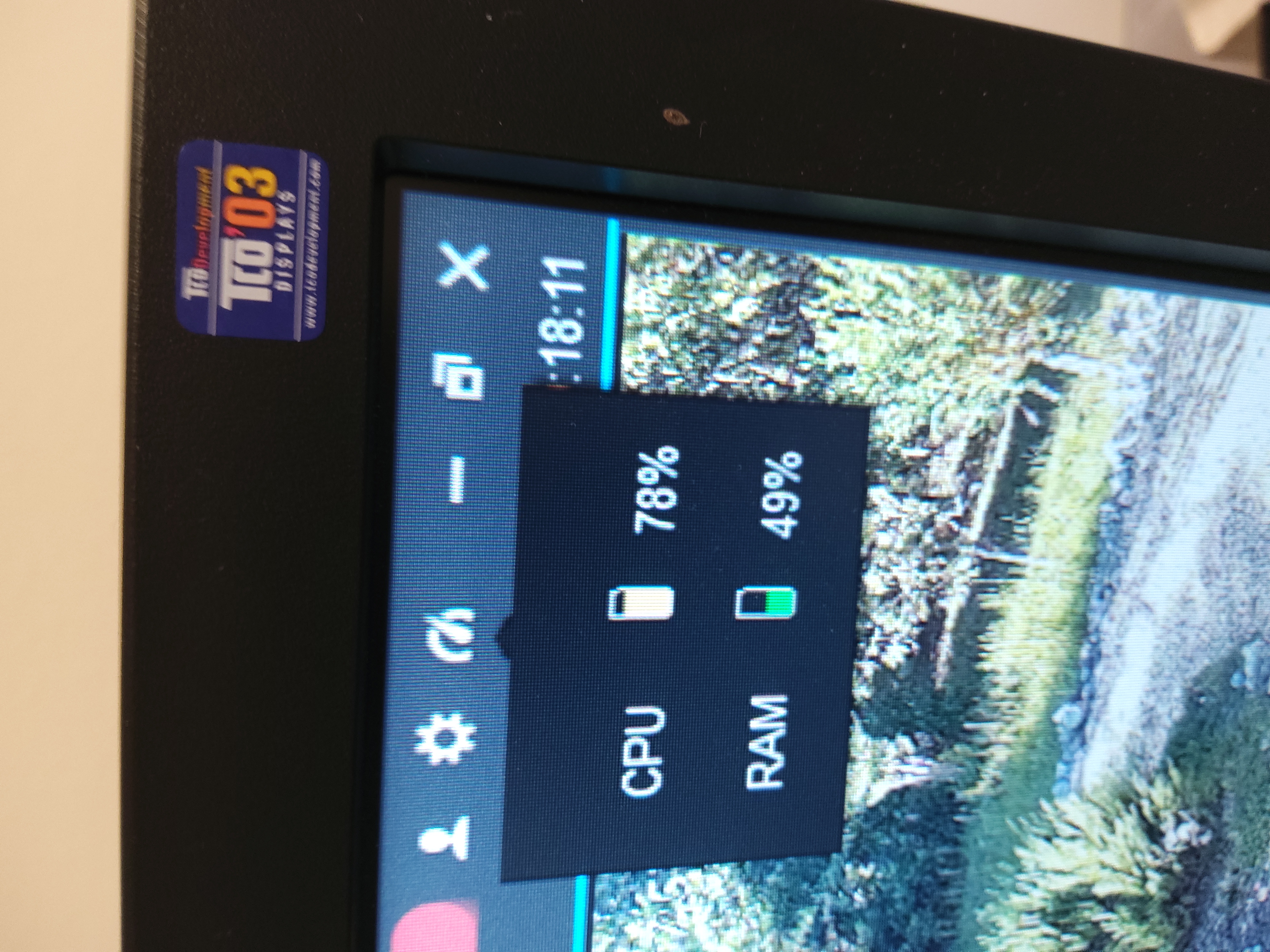

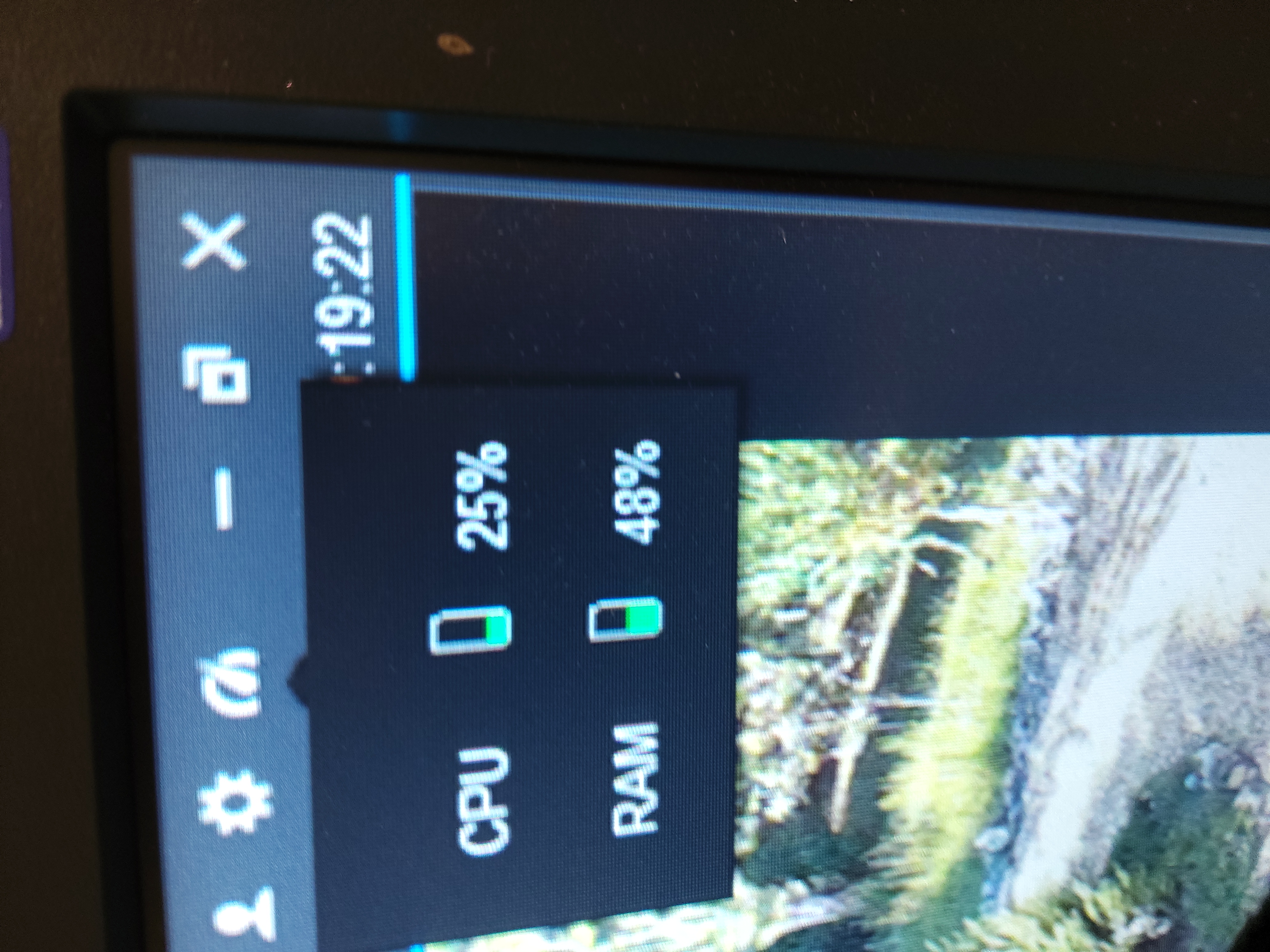

Observations regarding ASP2 CPU while viewing four 1080p cameras on my old slow PC:
VIEWS SET TO MAINSTREAM VIEWS SET TO SUBSTREAM

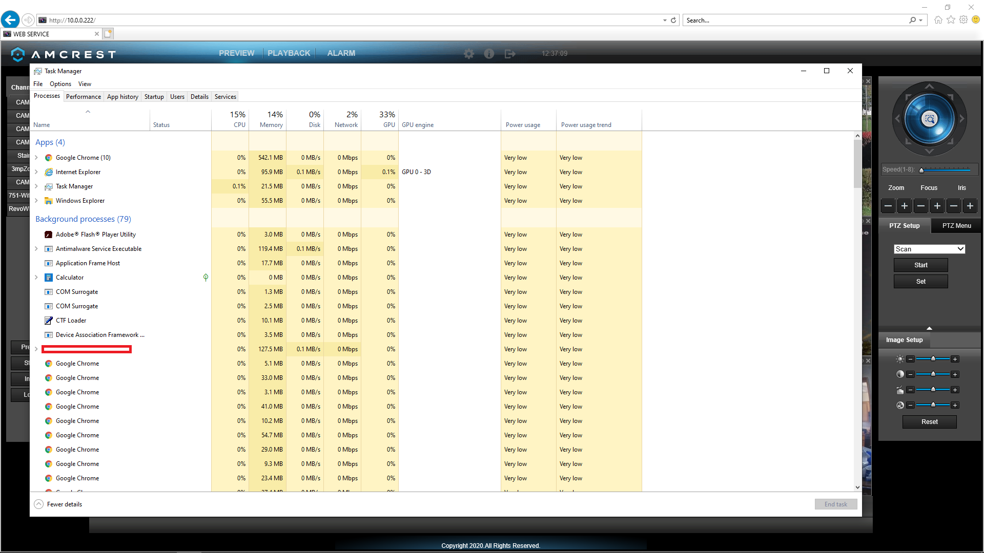

Well I am not sure how many people watch Live View at Sub or Extra settings.. That had me wondering something lol.. What is the load on IE looking at my NVR in 9CH mode with 9 cameras loaded in at Main?
I was shocked at the Results
Thanks for Posting the Real World on ASP with 4 cameras on your PC
Picture of my Screen shot of IE 9CH View 9 of my 16 cameras loaded in Main Stream My chrome being open with 10 pages loaded takes more CPU then my 1 IE with 9 Cameras loaded sure the IE needs GPU it is displaying camera footage...

On my lowly PC ASP2 with 1920x1080 monitor, I loaded the same cam twice. One set to main and other to sub with 9x16 scale. They look about the same to me in 4 view or 9 view. A sub view can be changed to main with right click if needed. In 9 view, views are loaded initially with sub by default. Are NVR cam views in IE nine view loaded sub by default?
Amcrest View Pro works fine with PC-NVR for the four cams. When View Pro starts, PC with only PC-NVR running goes up only 2% in total CPU use in task manager. Decoding done elsewhere.
I'm not sure how you concluded that
"Picture of my Screen shot of IE 9CH View 9 of my 16 cameras loaded in Main Stream My chrome being open with 10 pages loaded takes more CPU then my 1 IE with 9 Cameras loaded sure the IE needs GPU it is displaying camera footage..."
Task manager snapshot shows no CPU for any app/process listed on that page. Is it on another page?
