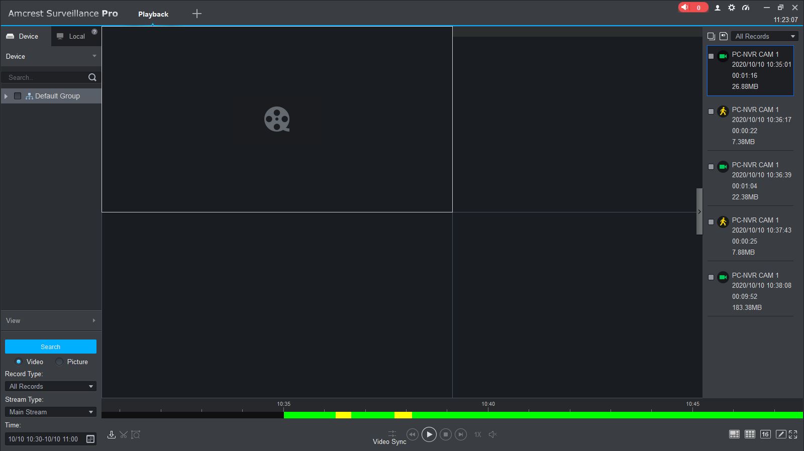

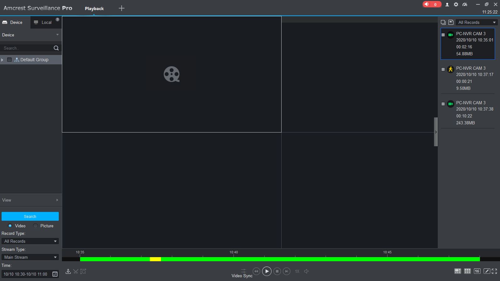

The images below are a test with ASP 2 that shows that a MD event on one camera does not cause a MD event on another camera. PC-NVR cam1 and cam3 were used.
PC-NVR Schedules are set the same for cam1 and cam3.

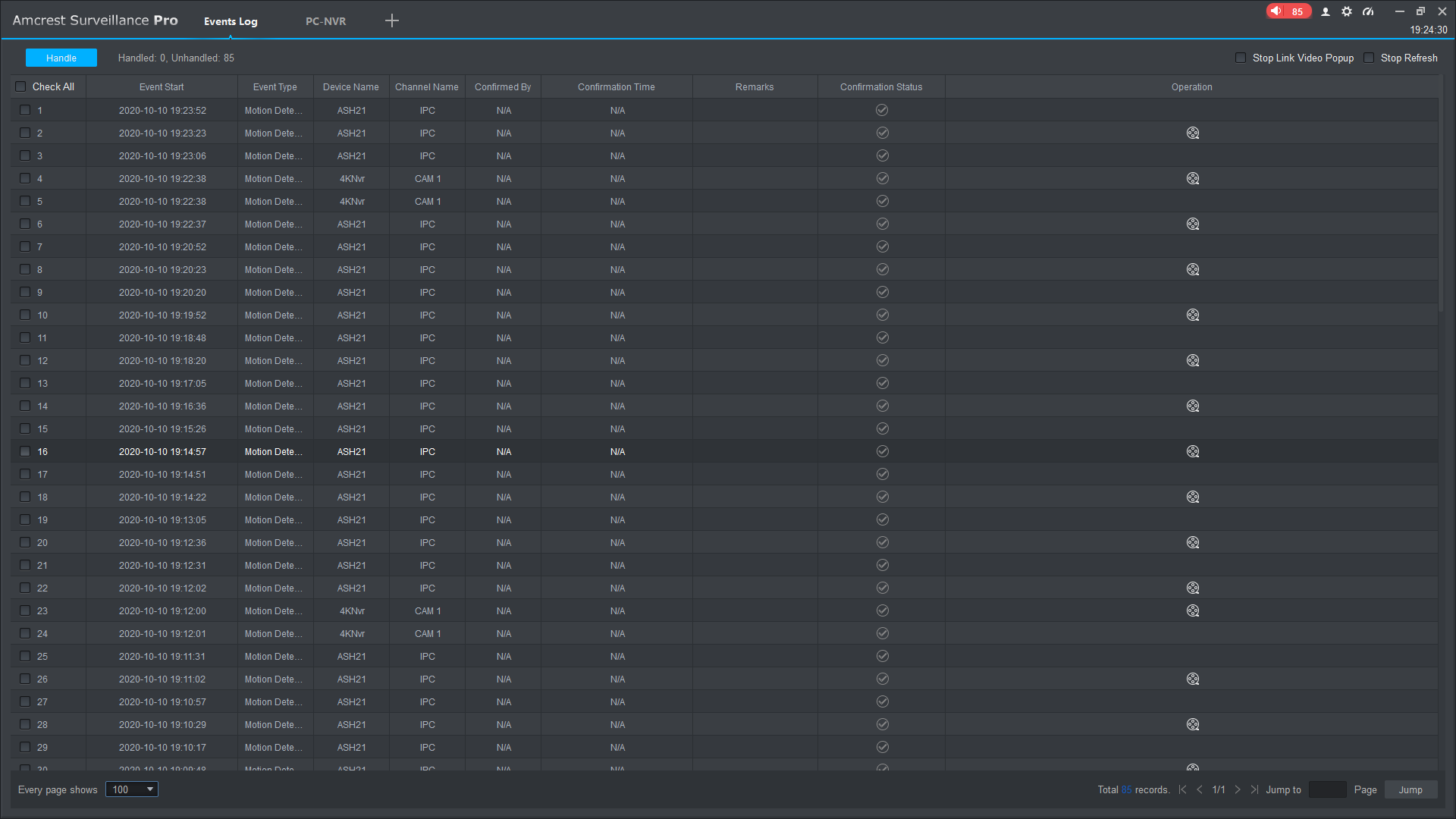

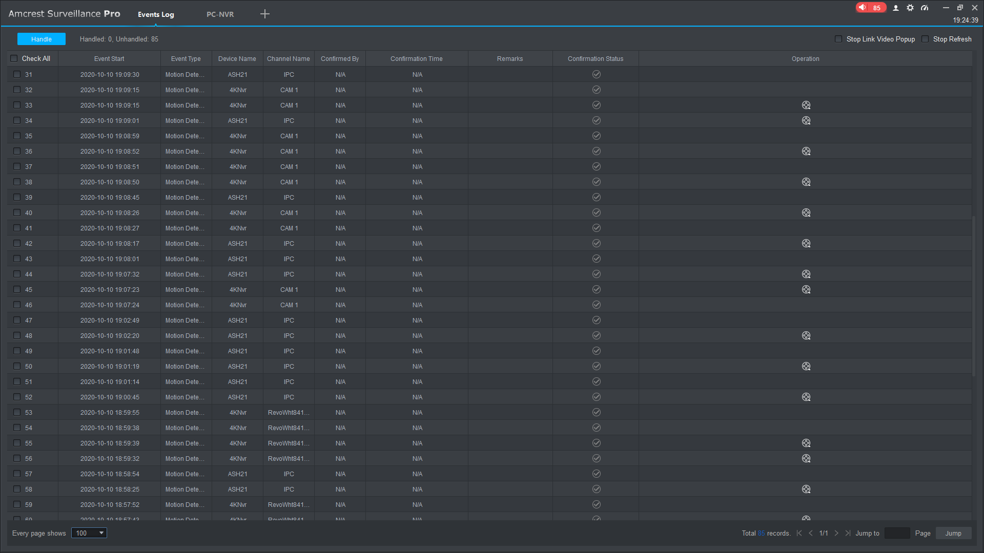

When I went to post this reply, I saw your additional post with event logs. I have not used event logs before. It would take me a good while to test and evaluate that. So I decided to just post my reply anyway.
I think PC-NVR probably doesn't work properly with a NVR. I don't have an Amcrest NVR to test. I don't see anything about channel numbers in my camera Web UI. Channel numbers are probably just used with NVRs.

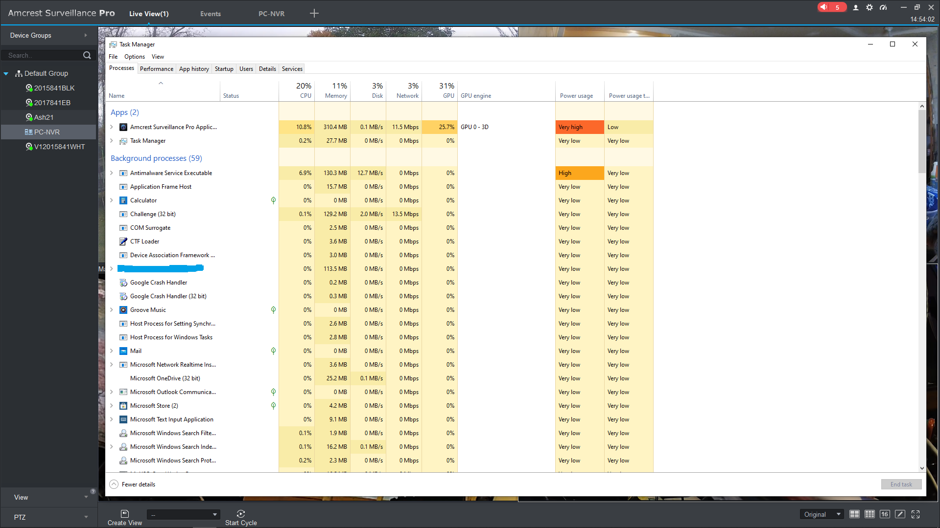

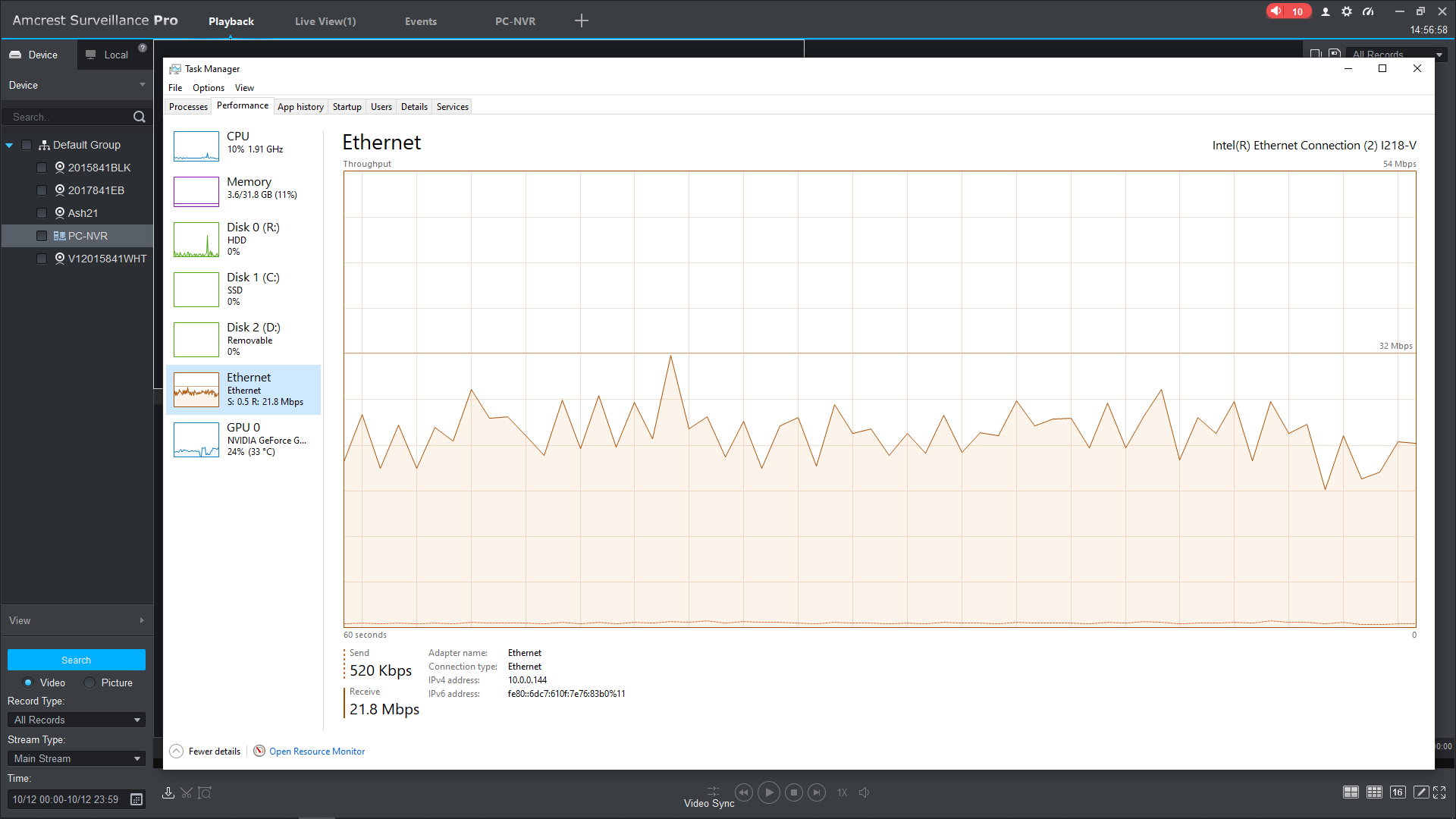

Problem as I said in my last testing I like to try and test out Real world.. Leaving the PC-NVR record take little to no CPU usage on any of my systems... It isn't until someone tries to convert that Data from 1 and 0 into real watching things.. To me this just isn't Real World...
Real world is leaving ASP run just like it was setup for a NVR and running Live view in Title setup of how ever many cameras are connected.. So in your Testing and in mine as well this last time it was 4 cameras... All of mine was 1080 besides my 1 3mp camera but really that don't matter... I setup Live View for all 4 cameras, I then setup Devices, had Playback in tab but not actively playing anything they were Stopped... I had PC-NVR loaded in Tab and I was watching the activity of the 4 Cameras on screen.. I was looking over some things as time was going to make sure that Motion was active, that things were recording
What I find odd was when had one of the Cameras setup for Full time Recording and Full time Motion Events the only thing I got out of the whole time was Yellow line for Motion events and that don't help me to track down an event... ON my NVR and DVR if I have it setup that way I get Green Full time recording, Then when Motion happens I get yellow Recording and this will play outside of Full time events if I pick the Motion only Option...

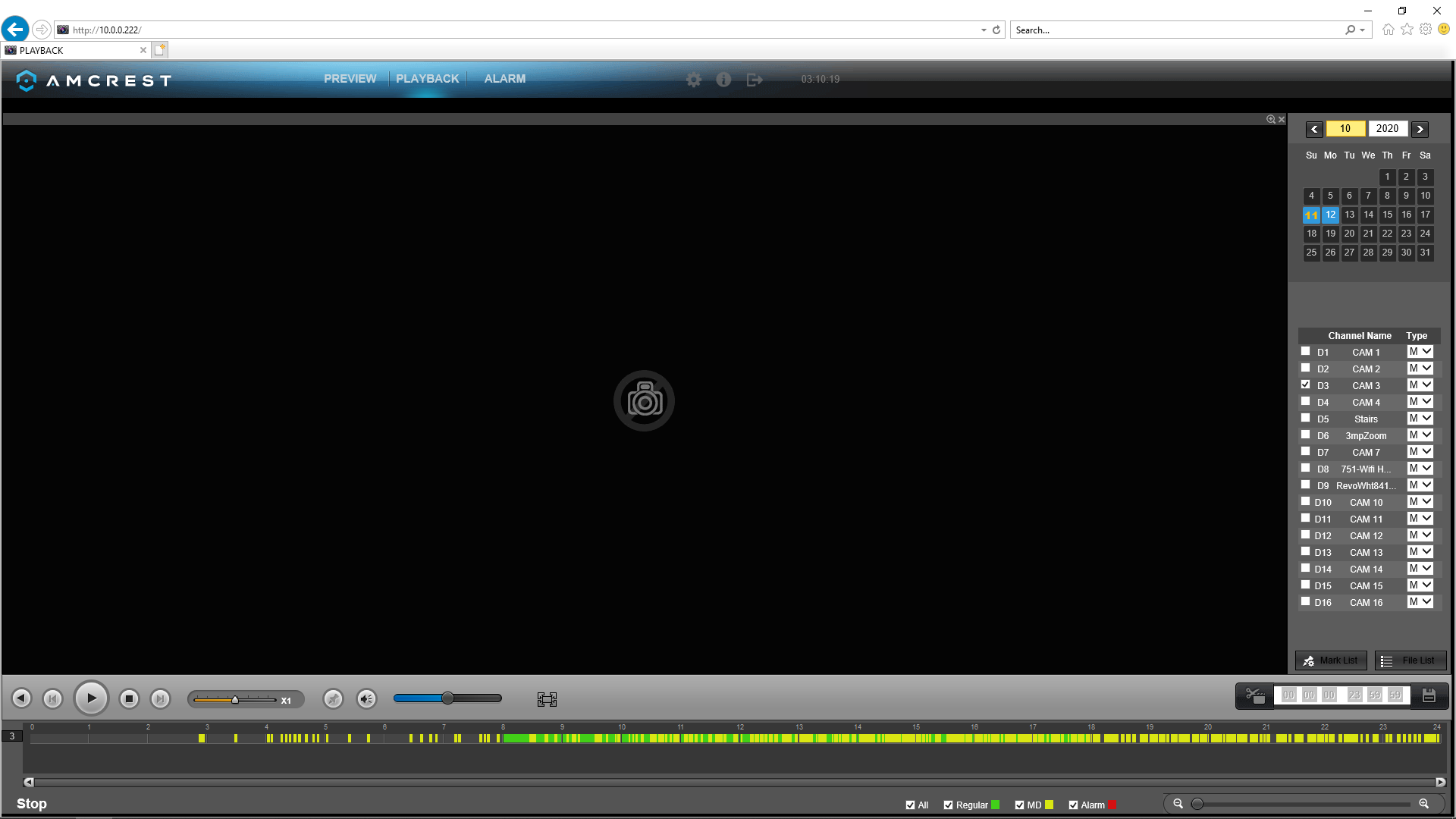

Don't mind my Picture graph I did a Factory Reset on my NVR a couple of days ago and some odd reason after importing all my Cameras back into the NVR I did something to 1 camera and all other cameras Loaded up as CAM names and I just have not fixed the names lol... The picture is for Camera 3 This camera has loads of Traffic as you can see and because I wanted to save on space I setup Night for Motion only lol.. I know I know what did I save many a Gig of space... Anyway you can see that Motion is full time, and in day I have setup to Full Time record and I have motion in space with Full time I can just watch motion for that time if I so choose..
That was not the Same Action I got for working in my ASP Just had full time Yellow in a Camera I was setup in full record but wanted Events Recorded...
And Yes I do Restart ASP after all adjustments because I go one step more and Restart my Computer...
This last test was on my Last AMD machine in my home, It was ran on a 2012 or 13 can't remember now when I bought it, Fx4300 16gb ram running on a 480gb SSD, GPU was R9 270x 2gb in Crossfire as I have 2 GPU's on a 750watt PSU on a Free air frame.. I wish I would have taken some snap shots while it wasn't as bad as the other machines I ran the testing on last time last year or earlier this year my CPU was at 12% with 9 on ASP while it wasn't showing in running apps that is my Syslog computer so that was running in the background one of the Cameras in that test has 2019 FW and was posting to my Syslog... Didn't have my Kill-o-Watt meter plugged in but I am going to guess it was far higher then .6amps... That is awesome that your computer was able to run at 72 watts for your testing time..

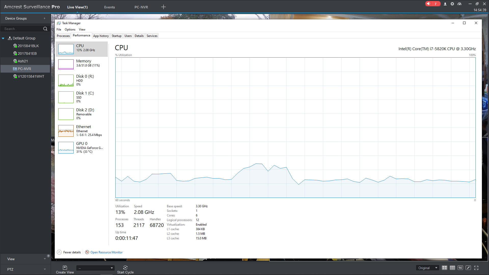

Going to use my i7 5820k, 32gb ram, 1050ti gpu, Antec 850Watt PSU, going to a WD Black Drive. This machine has C as SSD and my R is normal WD drive.. It don't take much space for 4 cameras so I will give 120gb to PC-NVR...
So I will need to get little time to work this up.. That is because I wonder if my Issue is that all my Cameras even though I setup in ASP and PC-NVR and while I didn't install my NVR or DVR that they were connected to the Cameras were still active in them machines and I wonder if that might have an Impact on the issue and I wonder if that is the issue with others that are having issues???
So I think this time I will remove the Cameras from the Normal Recorders they are on.. Make sure they are not connected to FTP as most of them are, and only connect to ASP with PC-NVR... I wonder if that will cure the odd Recording issues and report back my Motion Detection findings.. I might do it in a couple of stages to see if I can find a link to an issue in my Theory of why my Results were as Posted...
Re: PC-NVR issues with MD
Yes sadly this isn't working.. I have 4 cameras setup as stated.. Testing my system it is at 10 to 11% CPU in use.. Looking over the Footage so far all Channels are GREEN for full time recording and right now CH1 is Scheduled with CH4 to be Pure Motion right now, Ch2 is full time Record and Ch 3 is Full record and Motion Full time... At least last time there was something showing that it was doing something to look at the Schedule.. This time all channels are Full Record? Yet between 245 to 345 I had setup ch1 and 4 to be only Motion events no Full Record as Green line removed, Yet in search all channels are in Full record only...
Yeah so I will have to do some more Testing because for now this just isn't working and 0 motion even though I have setup and toggled Motion on.. ASP in any form for me just won't do what I want it to.. Either there is just to much setup to get things working and on this computer you can see only thing that was taking CPU was ASP there was some other using memory for Virus protection in play that stated use was high but that was Background program once that does it job and sleeps it would have been only the ASP.... With it Saying it is using HIGH POWER yeah ASP isn't for me.. Last picture is of the Cameras loaded in the Devices...
