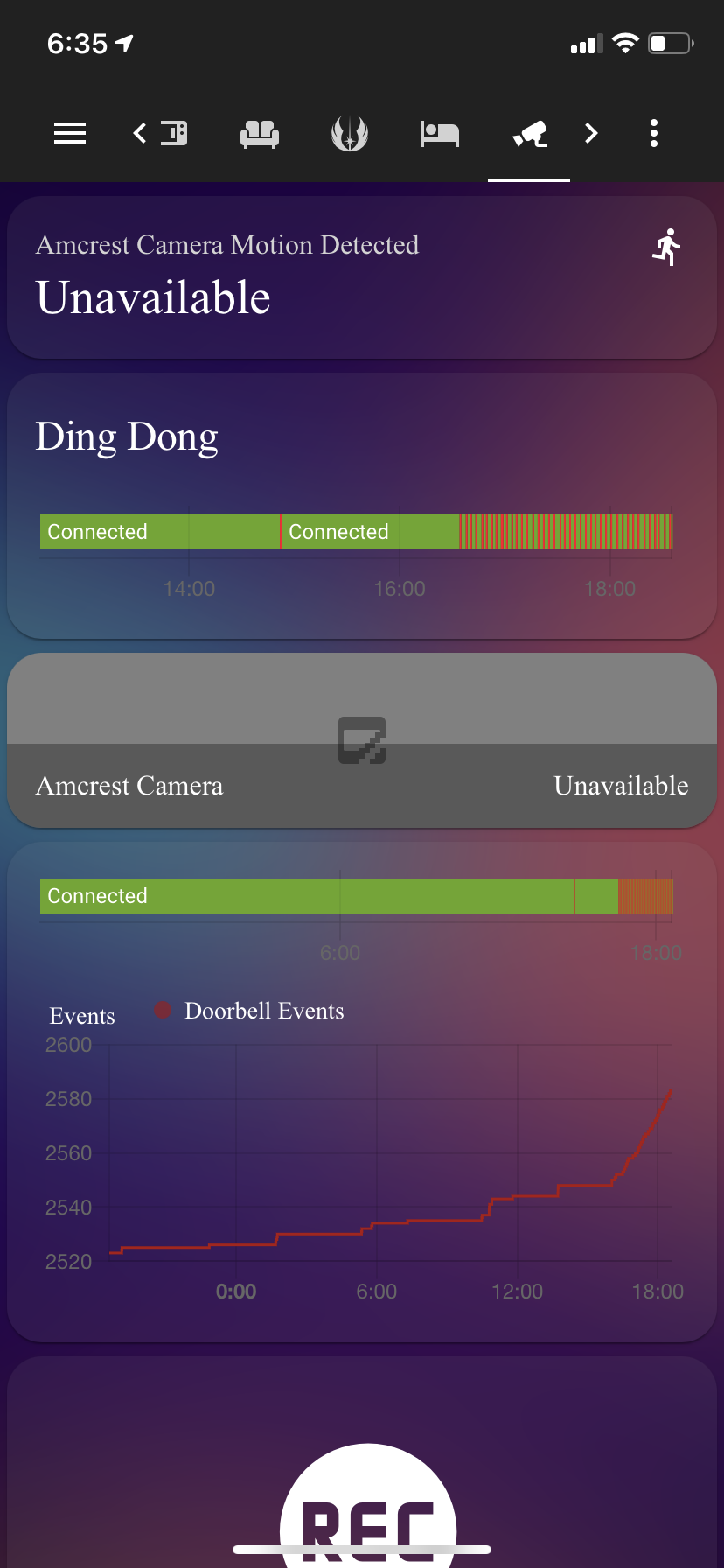

Soooo all been well since the last update, evening disconnecting hell has returned.
WTF is it with these things. And amcrest tech help so far has been a joke.
Been 2 hours....
Disconnect hell returns.......ad110
