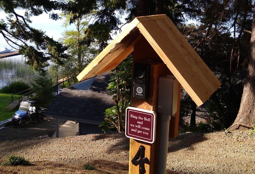

My AD110 camera (doorbell.jpg) is located about 120 feet from my Nutone Doorbell transformer and Mechanical Chime.

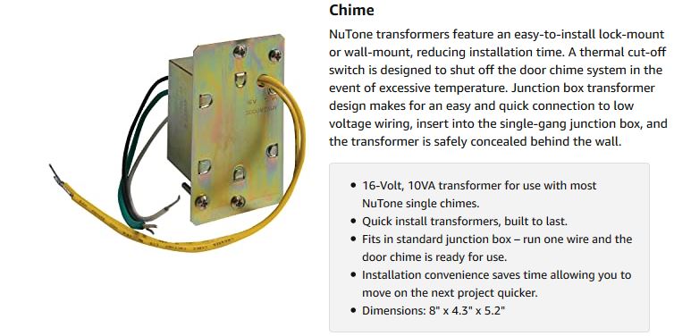

The transformer is 16-Volt 10va.(Newtone_transformer.jpg). I have cat6 cable wire from the transformer to the camera screws. I have 1 pair of the cat 5 attached to one screw and another pair attached to the other screw. (yes it is not the higher gauge door wire). The voltage across the camera screws (doorbellterminalscrews.jpg) WITH the Wiring attached is 15.75 volts. In the evening I was getting similar disconnects as you described. Using my smart phone WIFI Net analyzer app. My RSSI numbers ranged between 78 and 69 and average signal quality was 65. My Neighborhood has lots of 2G WIFI competition My Router is located about 100 feet away with walls and trees between the camera. I fixed the disconnect problem by installing a 2G Access point about 30 feet from the camera. I set the access point channel to a specific channel so that it would not automatically switch away when the channel got "crowded". I no longer have disconnects...

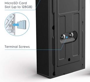

- doorbellterminalscrews.JPG (18.9 KiB) Viewed 2071 times
- newtone_transformer.JPG (59.75 KiB) Viewed 2071 times
- doorbell.jpg (206.71 KiB) Viewed 2071 times

1 anyone that has a 16vac 10va that Transformer isn't large enough no matter what people say. Some might get away using it but at no time with IR on will it be stable..
ALSO BE IT KNOWN IF YOU ARE USING A LOW CURRENT TRANSFORMER OR HAVE ISSUES THAT TURN OFF AND REBOOT OVER AND OVER AGAIN DON'T TRY A FIRMWARE UPDATE UNTIL YOU HAVE STABLE POWER 16VAC 10VA MAY NOT BE ENOUGH POWER TO DO AN UPDATE ON NORMAL DAY TIME EITHER!!!!!
Things to be known. To small of Wire (2x24awg aka cat5e wire is to small) also Distance and quality of wire are major factors in your quality of camera feeds..

Using my smart phone WIFI Net analyzer app at the door bell location (look at the picture from my previous post showing it's location). The AD110 thought my WIFI connection was "good"
BUT
when surveying the the WIFI Spectrum, I saw over 28 SSID waiting for connections. Eleven using Channel 1; Six using channel 11, The rest split over the other channels.
I fixed the problem by putting my WIFI Access point as close as I could , So that MY WIFI Signal was stronger then the 28 competitors. I set the AP to one channel so that it would not auto-negotiate when my competitors "shared" my channel. Additionally I have very few devices on my SSID network and they are very low bandwidth. Actual channel through put is about 35 Kbps RX and 1023Kbs TX. My Access Point has a Max TX rate of 144.4Mbps (that is the best case) Remember, Actual TX is less when you have others sharing the same channel bandwidth and signal strength.
