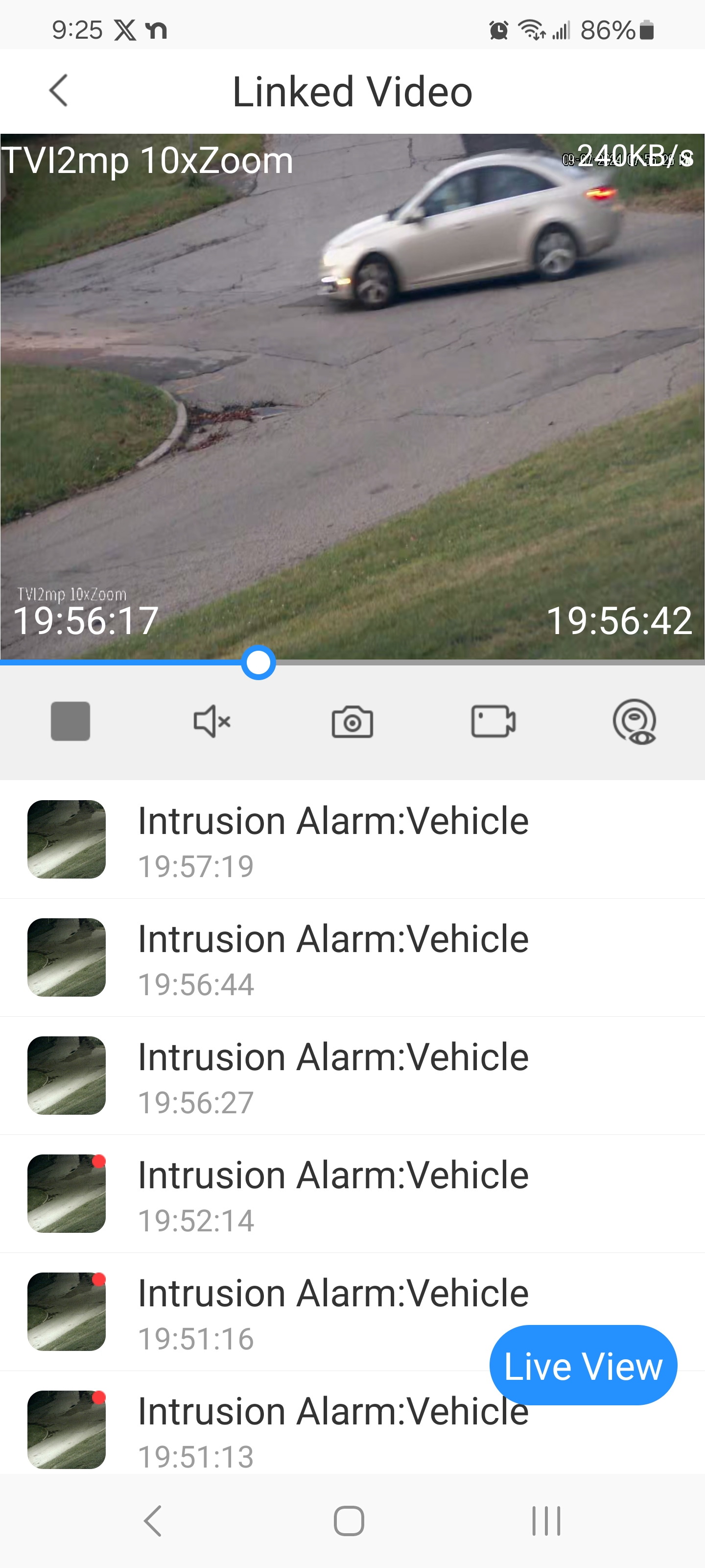

Re: Push Notifications suddenly ceased on ALL my cameras?!!
There is a way to get to the live video from the Notifications it is just not as easy as it was one with the Older AVP..
From the Notifications click on the event in question, it will pull up the event window, then click on the play event and it will start to play what happened and at that point there will be a button at the bottom right that says Live View..
What is missing from the AVP2 is the ability to pick the event type like AVP had with Live View, Image and Video.
