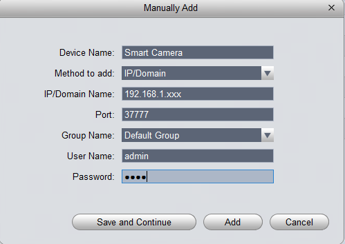

@uhs74, here's how i was able to add a smart home camera to the amcrest surveillance pro. smart home cameras should be added via their local ip address.
device name: name you give to your smart camera.
method to add: ip/domain. (smart home cameras are not p2p)
port: 37777 (i believe this is the default for smart home cameras). my advise is leave it as 37777. set up port forwarding in your router.
group name: default group.
user name: admin
password: <password to your camera)
