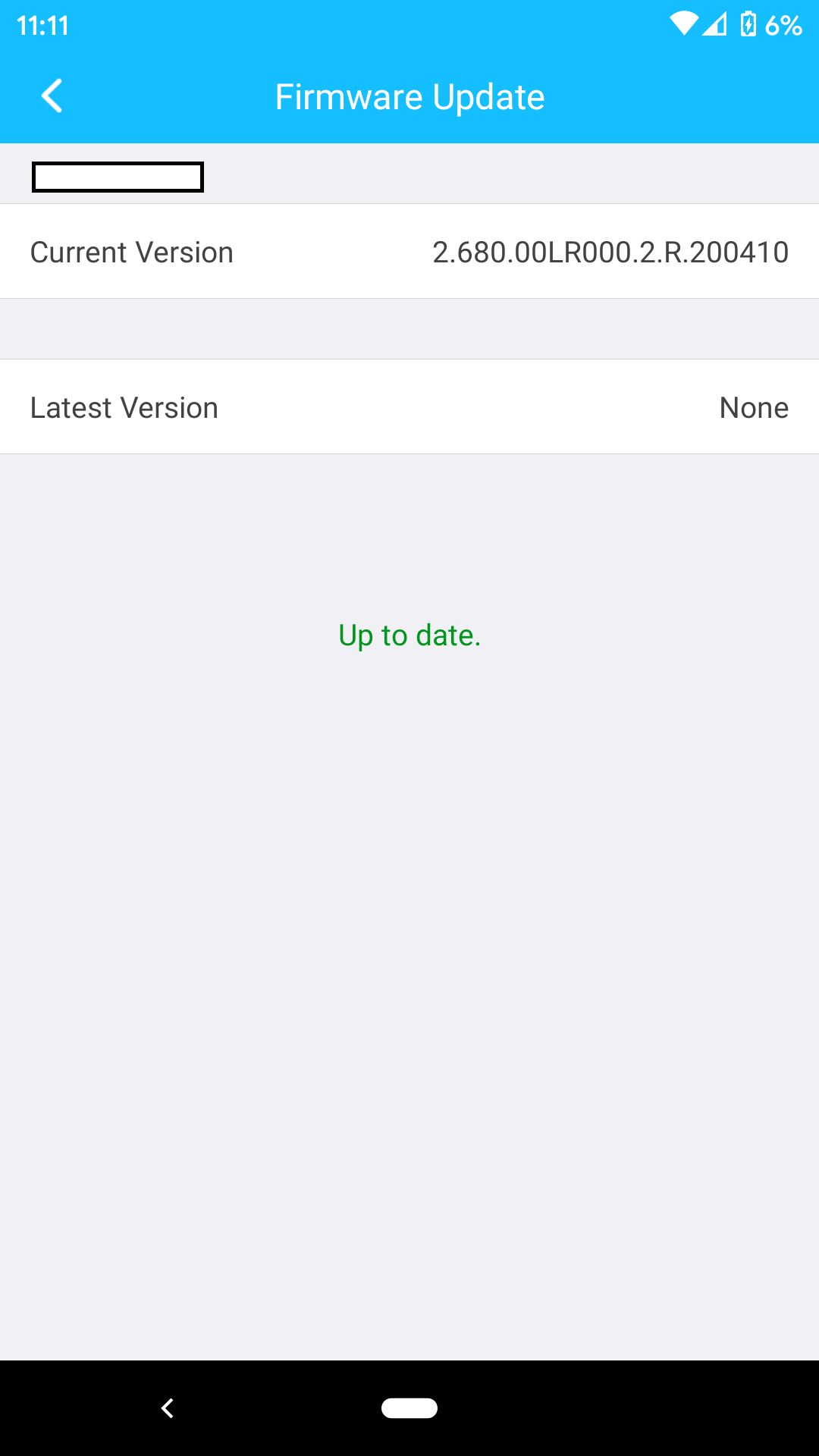

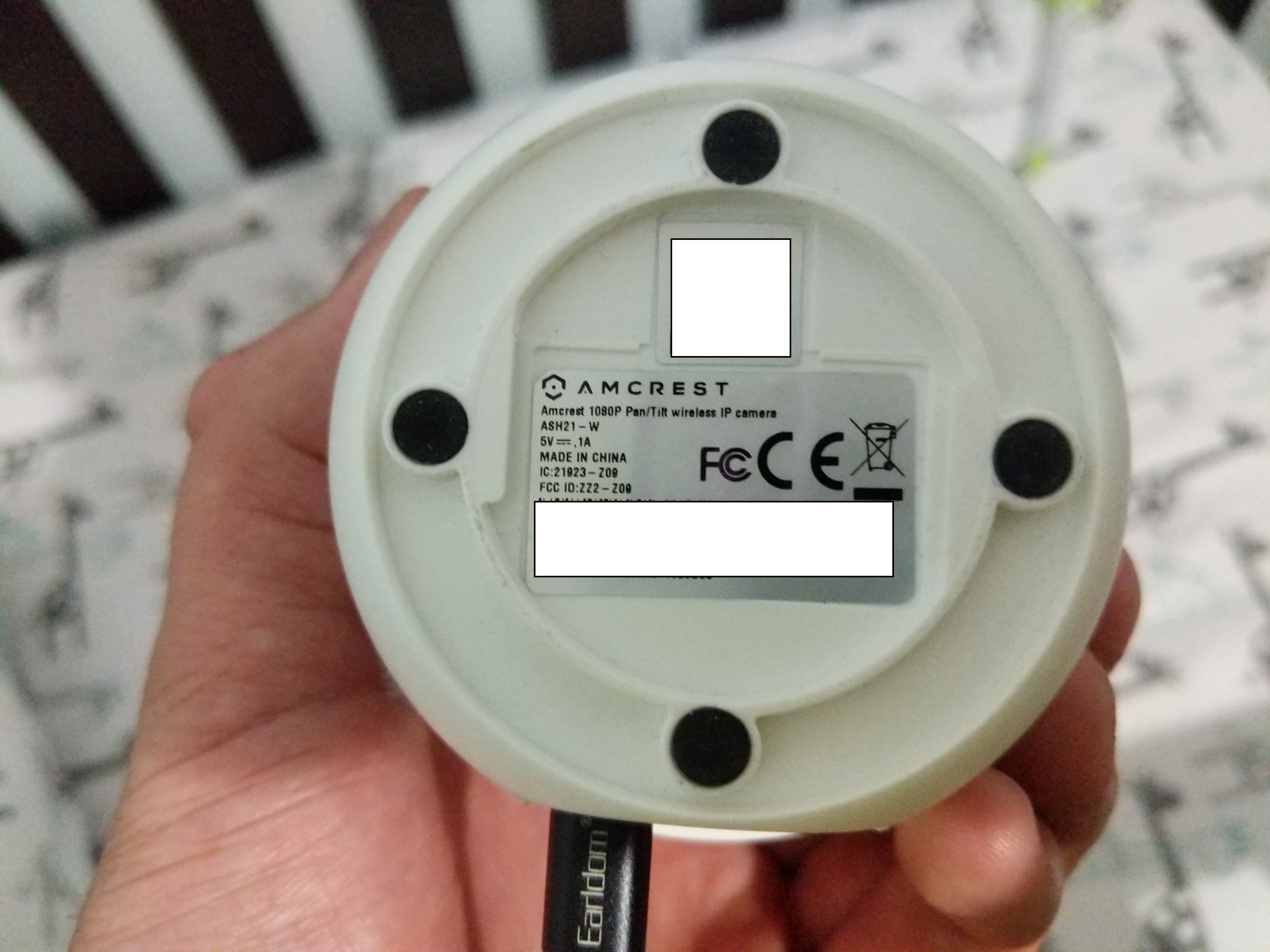

I found this thread due to searching for an unrelated issue with the ASH21-W I purchased mine in July off Amazon and setup only using the WiFi, I've never actually connected an Ethernet cable to it. My camera does not seem to exhibit the same issue. I constantly move it around the house unplugging it and plunging it in other locations to keep an eye on my 9 month old. All the ports are open all the time. I have it connected to a Hikvison NVR using RSTP on port 554, with the path cam/realmonitor?channel=1&subtype=0 I use the connection to the NVR and to the Amcrest APP simultaneously with no ill affects. I've added pictures of mine in case it may help. I'm curious to know if the FCC id and others match, as they may be different hardware. I've also included a screenshot of the firmware
