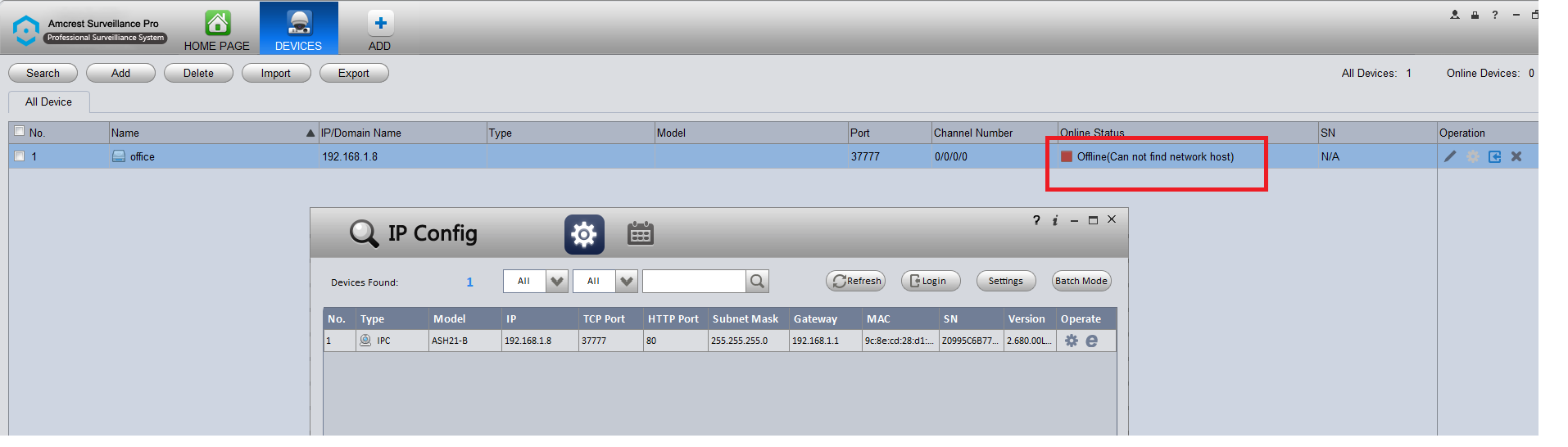

1)Amcrest IP Config Software - I can see camre ip address and modal but with that not able to login or do anything
I tried to use password for ip config tool or camera password with 'admin' as user name
I m also confused on which user name and password need to use. i tired diff. combination but no luck
2)Amcrest pro surveillance window software- add manually camera using ip address and pass but it always says offline -networks host not found

for me following did not work-shows as offline -network host not found https://support.amcrest.com/hc/en-us/ar ... Pro-ASH21-
I tried wired connection (ethernet cabel connected between routher and camera) which worked but as soon as I m on WIFI - it did not.
is it defective? thinking of return it if it is an issue

Thank you for reply.
In short,
if camera is connected to router via ethernet cable ,it works fine on laptop using Amcrest IP Config Software or Amcrest pro surveillance window software.
if camre is connected via WIFI (NO physical ethernet cable connection to router),it only works on Mobile Phone app.
for both testing, my laptop & camera were connected to same wifi 2.4 GHtz .
I also tried to reboot routher and camera too but no luck
I have not touched any ip address or any other policy on laptop or router.
Only diff. I noticed that ip address of camera is diffrent when it is connected to wifi VS wired connection.
each time I use latest ip address which is shown in IP Config tool to connect
so not sure what is diff. when I connect to wifi vs ethernet cabel
if anyone has step by stpe instuction , I can compare. Not sure if anything needs to update on roter level or ip address setting.
