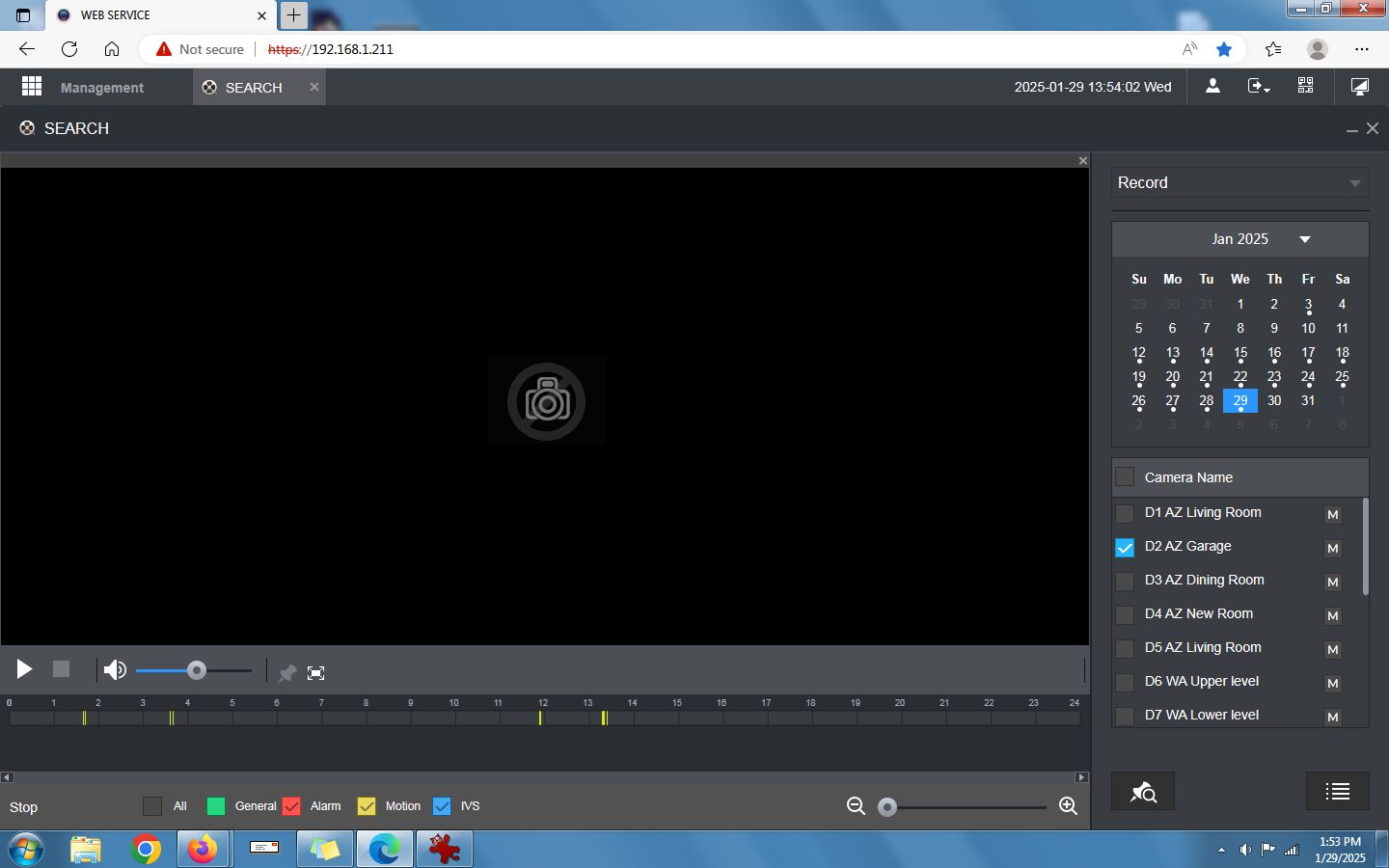

Your description of the main page is slightly different than what I see. I am providing more detail on what is happening; hopefull this may be more helpful.

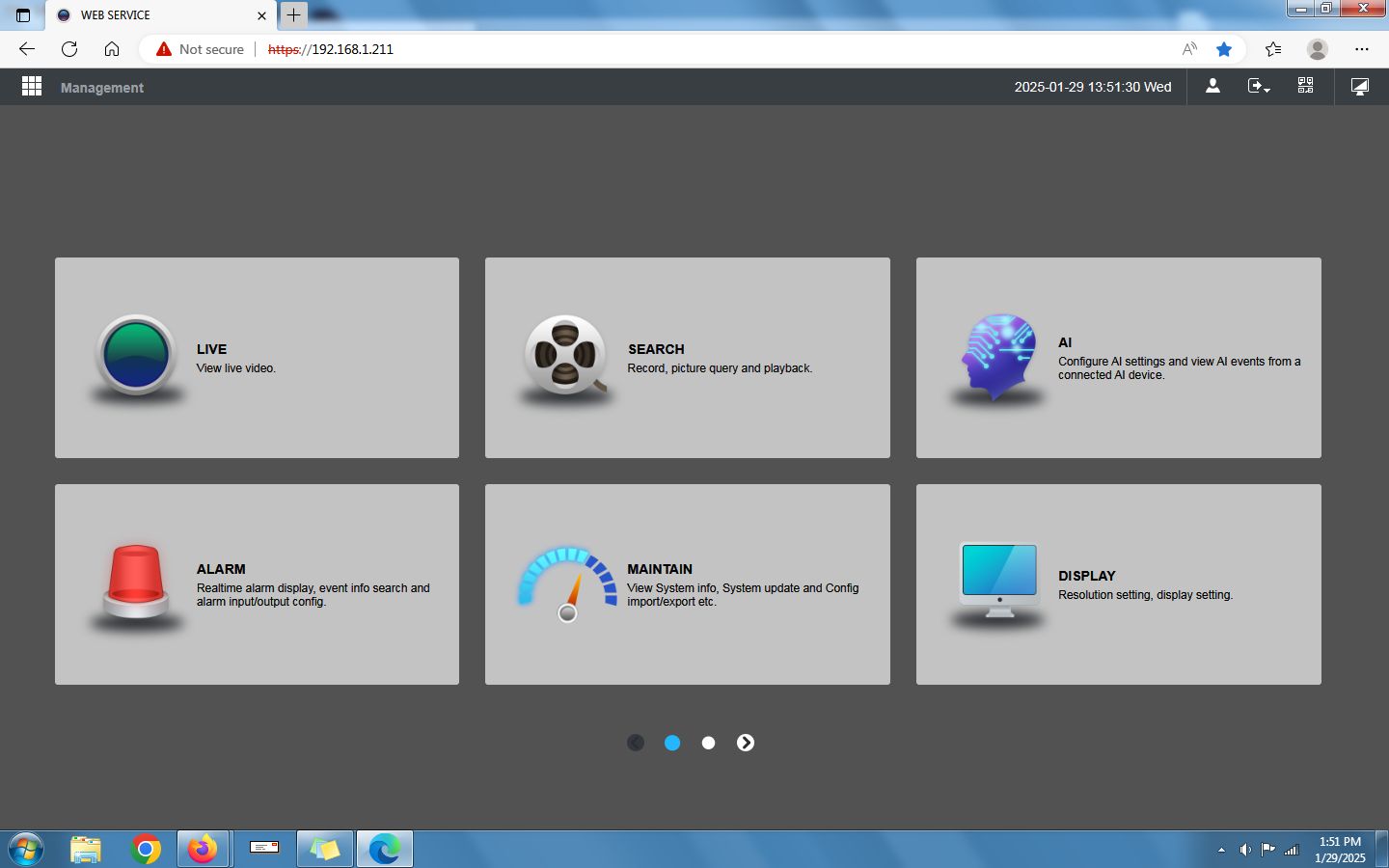

When I log in to the NVR, I see a screen with 6 colored boxes. They are:
Live, Search, AI, Alarm, Maintain, Display; A second page has an Audio selection.
I select the Search option, I then select the date and camera name that I'm interested in from the displays on the right of the screen.
At the bottom of the screen I uncheck the Blue "All" box and only check the Yellow 'Motion' box - since this I what I'm looking for. This allows me to scroll horizontally and play back the recorded segments that I find.
So far, this is fine; now I want to download/save something that I see.
I click the icon at the lower right and this brings up the listing of recorded files and I can select one or more of these and learn their start and stop times and file size. Now this is where things go wrong:
According to the manual, there should be a 'clip' and a 'save' icon below the viewing area - there are none. In the area where the file information is shown, there is a 'GO' box - but this is greyed out. Maybe this is what is supposed to initiate a download but it isn't functional at this time. ??
There doesn't seem to be any further operations possible at this point.
I noticed a few discrepancies between what I am seeing on the display and what's in the user's manual (A2 Network Video Recorder User Manual -- Version 1.0.0) which I downloaded from Amcrest. It's a 2.88 Mbytes PDF file which I though belonged to this item. Can anyone point me to the correct one?
Any further information will surely be welcomed.

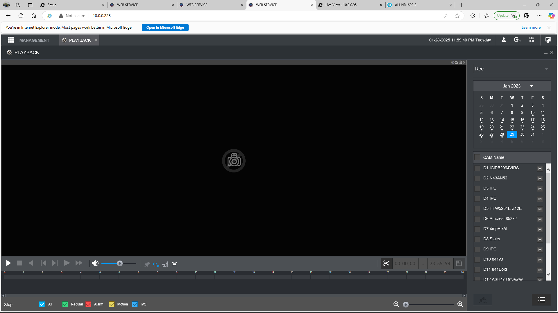

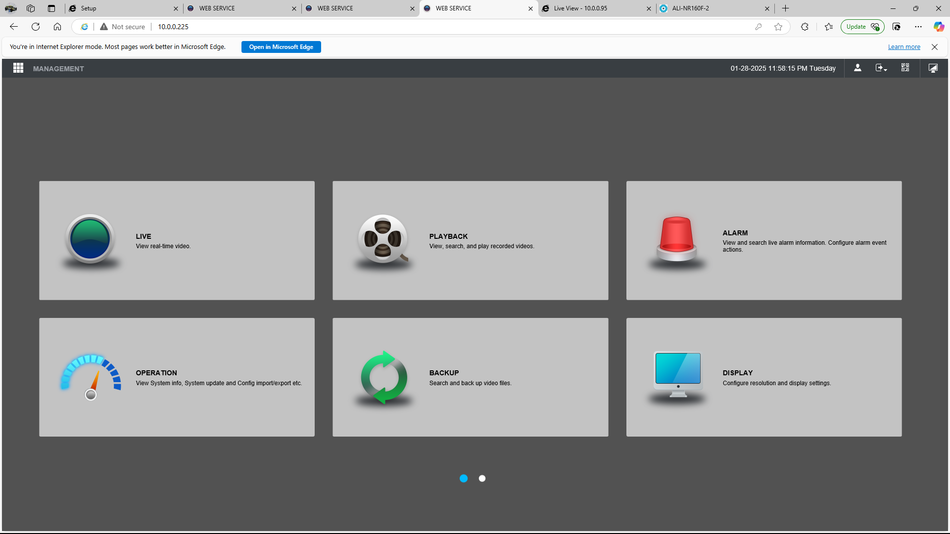

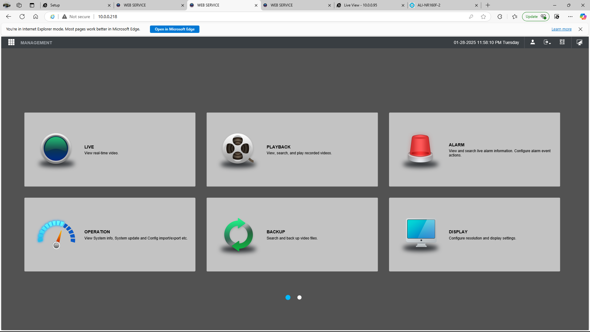

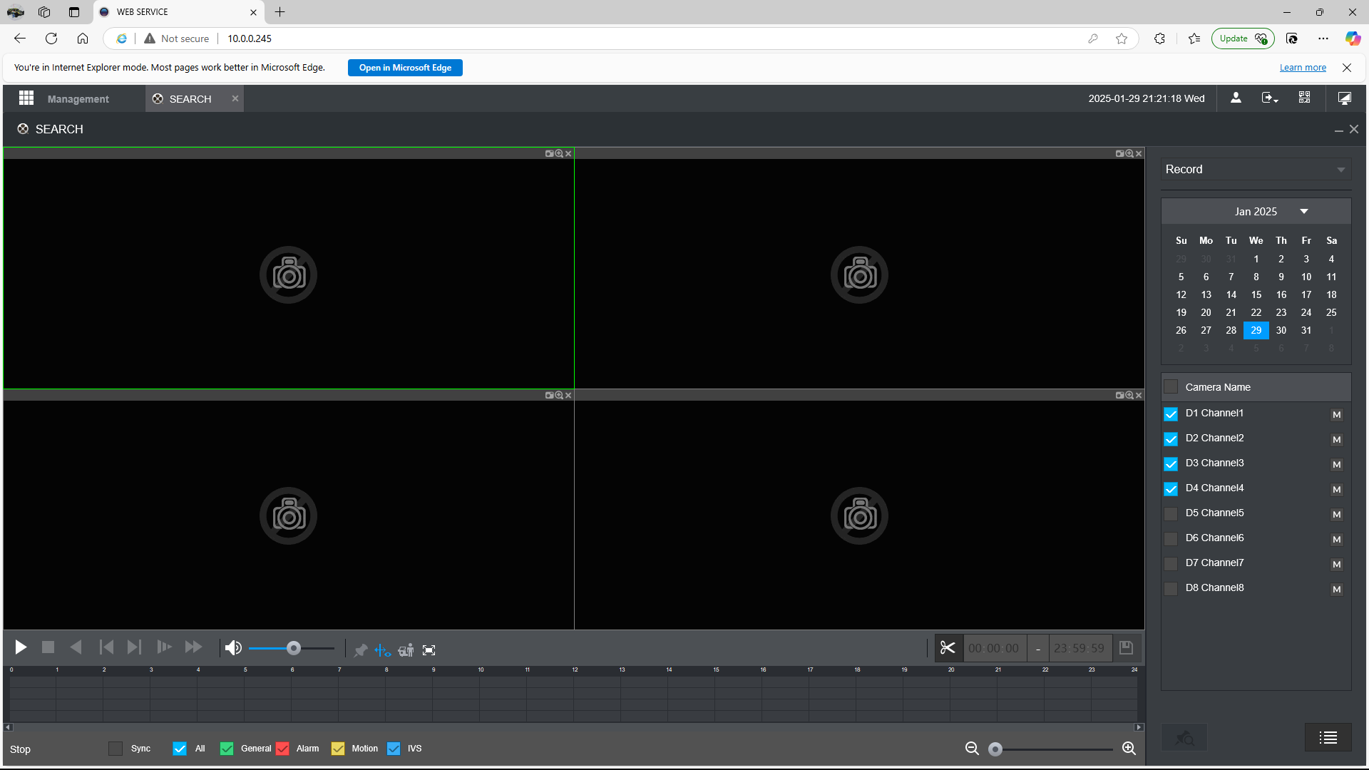

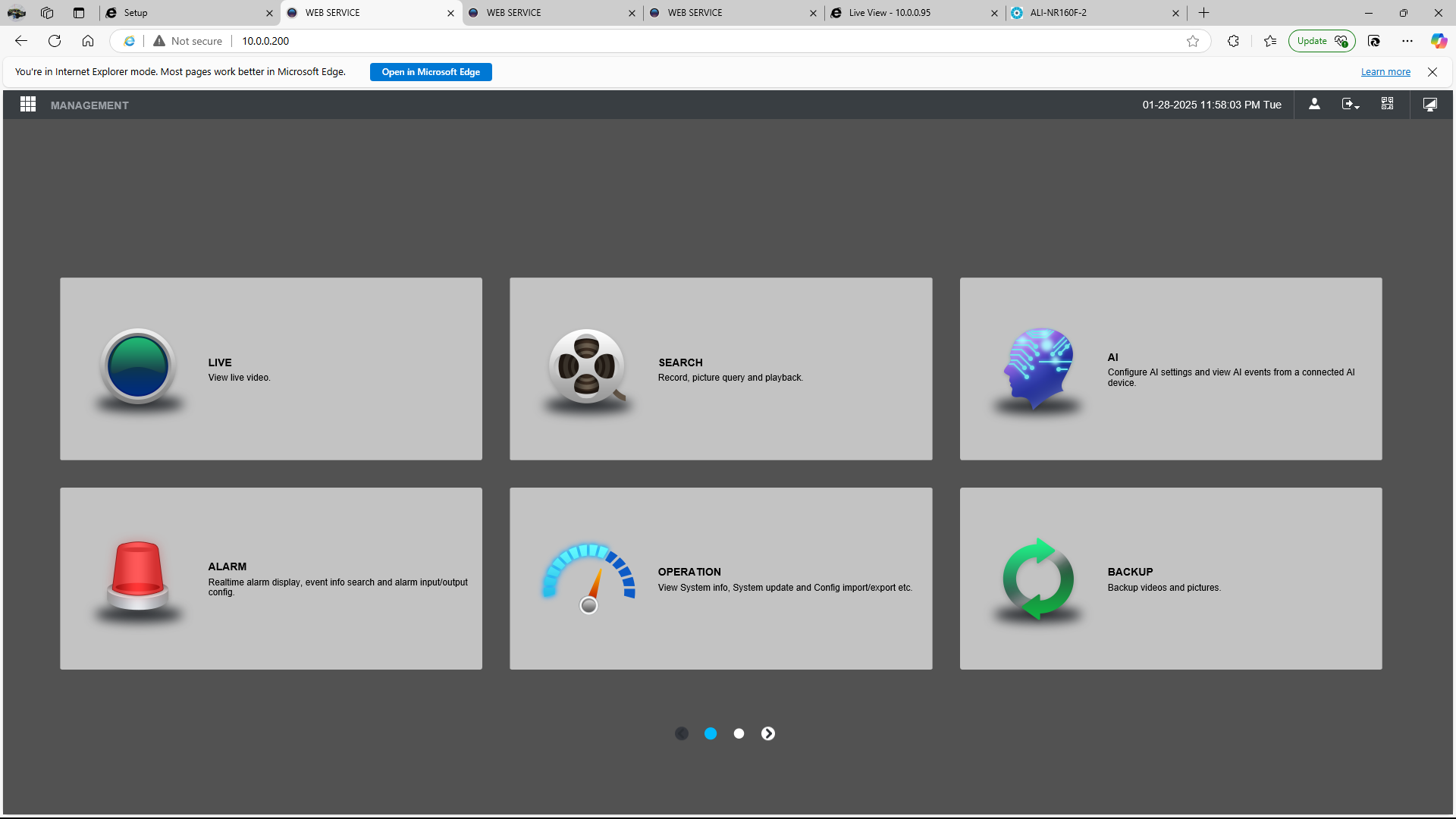

So your desktop don't look like any of the 3 that I have below. Also your playback don't look like the one in the picture below?
2nd, 3rd and 4th are from HS models 2nd is from 4108E-HS, then last 2 are 4116E-HS

Desktop most closely resembles first image - (Screenshot 4107) except that there is 'Display' option instead of 'Backup'
Opening 'Search' option results in image somewhat like Screenshot 4110 with some differences:
Upper left title is 'Search' instead of "Playback' I can't find any 'Backup' anywhere.
'Camera Name' instead of 'Cam Name'
'Record' instead of 'Rec'
below viewing window at lower right, there is no little box with clipping icon, numbers box, and save icon.
also viewing controls are different, I only have start, stop, volume control, pushpin & full screen icons. No fast fwd or reverse

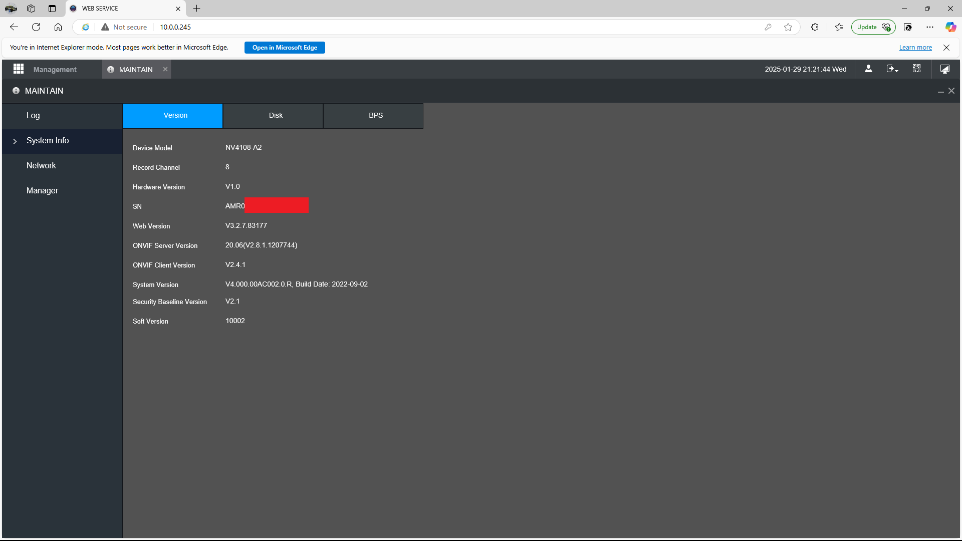

System Info tab on "Maintain" screen has following info:
Device Model: NV4116-A2
Hardware Version: V1.0
Web Version: V3.2.7.83177
ONVIF Server Version: 20.06(V2.8.1.1207744)
ONVIF Client Version: V2.4.1
System Version: V4.000.00AC002.0.R, Build Date: 2022-09-02
Security Baseline Version: V2.1
Soft Version: 10002
Soft Version: 10002
I will try to attach images, not sure if I know how
