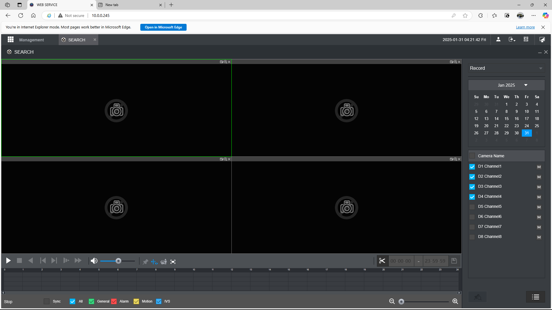

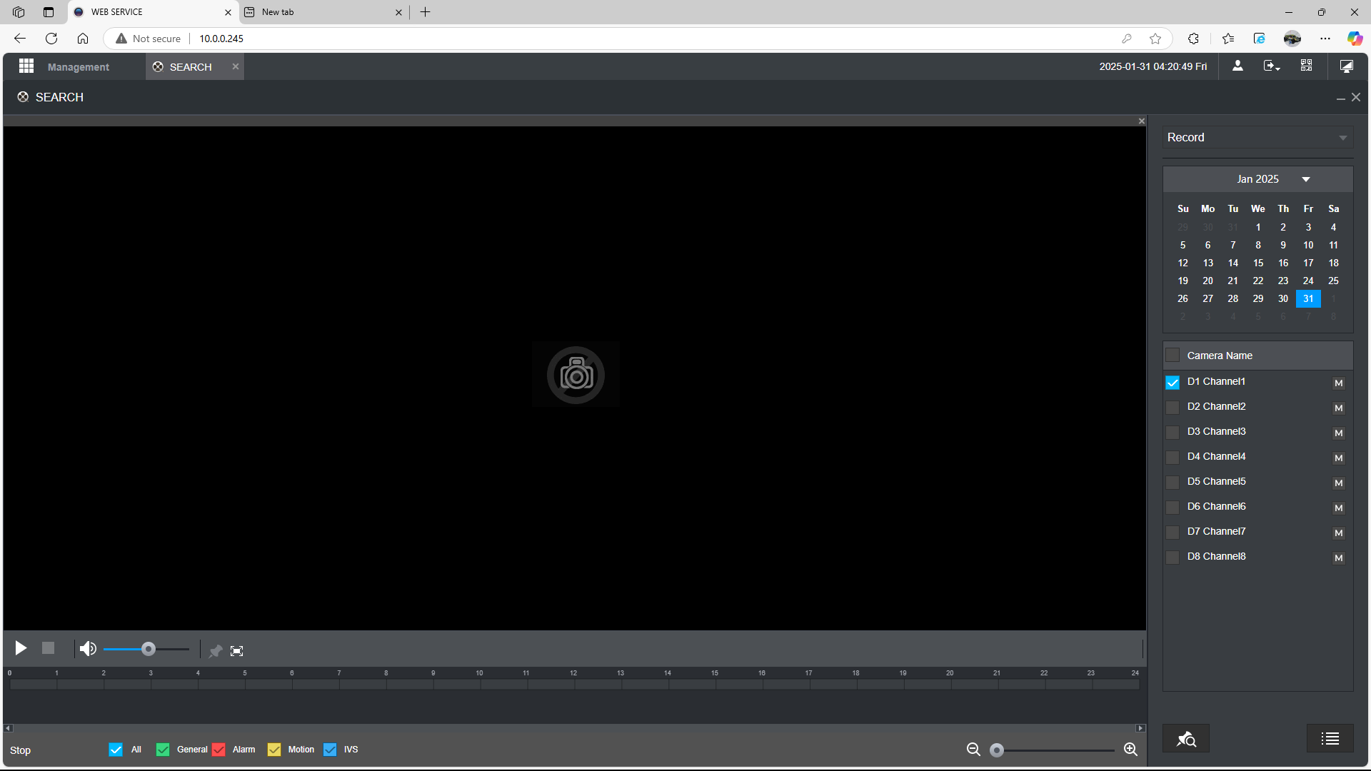

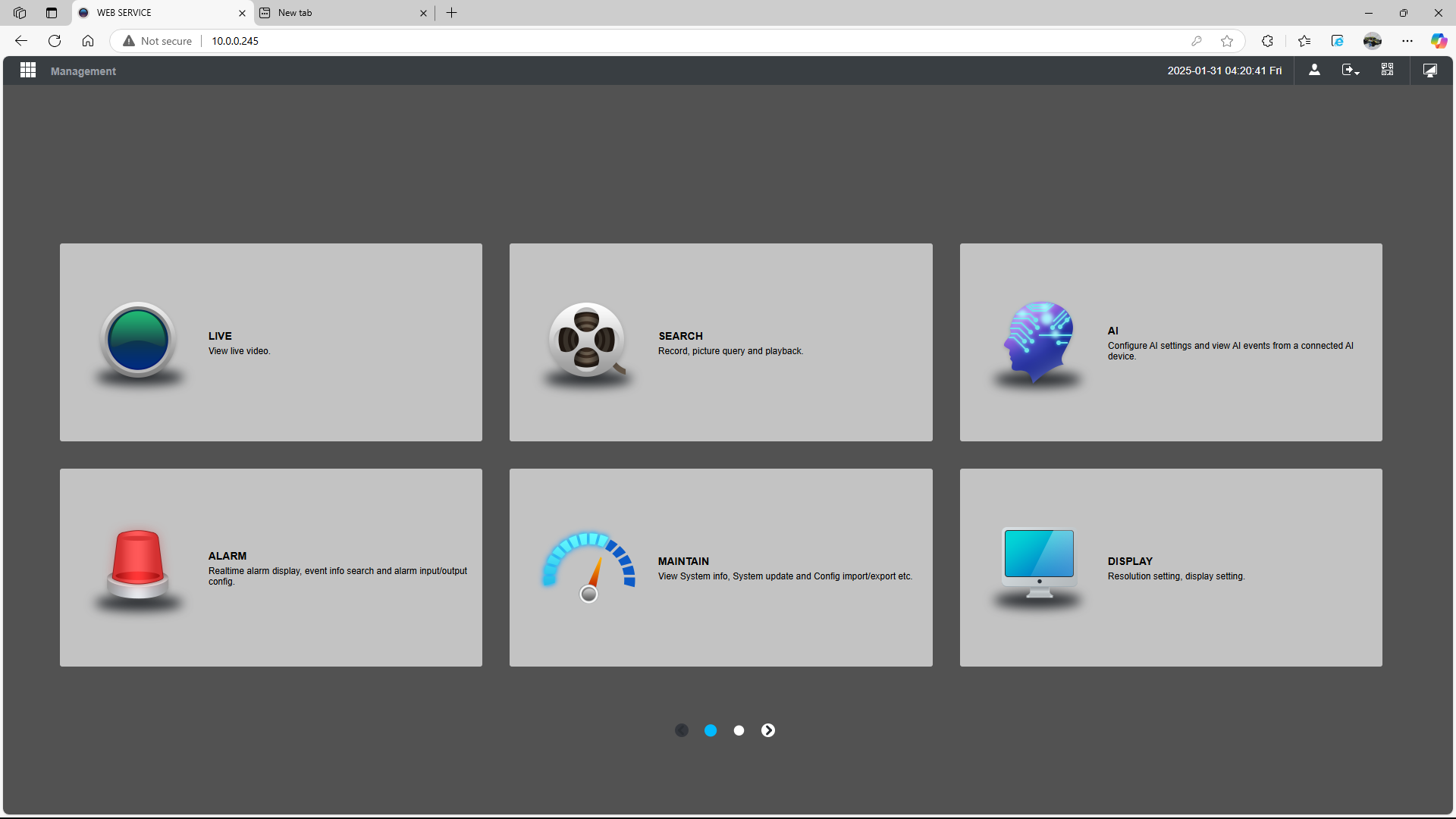

Anyhow, I did a factory reset using the push button switch; in fact I did it twice. The first time after getting it set up again, it was finding data left on the hard drive from before. I repeated the reset and remembered to format the hard drive to get a fresh reload. Still the same results. Today I downloaded and installed the latest firmware. This didn't seem to work using the Edge browser but I was successful when using Chrome. It reports the same firmware versions as before, But - the Search page still looks the same, lacking the download/save ability that I want. From looking at the web source code, it looks like it was all written in Javascript. I tried using my wife's computer which has Windows 11, I thought there may be a difference there -but nothing different. There are some small differences between using Chrome, Firefox, and Edge. Emptying the cache as you suggested didn't help.
I'm kind of at a loss to figure out what's going on here. This will be usable for me, I can work around it. If ever I want to save an image, I can note the file time stamp and connect to the camera directly to download the file from there. That is what I was doing before deciding that this box would be an easier way to monitor things rather than sequentially checking multiple cameras.
OH, another thing that I noticed - when working directly with the unit via a monitor and mouse connection, the screen looks like your image. I did not try the download icons as this is not the way I would be using it in the future once the setup process was completed.

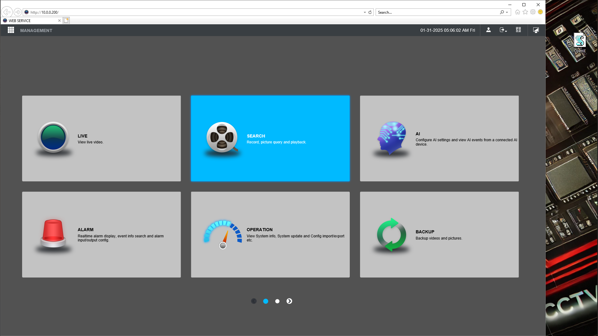

So had some free time and my guess is that you are using Edge normal.. I just looked at my A2 using just Edge and Chrome and my page looks like yours..

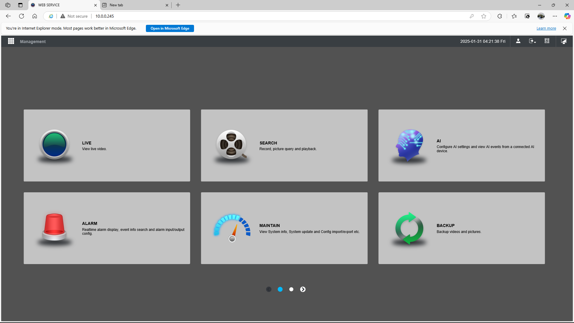

So here is a picture of using IE from the script file you can see at the top of my desktop on the right.. When i double click the script it loads IE with the normal e that it has and just entering one of my NVRs Ip address like normal.. You can see the main GUI screen has backup.

I did a firmware reload again (using the same downloaded from before) followed by a factory reset (from the GUI; not the button press method). I restored the settings from a previous backup file. Things looked the same. An odd thing I noticed was that it failed to restore the motion detection settings which I had to redo. Later before going to bed, I thought about giving it another try with the Windows 11 machine. Then, a sort of miracle happened; after it loaded the URL, a little window popped up asking to download and install a program "webplugin.exe" (Version 4.1.511.0, 2.96 MB) - which I did. I hadn't seen this happen before and proceded. Now, the resulting screens matched those images which you posted. I was able to successfully select and save a file. I noticed that I was running Edge in the 'Internet Explorer' mode. In looking around, I had found a method of activating this using the browser's Settings menu for Default Browser. This looks like an alternate to what you described with the .vbs script.
This seems to be the key - when using a browser in the normal manner, I'm getting the initial results I got; switching to the I.E. mode and using the plugin file results in the latter ('correct') results. I kind of recall now running into something like that when setting up the cameras several years ago. There was something about requiring a plugin, then a firmware upgrade and it was no longer necessary. I remember doing at least one upgrade on those cameras. Maybe it is related to this condition? Or maybe it was an incomplete update installation which required a factory reset to complete.
