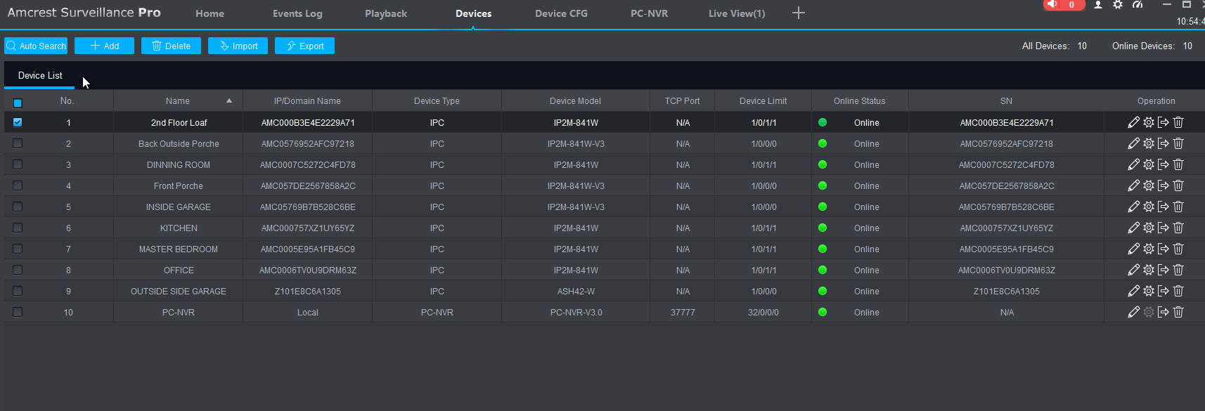

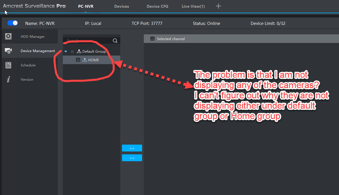

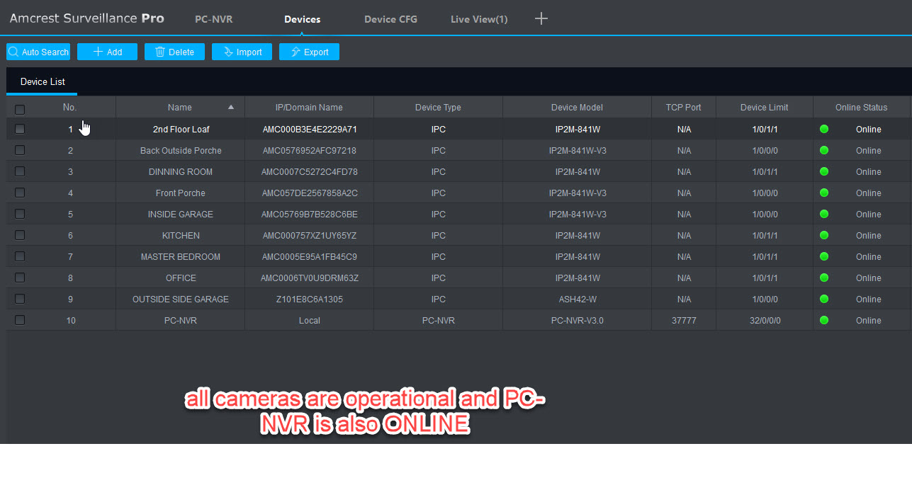

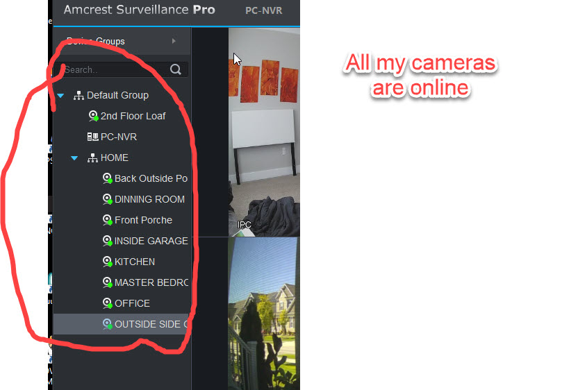

The problem is that I am not displaying any of the cameras?
I can't figure out why they are not displaying either under default group or Home group.

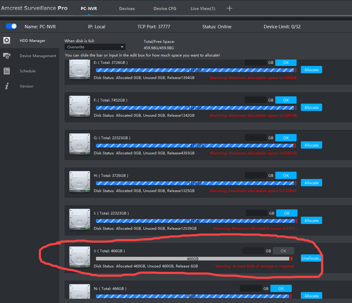

All my cameras are online and GREEN, same as NVR. I also have successfully allocated space to the NVR
NVR NOT DISPLAYING CAMERAS ON DISK MANAGMENT

Hi
Thank you for the reply. I am reaching the pictures, as JPG's.
- 2021-09-24_11-31-53.jpg (164.21 KiB) Viewed 6567 times
- 2021-09-24_11-31-30.jpg (131.95 KiB) Viewed 6567 times
- 2021-09-24_10-54-55.jpg (189.51 KiB) Viewed 6567 times
Re: NVR NOT DISPLAYING CAMERAS ON DISK MANAGMENT
here are two more pics
- 2021-09-24_11-33-33.jpg (283.8 KiB) Viewed 6567 times
- 2021-09-24_11-32-31.jpg (84.09 KiB) Viewed 6567 times

In PC-NVR Device Management, select the Home Group and then the cameras in the group should appear. Select them one at a time and then click on the double blue right arrow to transfer them into the selected channel display area. That should do the trick.
Looking at how things are setup in my system it seems the issue is your systems are all P2P and no recordings of P2P devices out side of Network
So it looks like a few things might need to change but first I would try changing 1 camera first.
Change from P2P setup to an IP setup. Then if that is able to be added to your PC NVR all is good. However another issue might be that your PC-NVR is setup in Local and not in your Computers IP network and as such might not work.
So in the end you might need to not only change all your Cameras from P2P connection to IP you also might need to change your PC-NVR setup from being connected under name Local that is running on a 127.0.0.1 IP and not the true ip of your Computer...
I know for sure that I can't record my P2P connected devices on PC-NVR only ones that come up for the ability to be added is once that are on my Network IP range..
I just took my NVR 4216E-AI NVR and Removed it from my ASP, added it back with P2P setup and while I can access the Cameras of the NVR looking at the live feed, PC-NVR will not let me add the NVR and it don't load in the list of cameras or devices I can add anymore like it did before being removed...
Thank you. That's exactly what it was. I changed all the cameras to IP and now I can see them on the NVR
