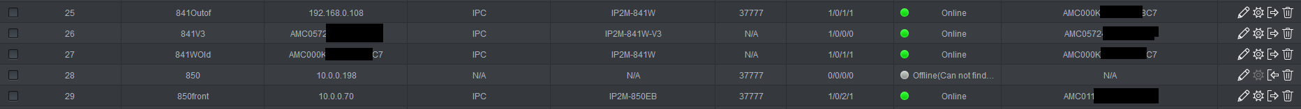

Today is a day that I have access to that camera. in this picture you can see it shows the connection to that camera over P2P and also over the 192.168.x.x connection as connected. I covered most of the SN as I don't need people trolling my devices over P2P. My normal IP range here at my local area is 10.0.0.xxx as normal cameras and you can see for one of my connected 850's that it is also connected on different IP. again on older ASP it didn't want to work well with PC-NVR if you had multi IP in your network settings with newer ASP it works and able to even record that camera on the 192.168.x.xxx range IP...

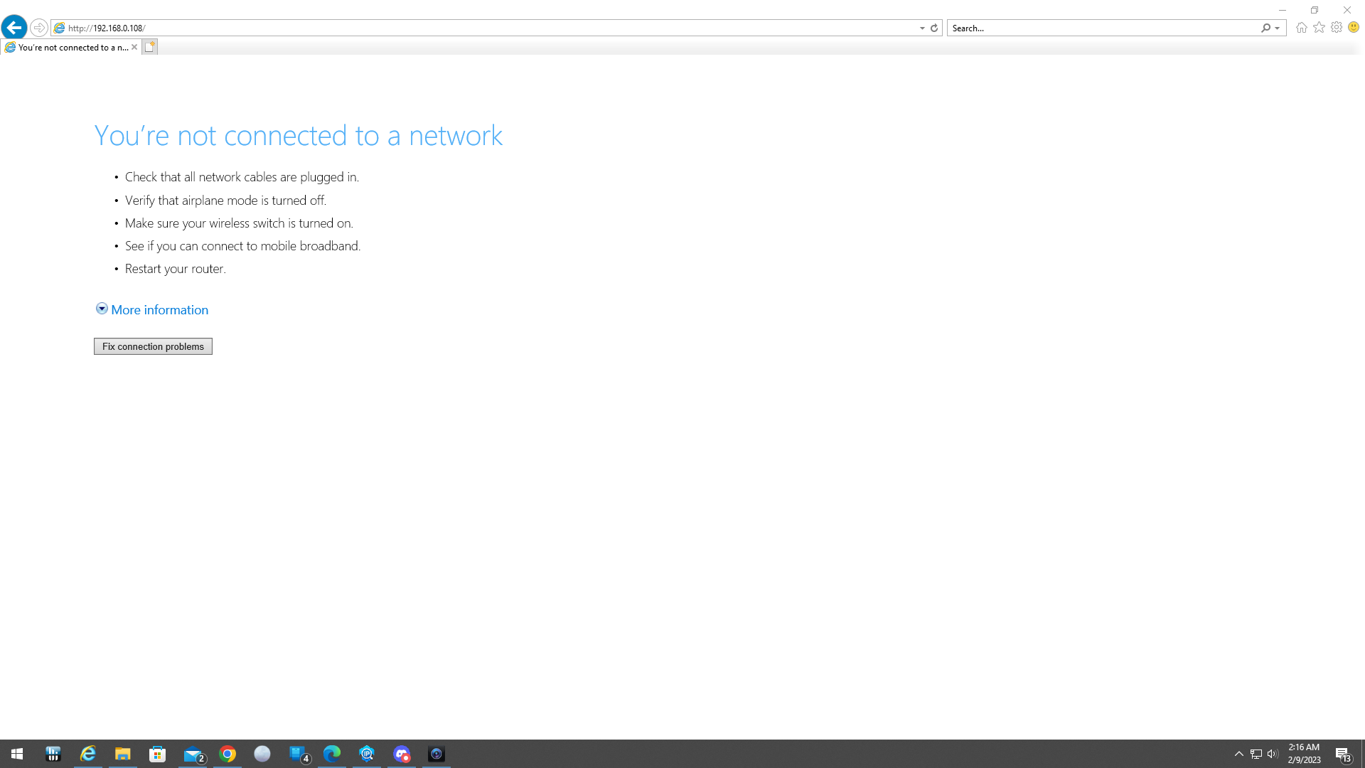

Now I am past my Connection time and if I try to access the Camera I get not connected to Network as expected because that network connection is now closed and my connection isn't there anymore however all other local traffic is still connected and you can see at the bottom of my screen that the connection to the network is really there. As I am sure you know when your connection to the internet isn't there the computer turns into a World Symbol where mine is showing the connected. That is only for my local connection..
