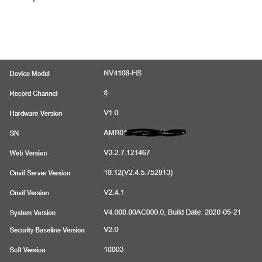

I have NVR 4108-HS and 2 cameras for my place. One is Amcrest IP8M-249 and another Reolink IPC-511W
I am trying to set up home security and i was able to get the 2 cameras added to the NVR, and both did the motion detect fine.
After the upgrade, my versions are per the attached picture.

- NVR.PNG (13.28 KiB) Viewed 6276 times
