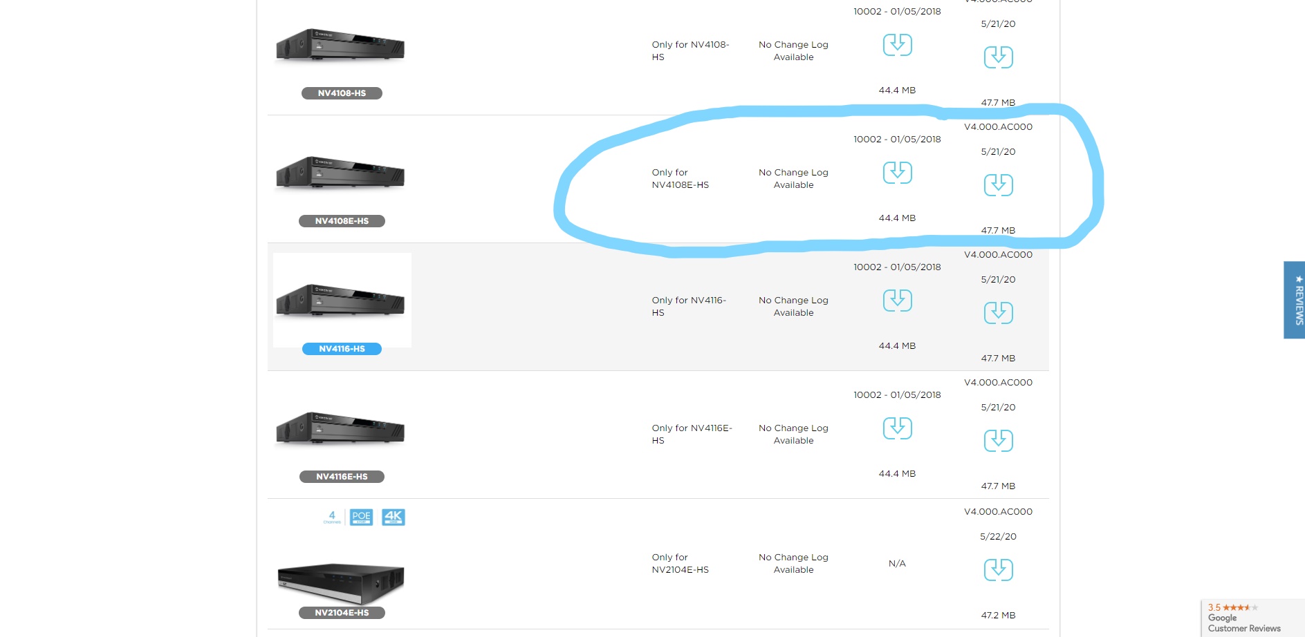

Well as I said on the FW page for the Machine yours is only one that is showing FW for 2020 and 2018 See picture Below
https://amcrest.com/firmwaredownloads
