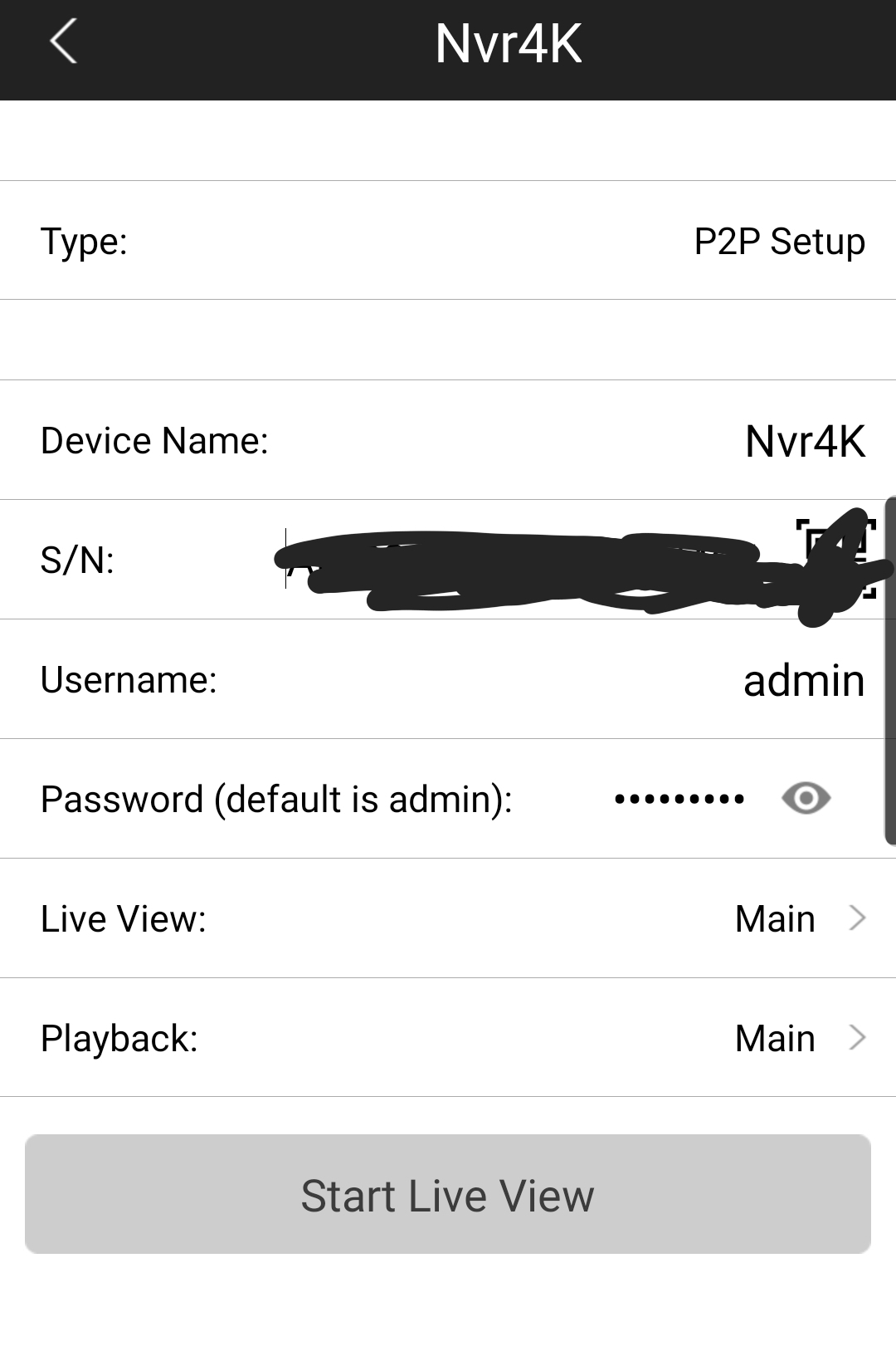

However in the Mean time I would try to bring up your Phone App, Then on the top left click the 3 lines with 3 dots, Then click on the NVR, then press the Pencil then Live view change form Main to Extra on both Live View and Playback Then click on the Start Live View it will save it as that mode... And you should be up and playing if not then you need to check your network cables
Screenshot_20200808-175906_Amcrest View Pro.jpg (144.5 KiB) Viewed 1826 times

I found the settings from your screenshot. I have all the options but "Playback"
