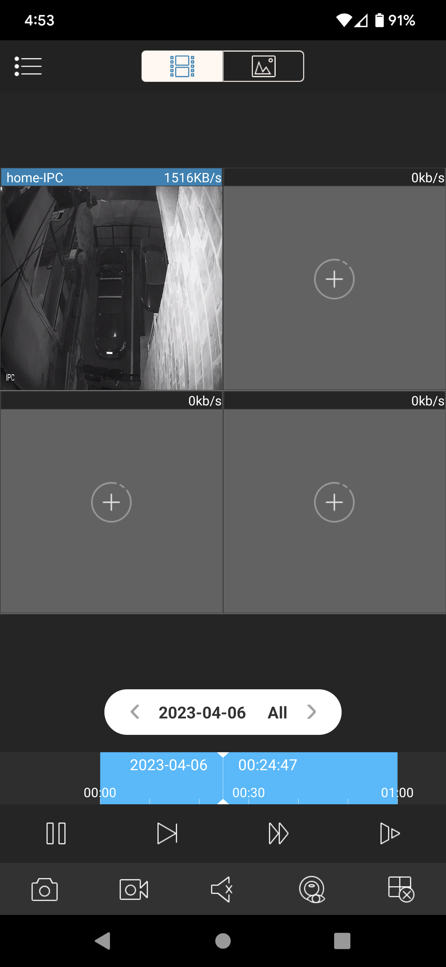

This issue started happening to me a few weeks ago too. Never had a problem until now and this system is several years old now. Live works fine and playback only shows 12am-1am. This is through amcrest view pro, I haven't had a chance to try on a PC

I have been having the same issue with my app. Using a nv2104e. Im not sure if there was a recent app update that caused this but noticed in maybe the last few weeks I was not able to access anything more than the first hour. Desktop app does work when searching so it looks like it's just the app. Google pixel 6 pro. Amcrest app version 4.2.030

If you are reading this and have some issues with playback. Some have said going back to .0024 version of AVP is working for them. So maybe reinstall an older version of AVP. I personally use 30 that is said not to work for others and I don't have an issue. So there has to be something within other phone type or system settings that is making it a limited playback setup. While talking with Amcrest about it they don't have the issue and I don't either so it is hard to pin point the issue until it can be duplicated in one of the support staffs phone. They are trying to find out what is going on and have passed the info to R&D for trying to find the root.
However the people that are offering the idea of installing an older Software are also giving out info about a 3rd party DL site so I personally don't know and would ask Amcrest for the file to make sure there is nothing crafty going on behind the scenes. I don't trust 3rd party DL sites or 3rd party software for Security. Just saying...
