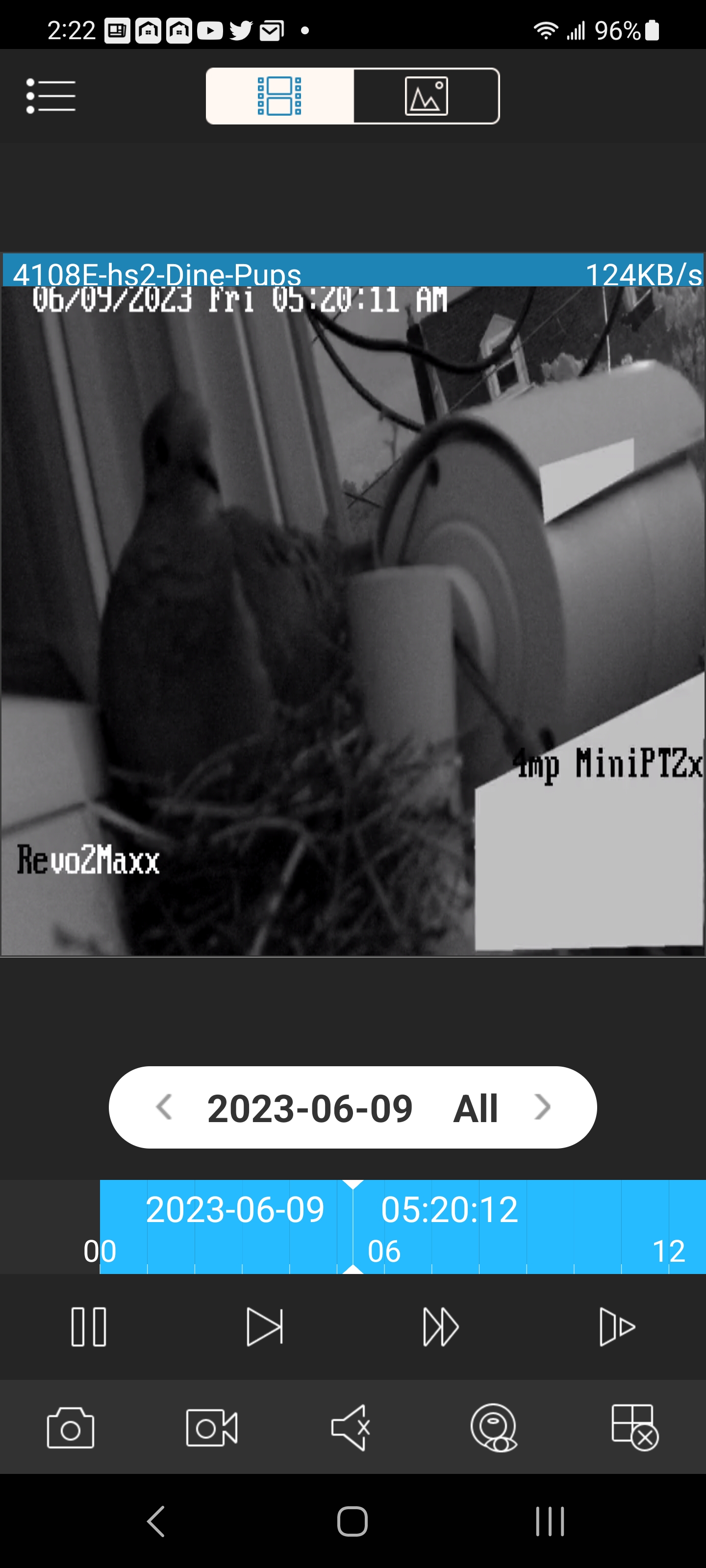

Re: Issue with only 1 hour playback
The issue is you and a few others have an issue on a device that Amcrest don't regulate or have any control over. They work to try and find issues and fix them. As you can see still using the current app release I am able to list and playback all day so far of footage. Amcrest opens their app and they don't find any with same issue as yours how do you expect them to say there is a problem when they can't find a problem.
For this issue it sounds better to make a Ticket and maybe enough tickets they will see there is a problem.
Screenshot_20230609_142212_Amcrest View Pro.jpg (909.22 KiB) Viewed 5935 times

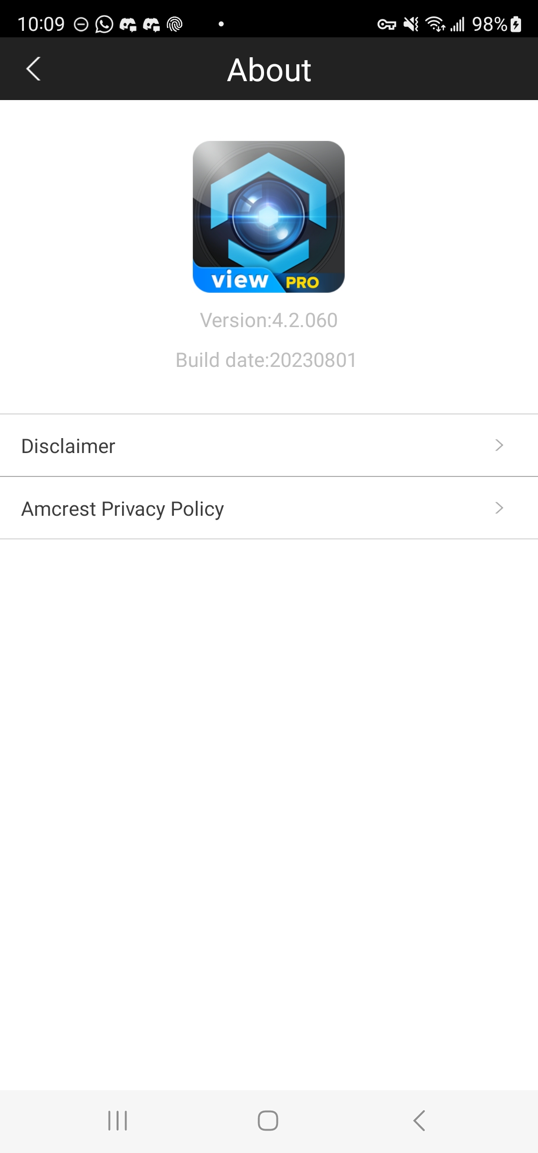

Turbotank
Joined: Mon Sep 18, 2023 9:07 pm
Post by Turbotank »
I'm having the same issue...
Screenshot_20230918_220910_Amcrest View Pro.jpg (152.73 KiB) Viewed 5139 times
