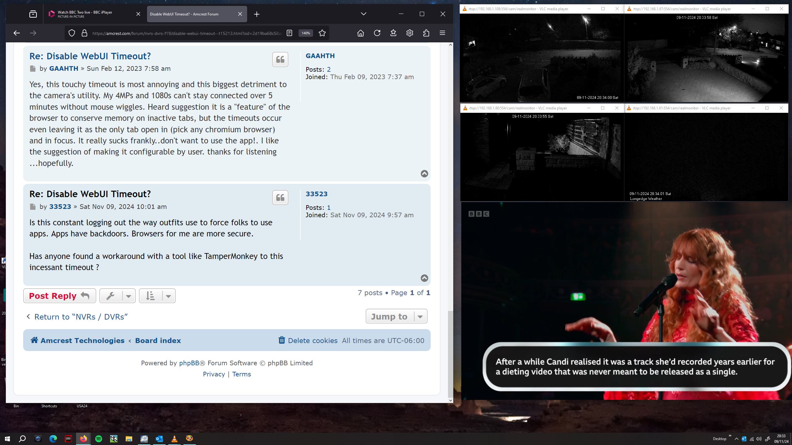

If you need/are using the full webui then it won't be timing out but if all you want is to monitor cameras then VLC is an excellent option. This was my screen a few minutes ago, I've got 4 cameras displayed in separate instances of VLC and Firefox is displaying a TV screen in PiP mode bottom right and a second tab showing the forum. CPU useage on my PC runs at around10% like this.

How do you get VLC to access the IP of the camera ?longedge wrote: ↑Sat Nov 09, 2024 2:47 pm If you need/are using the full webui then it won't be timing out but if all you want is to monitor cameras then VLC is an excellent option. This was my screen a few minutes ago, I've got 4 cameras displayed in separate instances of VLC and Firefox is displaying a TV screen in PiP mode bottom right and a second tab showing the forum. CPU useage on my PC runs at around10% like this.
Please help ?
