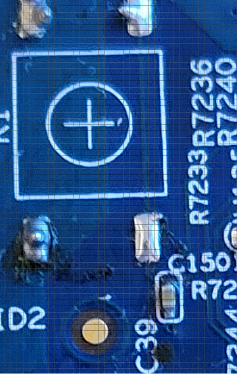

Kind of hard to work on something that isn't in front of you so I don't know and I am going to close this with this. On my 4108E-HS and my 4116E-HS systems I have reset buttons. I asked my son to go look at my 4108-HS and sure enough it don't have one he says. I asked him to take a picture of the board an his camera is broke on his phone from when he dropped the phone so wasn't able to . Asked him to tell me what he see. In about the center of the board going toward the front there is a K1 that don't have a button there and 4 pads. Because I wasn't able to see the board and it is 2500 miles away I told him what was on mine even though both my 4108E-HS and 4116E-HS both don't work the button is there.. So after about an hour of him trying to tell me what he is looking at I took a picture of my 4116E-HS reset button area and sent it to him making sure only to keep in focus the Reset area. After seeing the picture first thing he says is right next to the button is a missing part board showing 2 solder parts.
So with that I conclude that the 4108-HS that your working with most likely isn't only missing a button but it most likely missing a Very small SMD Capacitor don't know the Value however it is very very small like a 0201 or a 0402 I mean it is small... SO I took off my switch seeing it don't work anyway and took a photo so you know what your dealing with. When I sent my son the photo he said that was for sure not on the board either so just doing a jumper from pad 1 to pad 2 or even installing a push button there will not make it work without the small SMD Cap there as well.. You can see in the picture Cap is smaller then the buttons solder pad lol so it is VERY SMall.. The image was to large for the forum so I took a screenshot and reduced the image. C39 on this board is the one i am talking about, don't know what the C number was as I didn't ask him. He already isn't happy about having to travel over an hour away from his place to look at these things lol. Glad he is willing to help..
