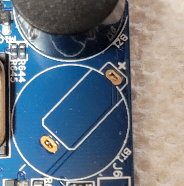

Anyway call him a kid but at almost 40 he is only our kid lol.. So he took a DVR that I have there that is 8ch DVR or 10ch NVR and seeing that I only have 4 cameras there he changed out the HDD from the NVR and next day the NVR to me.. So this is pictures from my 4108-HS and here is what I have done so far today..
@jack7

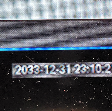

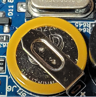

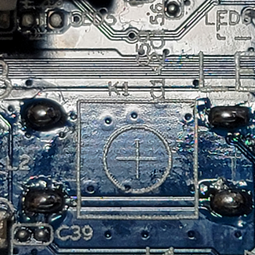

First Opened it up and sure enough the button isn't there Pic1 below, and in that picture as I thought C39 is missing. Next 2 pictures is from the Button Cell, With it there and then after I removed the PCB, removed the Cell from the Board Pic 2 and 3. I then waited a little while and where it is Strange Unlike my 4116E-HS when I removed it's cell and went to 2000 when I took out my 4108-HS battery and turned back on, The date didn't go backwards it went forward.. See the last picture 2033 WTH... I will admit I was even more puzzled to see 2020 when I Installed the Button Cell and returned it to the network. It didn't go to today date it went to 8-2020..
Then to be Clear, It didn't change the system to 2000, I wasn't able to use a App to get code for Dahua devices that one can unlock older systems with codes, I tried the 3 that was generated for the NVR for that 2033 date and that didn't work. Also Tried a couple of other things as well.. Because of the size of pictures and the limit of size uploaded I loaded the images made them smaller and took screen shots to make them smaller.

About that Switch on the board, adding one wouldn't have helped you nor a wire. I hope you removed your mods before you gave it away.. C39 needs a cap a very small one there to make a complete circuit.
