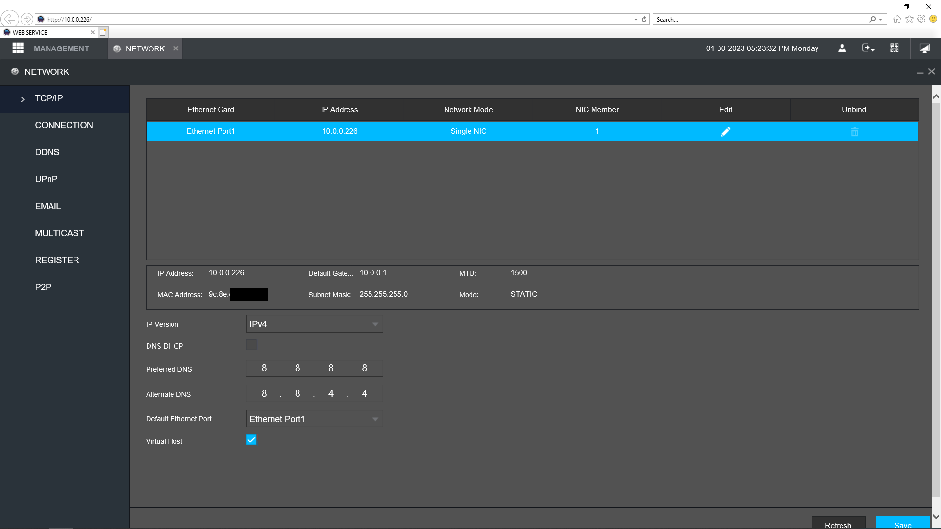

First I don't have the A2, So I am not sure what it has when it comes to Virtual Host... However if I am understanding what your saying is that you have your cameras connected to your NVR's POE switch.. if you look at the NVR's GUI, click on Network, in there I am going to guess that it is like all my other POE NVR's where there will be a Tab that says Switch.. Most times on all my devices anyway it will be setup with 10.1.1.1 and that means it normally hands out by design 10.1.1.65 and up even going to 128 for a camera that might have already been once connected to a different PORT..
So what is needed is that in the network area (For some of my NVR's ) I have what is called Virtual Host and will require me to enable it. THis is normally on the normal network page. Once it is enabled if not already setup like some of my others ones by default

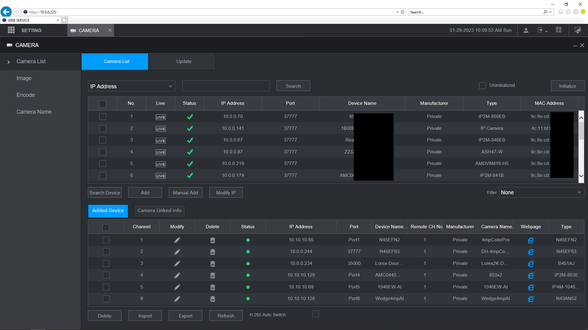

If you are able to connect to the NVR's WebUI. Then you will want to go to Cameras, Then it should have an area below the search box area that shows your connected cameras. In the ones that are connected on POE if you Click on the e or the Browser ICON however it is setup in your NVR in all mine is with an e.. When you click that E it will give you a new Window with a PORT following your normal NVR IP address. So for me it looks like this
http ://10.0.0.225:10080 and it will come up with the log in screen for the camera I am trying to connect to. If you click on the e of one that is on your normal network range then it will just open a tab with that normal IP and ready to log in.. So ones that are connected to your NVR's port should be followed by your NVR's IP with a port #... (NOTE: If you area using Chrome 10080 port will come up as bad and Blocked in Chrome) So in that case if you have more then 1 camera connected you will want to first press the e of a camera you don't want to access right now that is connected to your POE NVR that will bring up the Blocked PORT, Then click on the one you want to really access and it will open 10081 and so on...

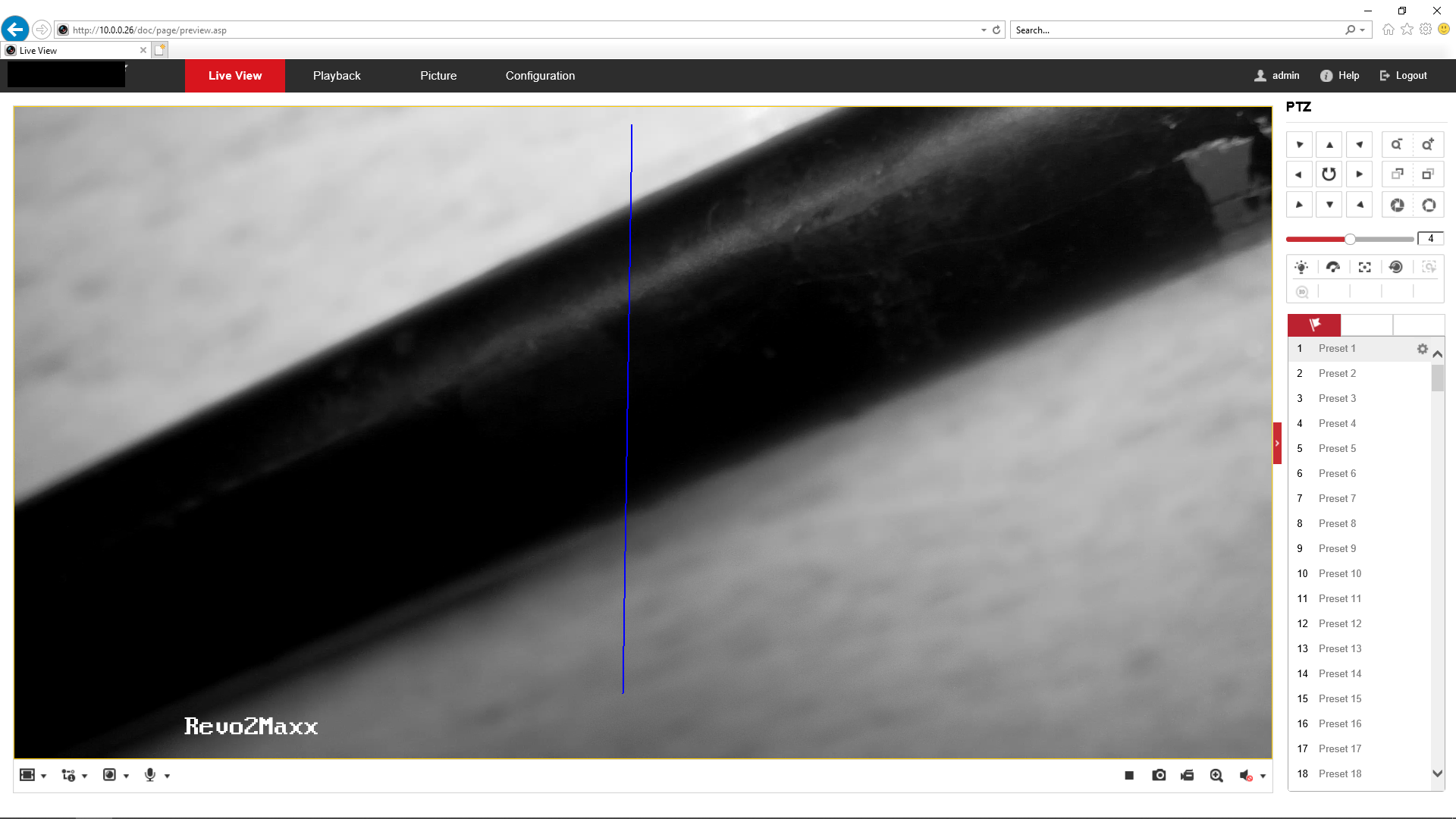

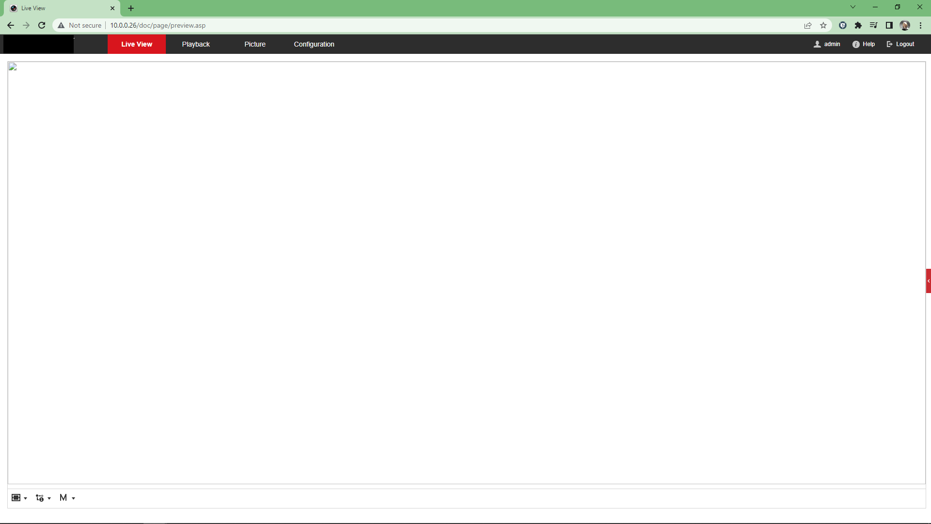

So here is one of my Zoom Hikvision OEM cameras. Because of the area this is stationed I have it zoomed all the way in so the scene isn't what it normally is looking at..
In one of the pictures you can see it is broken link for picture this is using chrome
second picture shows the camera using IE and picture is there. Maybe the camera you trying to view isn't able to run in the Browser type your running also?

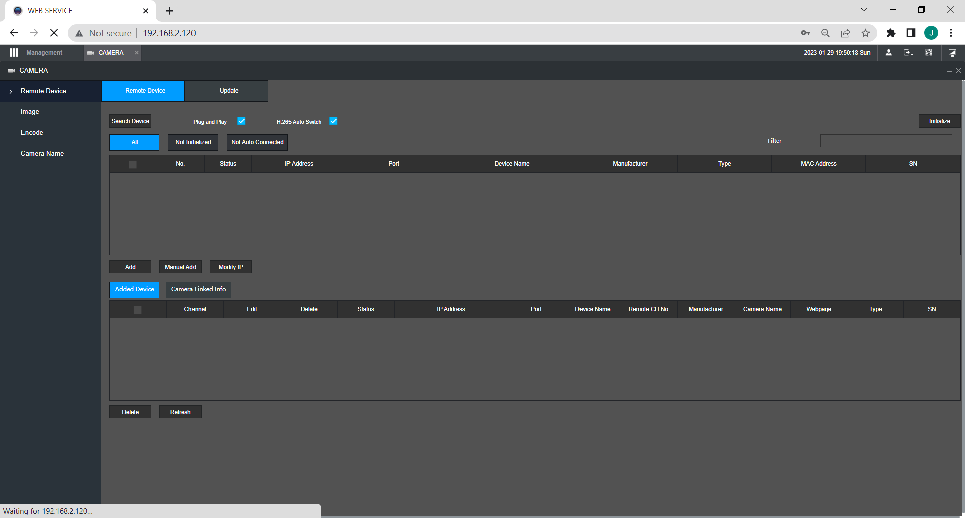

I can't get the cameras page to load when using the computer. I can use the HDMI to set up the cameras, but the attached is what I see when I use my computer. If I click "Refresh" it says "Config File Error" so I guess my factory reset didn't solve that problem.

For H.265, that box doesn't seem to matter if it's checked or not checked. Nothing comes up on the screen.

My picture above don't look like your NVR's WebUI Camera page?. If you click the e next to the cameras in my list that has the IP of 10.10.10.x it will open a new tab with 10.0.0.225:10080 where I can access the cameras WebUI

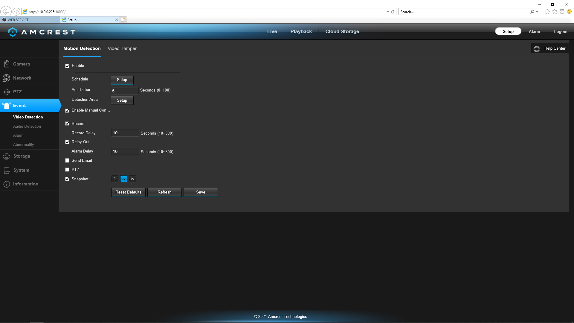

In this picture you can see the Web Service in the first tab, That is the NVR's WebUI. From there I clicked the e next to my 853 camera and this is the Motion Detection window in the Cameras WebUI. and you can see that it is at 10.0.0.225:10080 and that isn't the IP for that camera but that is how I can access my POE cameras that are on the NVR's POE Ports..
