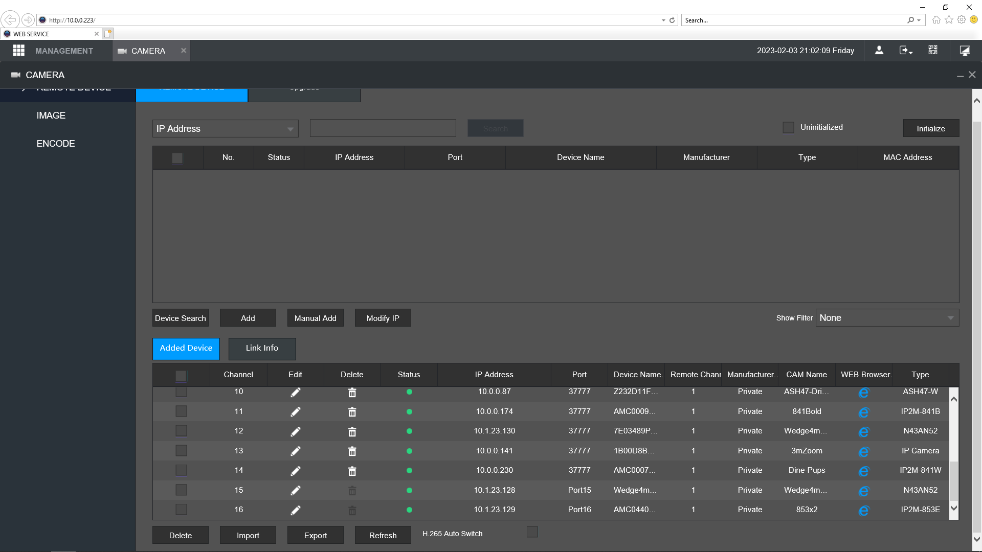

This is form my 4216E-AI NVR. This is only NVR that I own that will pull the POE camera IP though the normal IP range of the Network.. However maybe the newer ones do as well. I don't do it much or often but helps while I have my POE cameras on my Normal Network for making changes that I don't want to make using the NVR's Virtual Host. So I just remove from POE port, connect to my POE Switch. Make changes and still have access to the camera on my NVR Grid.
So if you look at 15, 16 you can see the Trash Can is grey out because they are connected on port 15 and 16. with 10.1.23.xxx Then if you look at my Ch12 it also has the same Range 10.1.23.xxx however that has a normal trash can because it really is coming over my normal port and not the POE of the NVR..

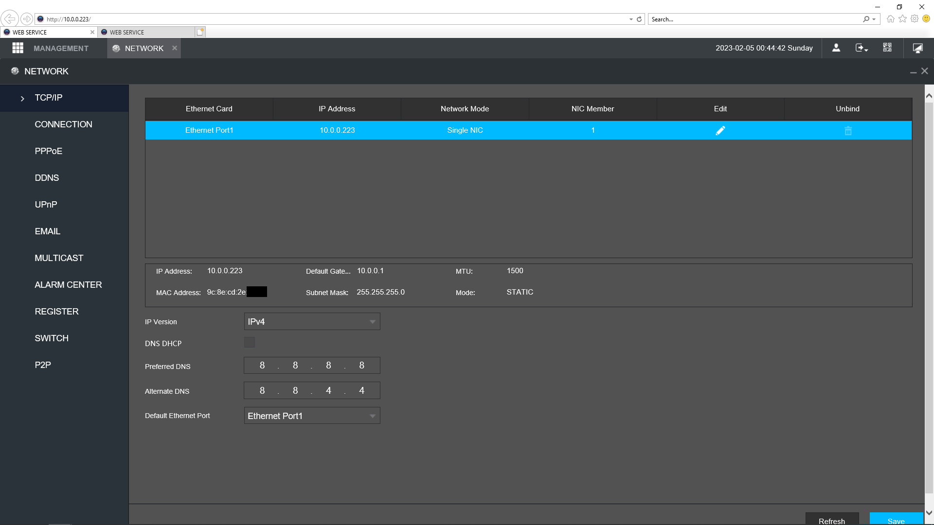

Now as you know as I have said before, There could be a Virtual Host button on your network page. I posted a 4108-HS, These 2 picture today is one of my 4116E-HS and you can see it does have the Virtual host Button. (didn't one or 2 FW ago and now does on the one installed right now) and the 4216E-AI that is 16 port POE that I have mentioned can pull both front and back side IP's however I will admit that I can't access the back side IP using just the 10.1.23.xxx IP I have to go to the WebUI of the NVR, click on the e in the camera connected area picture in my post before this. And doing so will bring up first in the IP of the NVR with 10080 as port number and I can connect and make changes...

4116E-HS with Virtual Host on Network page. 4216E-AI without Virtual host however works by design as if I had enabled it. Might have Enable tab in future FW?
