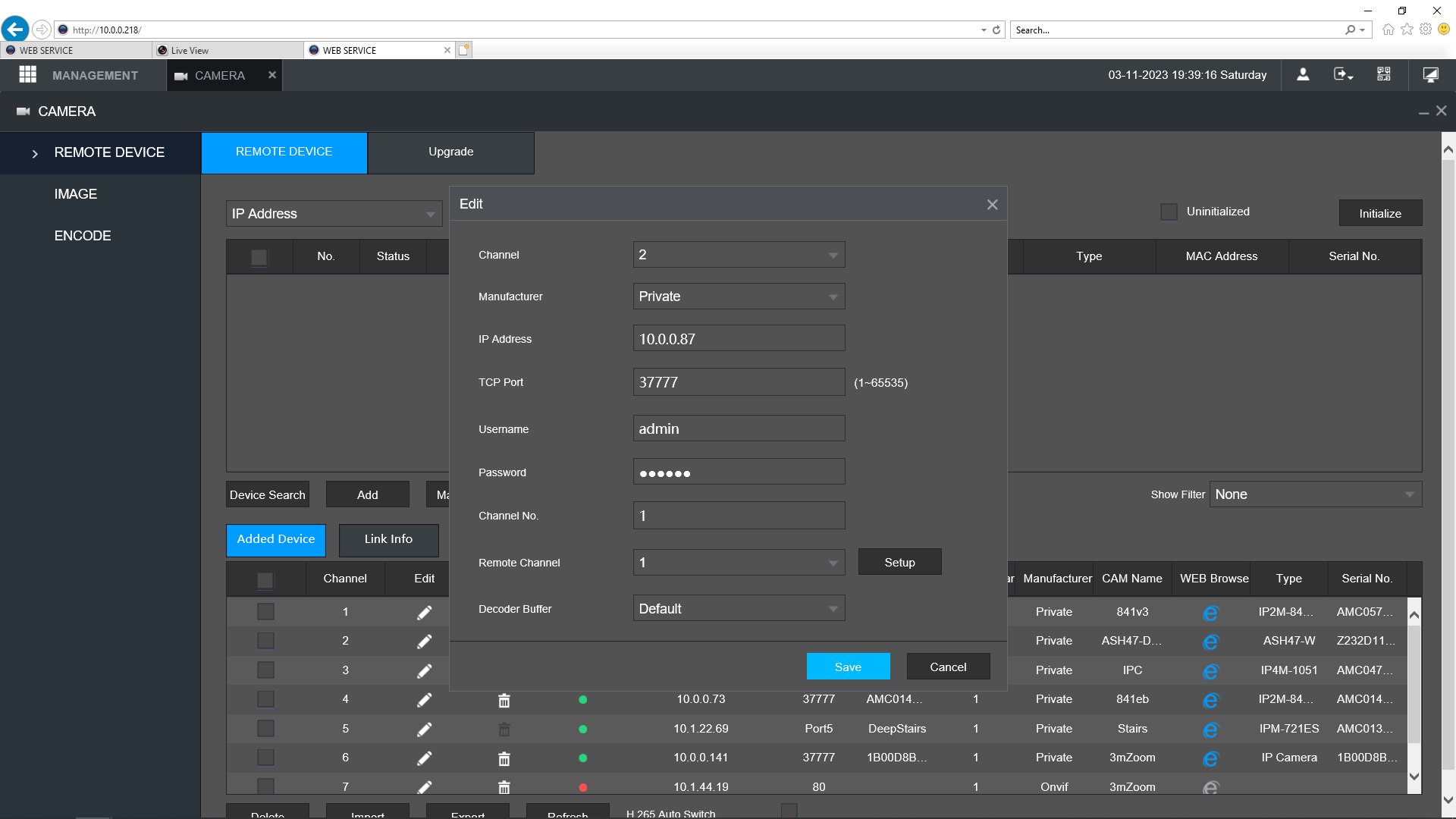

When you are local to the camera and camera IP has a good IP within the range of the NVR there should be no reason it won't add into a Amcrest DVR/NVR using the normal amcrest method of adding IP cameras... On mine here one with the Red Dot is one of my cameras from my Hikvision POE NVR that I put on with bad IP as it won't load using that IP on my NVR because it is out of Range. Good user and password but the IP isn't within the NVR's ability to pull in even though it is on my Switch. The one with the Red line around it is my ASH47 and this NVR is a 4108E-HS and is the same as the 4108-HS just has POE ports on the back..
Screenshot (4190).png (113.87 KiB) Viewed 4178 times

Also the picture from the Web my guess is that would be of the GUI adding of the camera not using the WebUI of the NVR as my NVRs don't have a connect button on the WebUI..

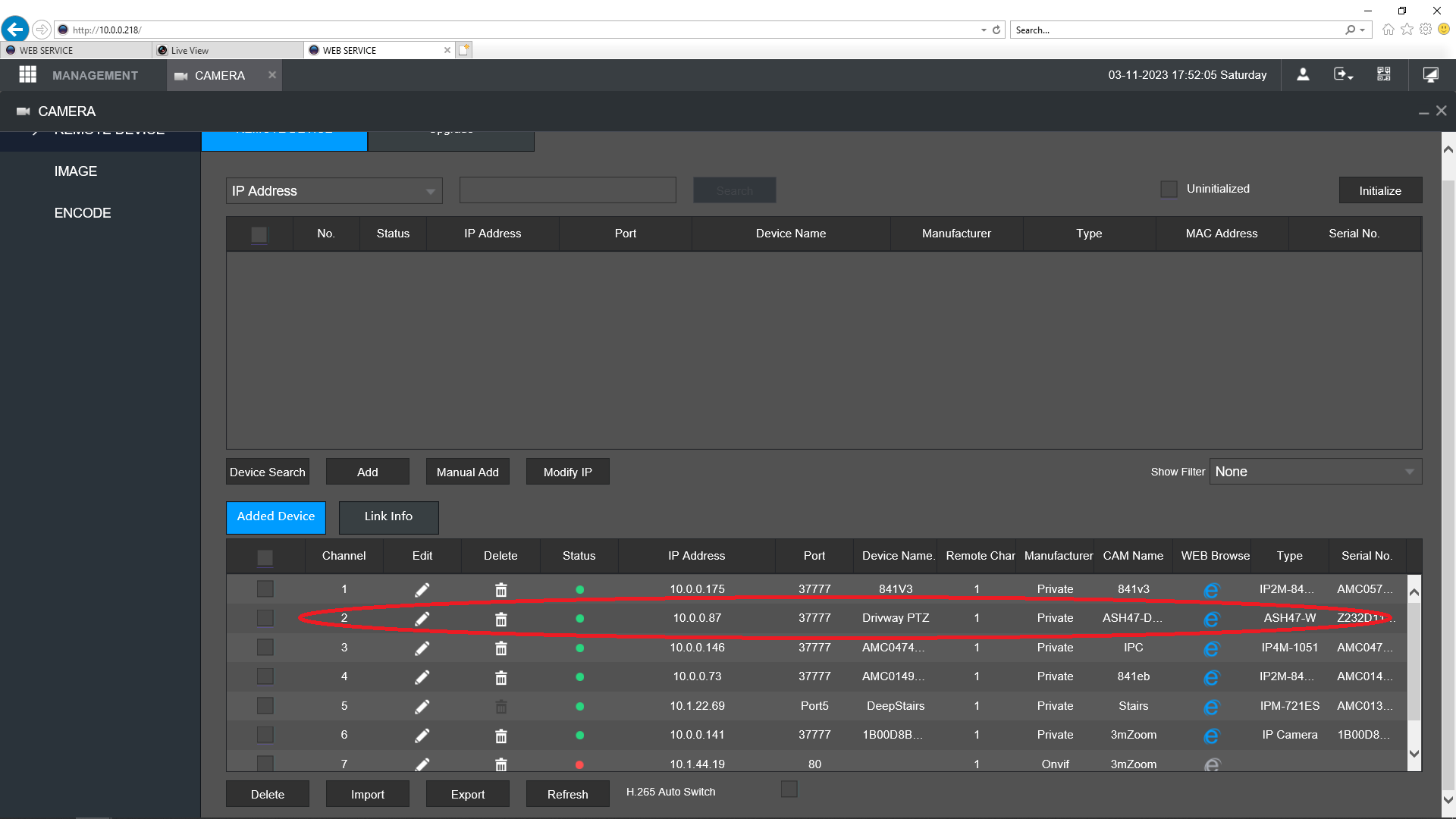

Here is a Picture of my 4108E-HS NVR with 4.0 FW installed.
Screenshot (4192).png (114.15 KiB) Viewed 4175 times
