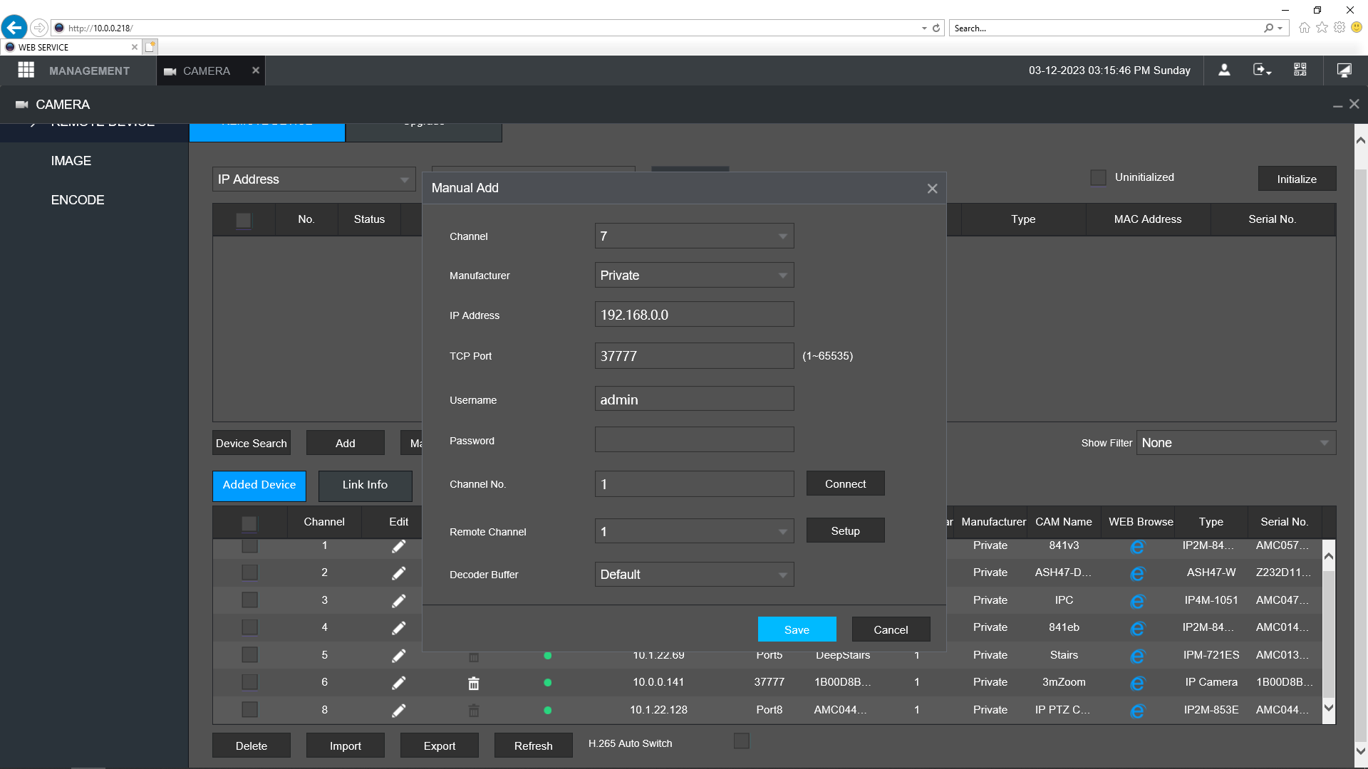

So in Edge, Add it like you normally would. Going to the NVR's WebUI, Click on Management, Camera, then do a search or just click on Manual Add, Then enter the info for the camera. If you do a Search and add that way it will make you think that it is added by it self. I can tell you that it will try to add your camera info as admin admin.. Once it comes up if done that way then go to the pencil and change the password.
Doing it the Manual way type in the IP for the ASH47 and then enter the password is only thing that should need changing to meet your cameras info the rest of it stays the same.. The Manual Add should look something like this..
Screenshot (4239).png (111.21 KiB) Viewed 3177 times

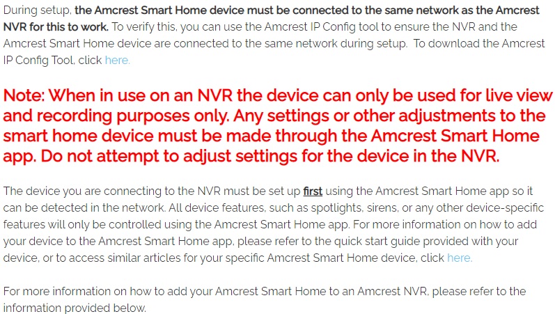

I'm fascinated by this particular problem. Everything I've read leads back to the camera needing to be initially set up via Smart Home before anything else about it will work properly with anything else.
Provided that...
Everything is on the same network -- including the wi-fi. I'll go a step further just to be safe. Everything should be on the same subnet unless you are an advanced user. If you have a wifi router spitting out 192.168.0.0 addresses, that's what the camera is going to get. If the NVR network is operating in random 10.x.x.x address space being provisioned by a different dhcp server, that's what it wants to see and will try to assign to the camera. And If everything is indiscriminently bouncing around on a 10.0.0.0/16 netblock, it will need a 255.0.0.0 mask to handle all the possible subnets.
Authentication at each level just needs to be correct, not necessarily the same. The auth credentials required at the NVR for recognition of the camera are the username and password of the camera as initially established when setting it up in Smart Home. The login for the NVR is the login for the NVR, not the camera. Pretty simple "forest for the trees" type stuff'.
If this doesn't say it loud enough, turn it up to eleven! (Or return/exchange the camera for a replacement and try again with a new one.) Good luck!
https://support.amcrest.com/hc/en-us/ar ... mcrest-NVR
