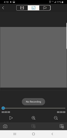

I also receive notifications on my Amcrest View Pro android app but when I open the alert there are no pictures/snapshots shown under the picture (center icon that looks like mountains with a sun). However there is a one minute clip that plays under the video icon (left icon that looks like a splice of movie film). The problem with the clip is the detected motion is not shown until 30 seconds into the clip. The clip is no problem when connected to wifi. But when connected to data plan (LTE/4G) then the first 30 seconds uses data up on my limited data plan.
Why don't the snapshots show up under the center icon?

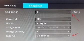

Yes Here is some info you will want to check even though it seems not a needed thing seeing the NVR no longer can view Snapshots don't know why lol but it don't have that options in the new FW...
So Right click, Main Menu, then at the Bottom click on Storage, then on the LEft click on Record, then make sure all your Snapshots are Enable... Then go to Schedule and then click on Snapshot. Then in Channel drop down PICK ALL Change out Regular AKA Remove it for all days of the week and add in MD only Remember to pick all so you don't have to do 1 day at a TIme... Then save... Right Click to go back to Menu click on Alarm then click on Video Detection. Then you will want to click on Picture Storage, Pick 3, then save, then bottom click on Copy and choose all then save and double check that they are all setup for Picture storage...

Alarm-Video Detection-Motion Detect...Revo2Maxx wrote: ↑Thu Dec 10, 2020 7:02 pm So Right click, Main Menu, then at the Bottom click on Storage, then on the LEft click on Record, then make sure all your Snapshots are Enable... Then go to Schedule and then click on Snapshot. Then in Channel drop down PICK ALL Change out Regular AKA Remove it for all days of the week and add in MD only Remember to pick all so you don't have to do 1 day at a TIme... Then save... Right Click to go back to Menu click on Alarm then click on Video Detection. Then you will want to click on Picture Storage, Pick 3, then save, then bottom click on Copy and choose all then save and double check that they are all setup for Picture storage...
I only want motion detect for channel right now. I have set Picture Storage and Snapshot=3 on all channels but Send Email is checked for only channel 1.
I have these set for all channels.
Anti-Dither: 5
Post-Record: 10
What do you have them set to?

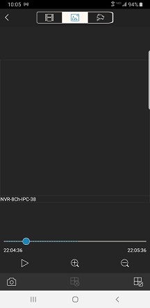

I have applied your suggested changes. I still get email but with no attachment. I have decided to turn off Send Email because 1, the Amcrest View Pro (AVP) app notifies me and 2, if there is not email attachment then email is just a waist of data on my limited data plan.
Before applying the changes, I had Alarm-Video Detection-Motion Detect set with both Regular (green) and Motion Detect (yellow). In AVP app, when I opened Push Notifications-Event List and selected one of the events. the center icon is selected by default. The blue dot will travel from left to right but no pictures will show. After I removed Regular (green) and left only MD, the center icon shows 'No Recording' Something in the NVR is still not right. I have tried changing setting using the NVR console, browsing to the NVR webpage using Internet Explorer and connecting to the NVR using Windows Amcrest Surveillance Pro. I can't find anyway to view the snapshots.
I should mention that the NVR is connected direct to my LAN router, which is connected direct to my provider's fiber-optic modem. I have no bandwidth problems. Also the NVR is setup DHCP (WAN side) and does not have a static IP, but my DHCP server has a reservation that gives the NVR the same IP address each time the NVR powers up.
What do these setting control? How are they different? Thank you,
