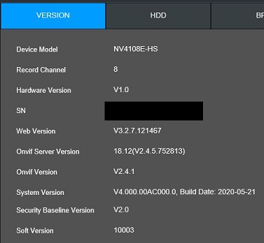

Screen shots of my NVR.

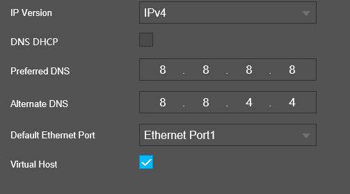

The VH setting was on by default. The latest user manual (ver 1.0.5, November 23, 2020) page 56 shows the VH setting but does not explain what it does.
From what you describe, should be able to access the camera(s) settings from the LAN side of the switch?
Maybe VH mode is causing snapshots to not work?

Went to post and seen your new post about VH
Not sure that is related.. That is just an ability to access your POE camera from your network side without having to have a crossover cable in place on a open port...

VH mode question
The IP address of the LAN side of is 192.168.xx.123.
The channel 1 camera's PoE address is 10.1.1.1xx.
What IP address do you enter into the browser to get to the camera?

So I am not 100% sure for your NVR as they can be different and here is something to try anyway...
Let say your Home network is 192.168.0.1 Is your Router IP
Let say your computer is 192.168.0.51
Lets just say that your NVR is 192.168.0.123
So just as your NVR is try adding 65001 for CH1, and 65002 for Ch 2 and so on.. So maybe 192.168.0.123:65001
I would guess that if that didn't work then maybe if you ran Nmap on your NVR Ip it might tell you all the ports that are open just make sure that you setup the TCP port count high enough to maybe read upto 80000 should be high enough to get to what port would open what camera
