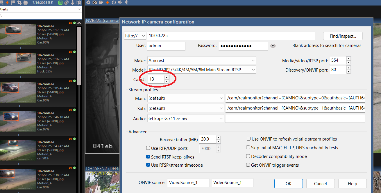

Yes in BI you can add your cameras from NVR 1 or all you just have to pick the cameras you want to add when you do a search for your local NVR IP address.. So like on one of mine 10.0.0.225 and that is 16 ch, I use that address and I do a search. Then it will come up and ask what camera number you want to add do that for all you want to add...
Re: Blue Iris and NVR NV4116E-A2
Here is a picture of my NVR adding channel 13 for my shed..That is where you make the channel change in the red area..
Screenshot (531).png (320.64 KiB) Viewed 3544 times

YOU ARE THE MAN!!!
(60YO grandpa here... thats a COMPLIMENT in my world. Please take it as such. :mrgreen: )
I couldn't figure out WHY linking to the NVR only showed camera 1. :? :lol:
