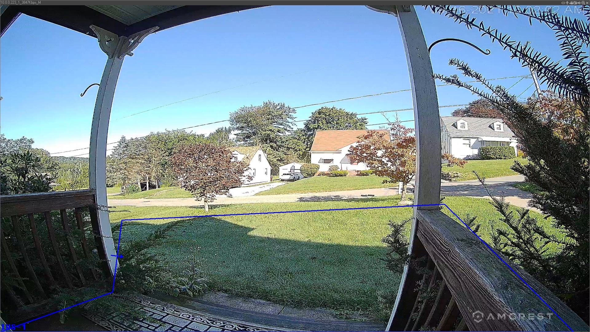

Right now I have my 410 on my Amcrest 4216E-AI NVR and I will tell you that one of the great things with the 410 connected to my AI NVR is that it adds a rule into the IVS as Intrusion. So for Human detection you make a area you want it to protect when connected that shows up in the 410 window..
