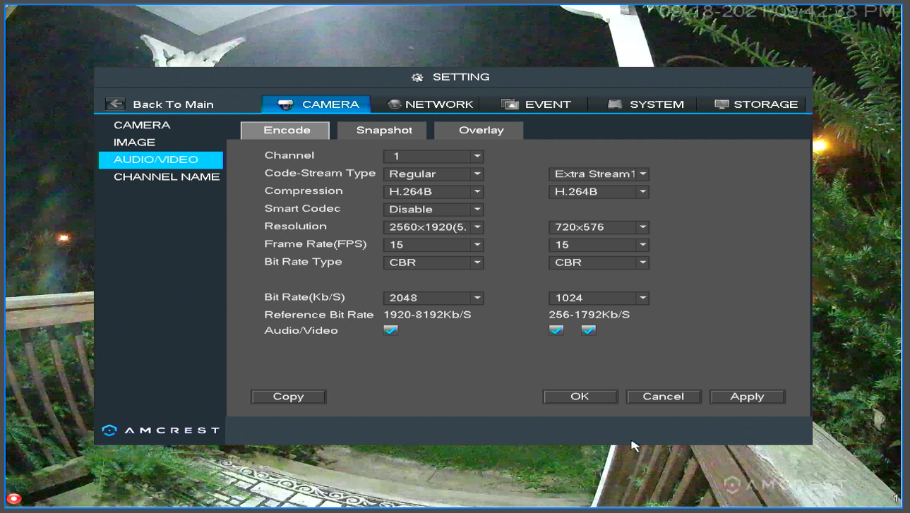

Just to be clear the 410 should load on a recorder as 2560x1920 and FPS of 15 that is all it will work at if you try to pump it up it might not work something to look at
Screenshot (1103).png (960.58 KiB) Viewed 4346 times

What Software are you running on your NVR? You on the NEW 4.0 or on a 2018 or older FW? As you can see in the image above that is from older FW the newer one looks more modern.

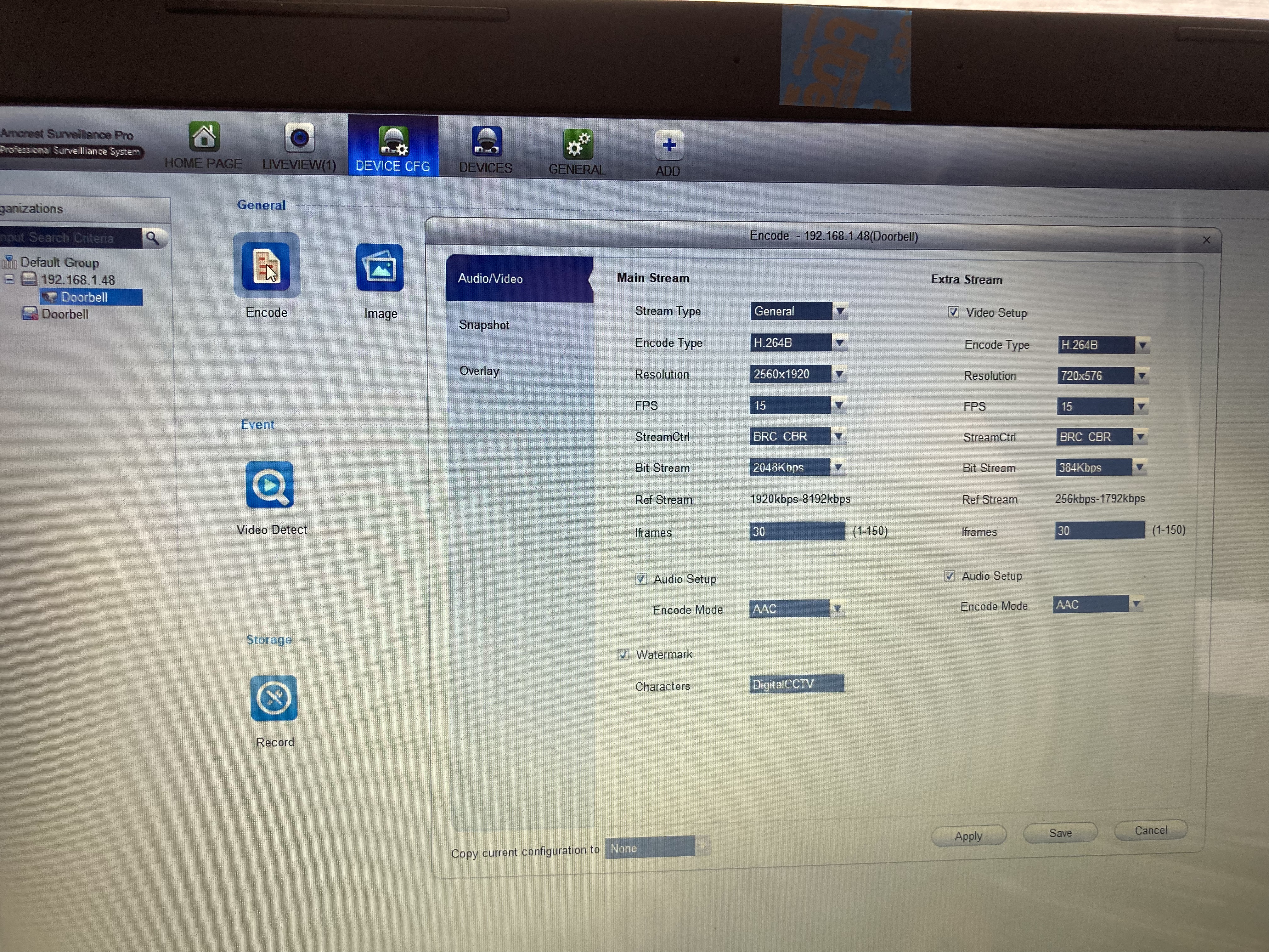

It is a 4108-HS. I upgraded the firmware to the 4.0 version. It did have the 2018 version. Much different interface but same issue. I am able to connect to Amcrest Smart Home and Amcrest Surveillance Pro. I can view and manipulate video and settings in both. I will try to attach the encode info but it looks much the same as what you posted. I also changed the sub streams and it did nothing. I have contacted Amcrest and in the end they sent me a brand new doorbell but it has the same issue. That is why I came to the forum to see if others experienced this issue. You’ve had way more ideas than they did. I am still trying to isolate both doorbell and phone to 2.4 ghz and factory reset the doorbell maybe tomorrow.
