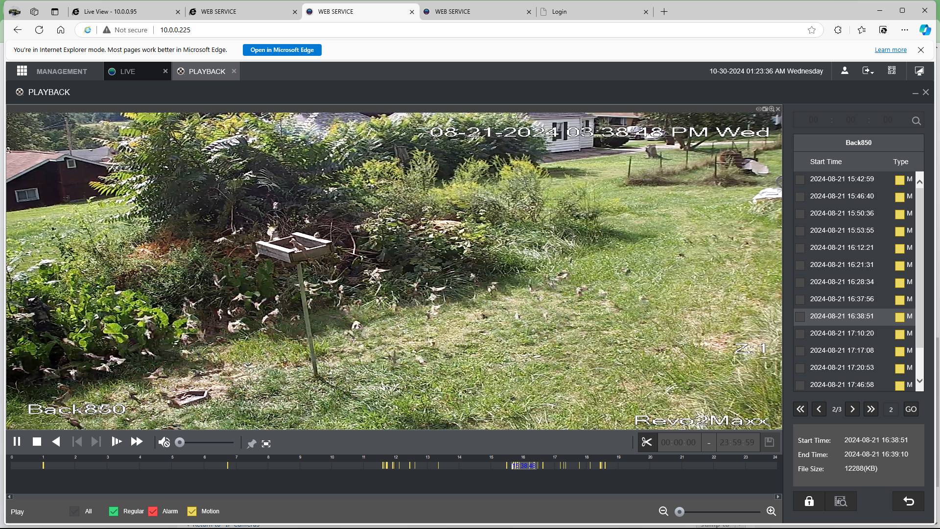

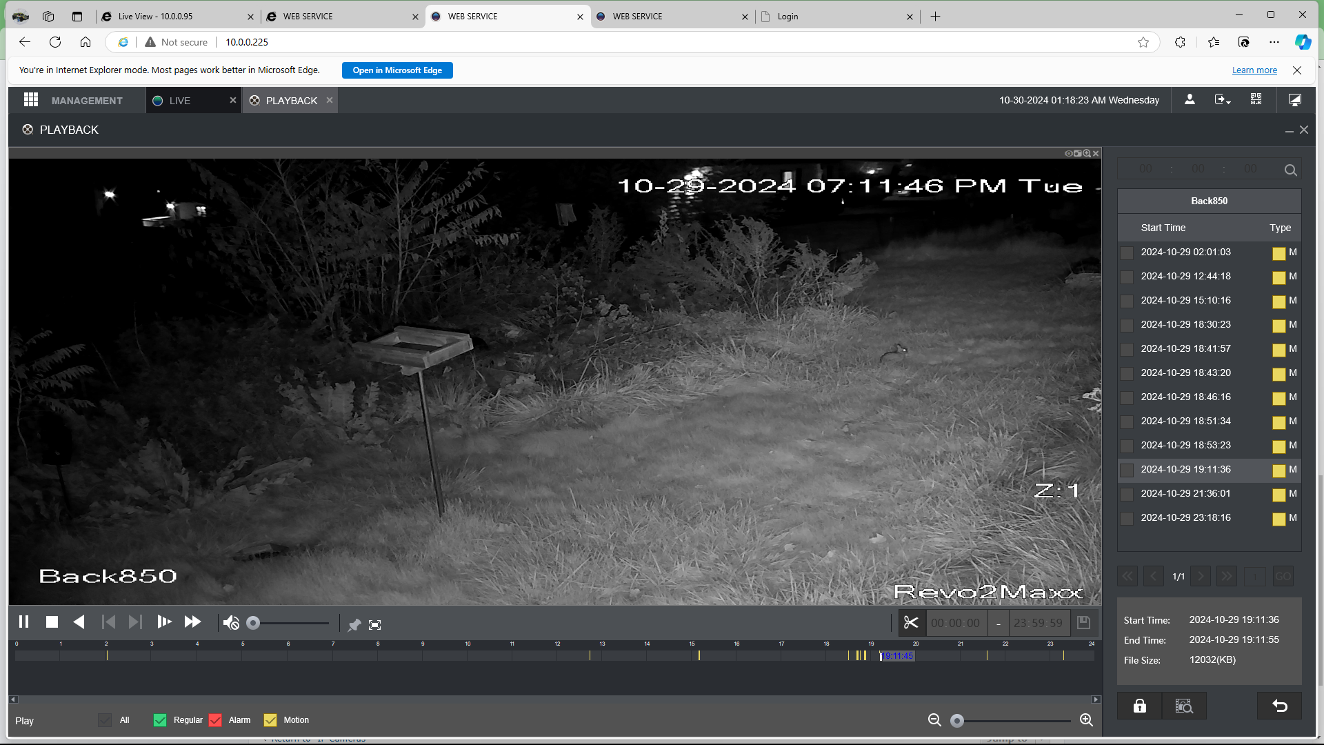

Living in a bug-prone area, I've noticed that the number of events recorded is often related to weather conditions. For instance, yesterday's events showed fewer instances, while in August, most activity captured was due to wildlife, especially on rainy or active days.
It seems like the model 2796 camera may be overkill for your needs. AI cameras primarily help reduce false alerts compared to regular cameras, which might be all you need. Additionally, be cautious about over-customizing settings. For example, I’ve positioned my camera’s motion grid only around specific areas of interest, such as a bird box and the ground, to avoid unnecessary alerts from wind or unrelated motion. My camera has PTZ capabilities, but that isn’t its primary use.
If you’re experiencing issues, try resetting one camera back to factory settings. This can often be done remotely. When you factory reset a camera connected to the NVR, you'll need to refresh the camera page a few times to ensure it's recognized.
I recommend downloading ASP from https://support.amcrest.com/hc/en-us/ca ... -Downloads. ASP allows you to access your NVR and make changes using the NVR's WebUI. Note, however, that a direct reset may not work if the camera is connected to the NVR itself. If the camera connects to a regular network via POE switch or 12V Ethernet, ASP can perform a reset remotely. If not wait until you are back at location to reset camera
After resetting, log back into the camera, especially if you use IR from an external blaster or other cameras. To access the WebUI, log into the NVR, preferably using Edge in IE mode. Navigate to Management, then Camera, and select the camera by clicking the ‘e’ icon beside it. If using Chrome or standard Edge, you might see a security warning—Edge in IE mode is recommended for smooth access.
Once logged in, go to Setup, then Camera Configuration. Under Illumination, you can turn off IR to keep the camera in B/W mode at night. If you prefer black and white at night, leave the day/night setting on Auto, with IR off, to allow IR blasters to assist with night visibility. Apart from these tweaks, keep most settings at default and make incremental adjustments if needed over time. For best results, configure the motion grid and ensure recording on the NVR is enabled, then leave other settings as they are.

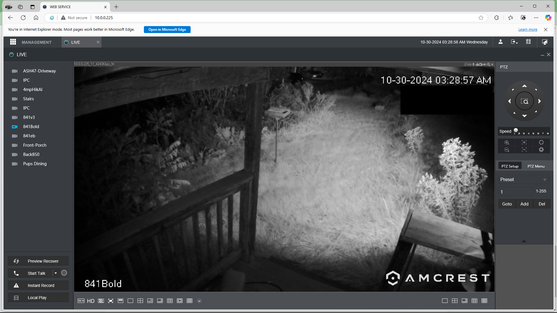

Also here is a picture of one of my 841s that I have on my sheds back deck. While I do have IR on in this camera. There is enough light from other cameras in the area that the 841 IR don't turn on.. So if you happen to have enough IR the camera might elect to not even turn on your IR. However just to be safe it is best to turn it off when using IR Blaster or other cameras IR..
