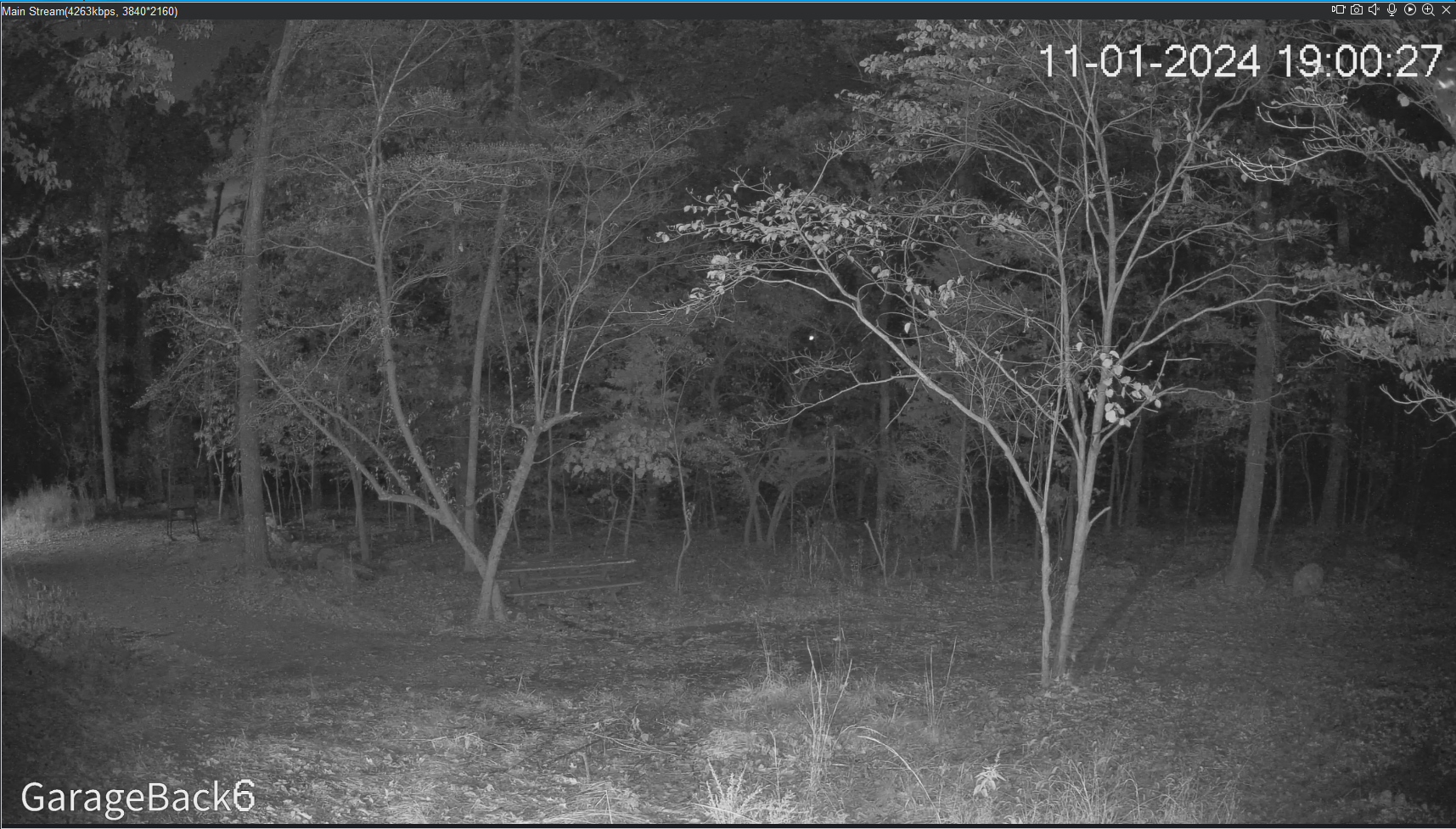

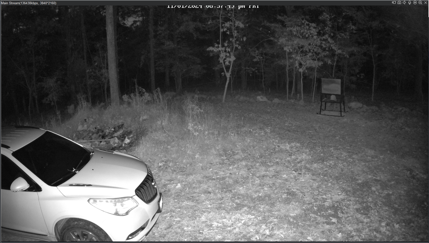

I posted 2 more pics before any bugs come out and these seem to be perfectly acceptable night shots as far as I am concerned. Should I be looking for something that I am missing? Again, property is pitch dark. I am willing to change, if need be, to better cameras if necessary, like the 1/1.2 and a F/1.0 but not sure if it a need. I need to educate myself some more I guess.

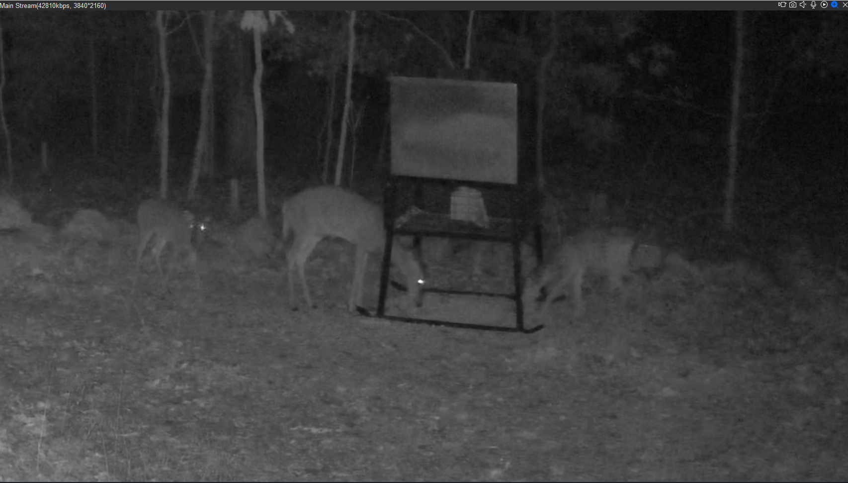

Right after I posted those last 2 screenshots, some deer walked up to the feeder and I zoomed in and took a screenshot. Posted just for fun and clarity of picture.

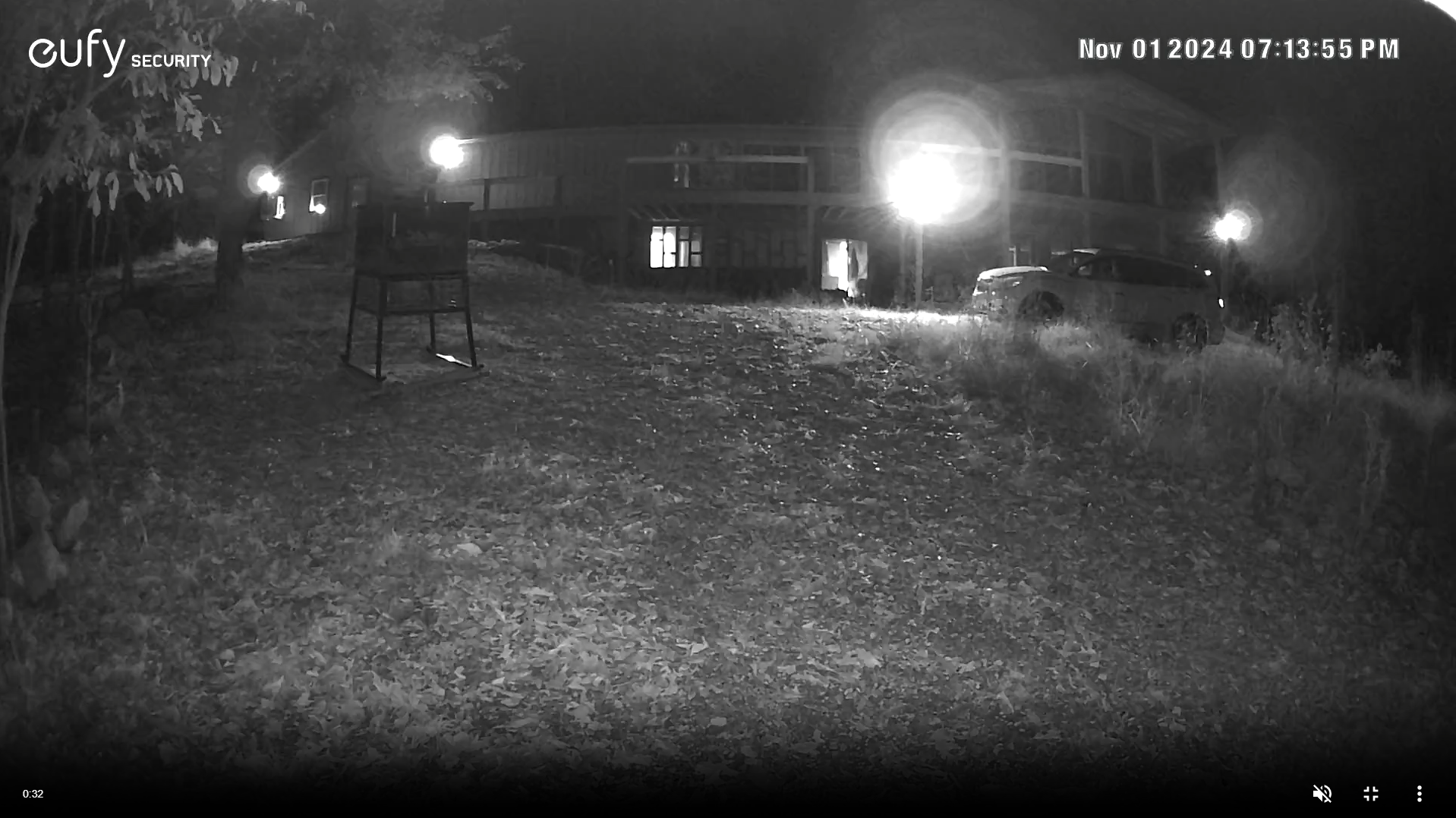

Figured I would post 1 more of how the IR from Amcrest cams blanket most of my backyard, as seen from wireless cam pointing at the feeder/house. Currently there are 5 Amcrest cameras in backyard instead of the usual 4 as I am experimenting a bit. It's hard to see the 5th IR but there are 2 on far left, 1 up high, the other in a window pointing more away from feeder. So that is my version of sprinkler/overlap

What type of IR illuminator are you using for the Eufy aimed at the garage?

Here is the description of the blaster from Amazon.
AUTENS IR Illuminator 850nm 12-Led Wide Angle IP67 Waterproof Night Vision IR Infrared Light for IP Camera CCTV Analogue Security Surveillance Camera
I also bought one that is 6 LED and it works well too, just not currently in use anywhere.
Univivi Infrared Illuminator, 850nm 6 LEDs 90 Degree Wide Angle IR Illuminator for Night Vision,Waterproof LED Infrared Light for IP Camera,CCTV Secur
