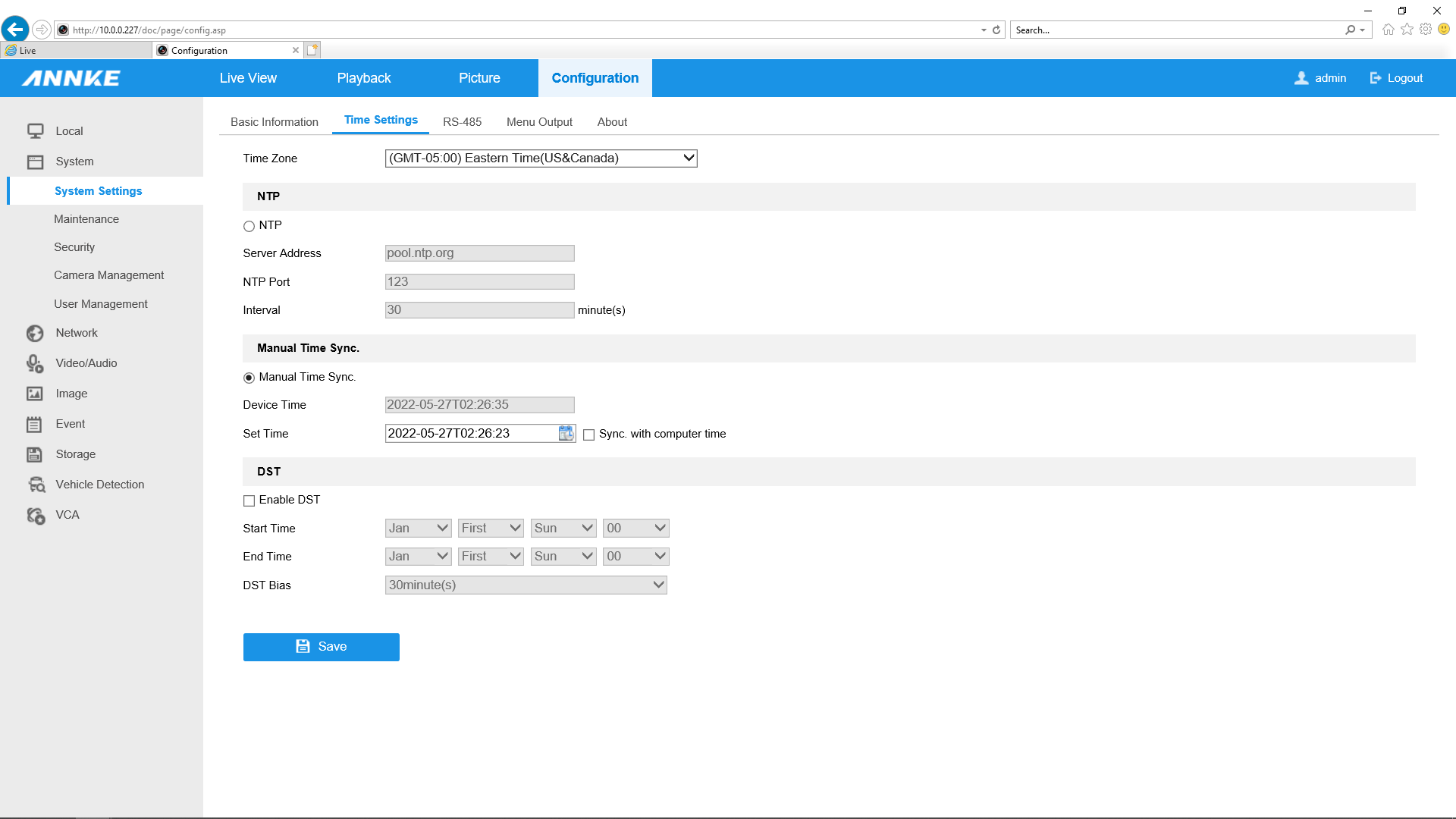

Well to be honest I am not sure that will work. I know it took me some time to figure out the right way to make it work..
Here is what I will say looking at worldtimebuddy dot com it says it is 4 hours from GMT to EST so that is one way to fix it turn off DST and change to -4
Do you use the WebUI Often? I mean if you do then I would personally just keep the Manual setup for Computer and every time you log in it should pull the time from your computer time to keep it on the right time..

So after writing I left my system run. I did have 2 cameras connected but took one off in case it was updated by NVR that it was also connected too wouldn't mess with the testing.. I have NTP and DST off and the times have been good all night. Now I will admit that I had it unchecked for sync with computer because I wanted to view the time difference and just in that short of Time it did drift off 30 seconds. So keep in mind that the reason to even have the Time Server is to keep the time on time the crystals that keep time in the devices are as close as can be for keeping them going however they do lag some..

So about the DST, and NTP being turned off has kept the time close to all my other device times. ALso looking at the playback on search comes with right times. So for now that is best way to keep it working on the right time. Come next year when the DST is no longer a thing in the USA anyway there might be some new challenges.

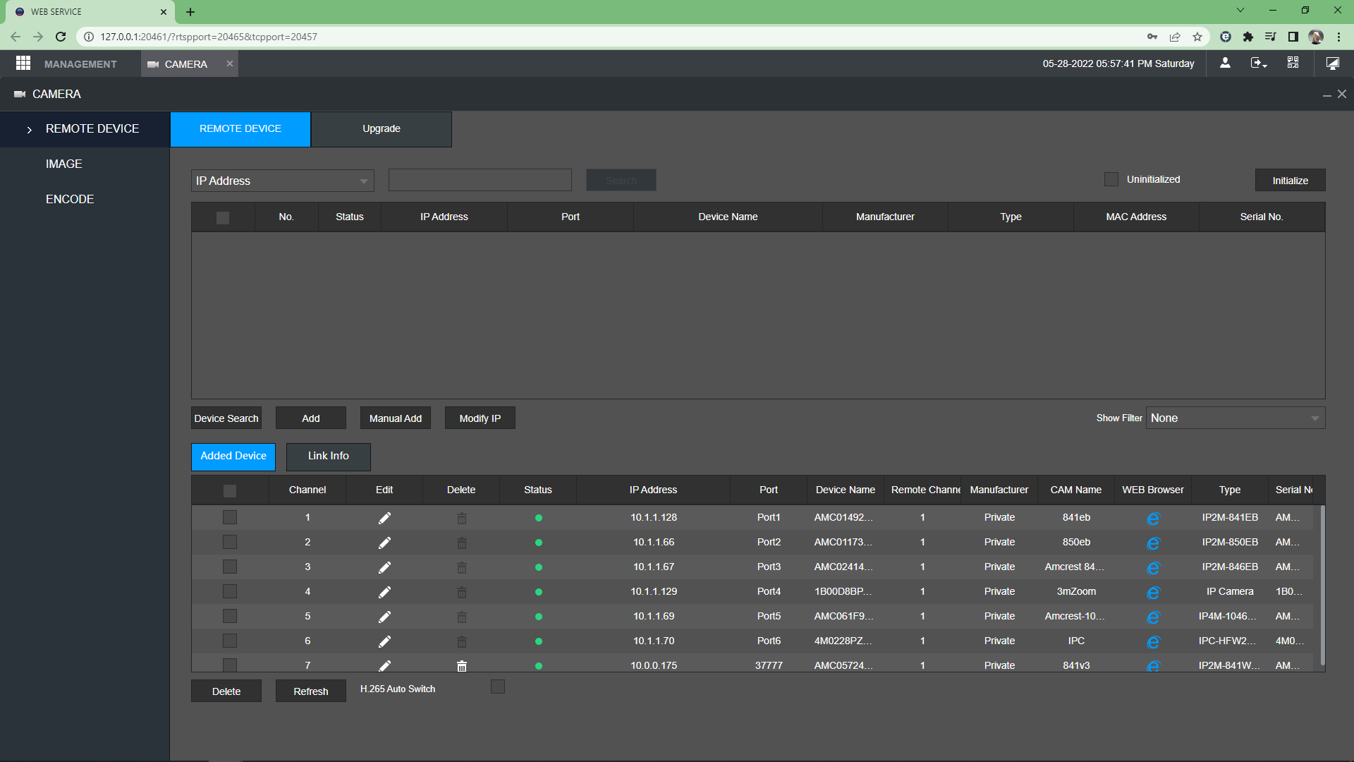

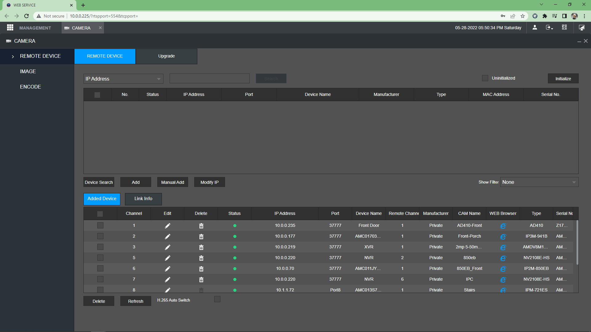

Thought I would show one that is remote connection also if you look at the first picture and the second picture you will see that the cameras in the first picture most of them besides ch8 are all installed using my normal Local IP however on 8 that camera is connected VIA Port8 IN the second Picture of another one of my NVR's you can see that all ports but 1 have no trash can and have port numbers that is because they are connected to the POE ports. For access to the cameras outside of the NVR it is best to use WebUI to access the camera over the V Host of the NVR by doing so it will load the NVR's IP address with a Special Port for the camera most times it starts with 10080
