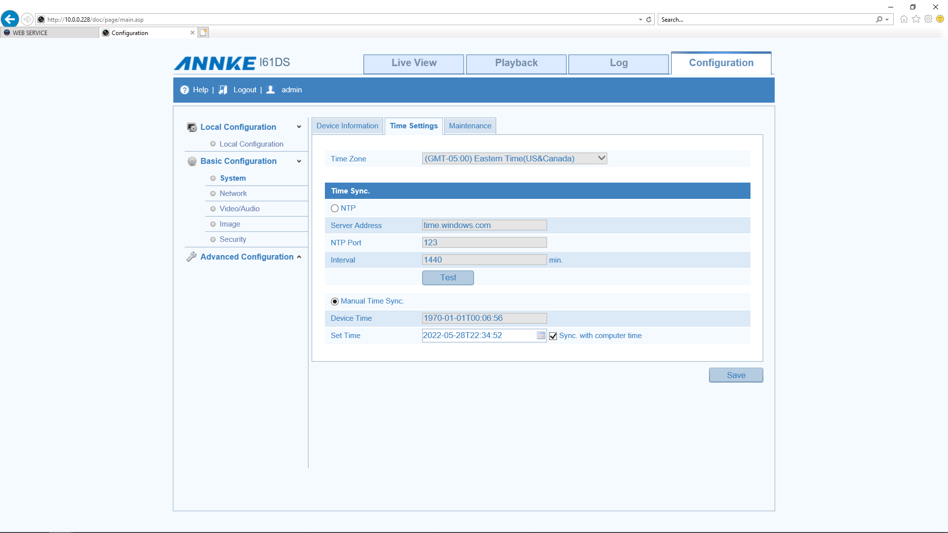

I connected one of my old Annke IP cameras that is like the 841 to a degree lol. I mean it has Alarm in and out and audio in and out like the 841 does and built kind of like it. Anyway I thought I would connect it to see what is going on (no updates as I said Annke don't do them as a norm) and the date was all the back to 1970 lol so that means that the Clock battery is dead. Not that I expected anything less it is kind of an old camera..

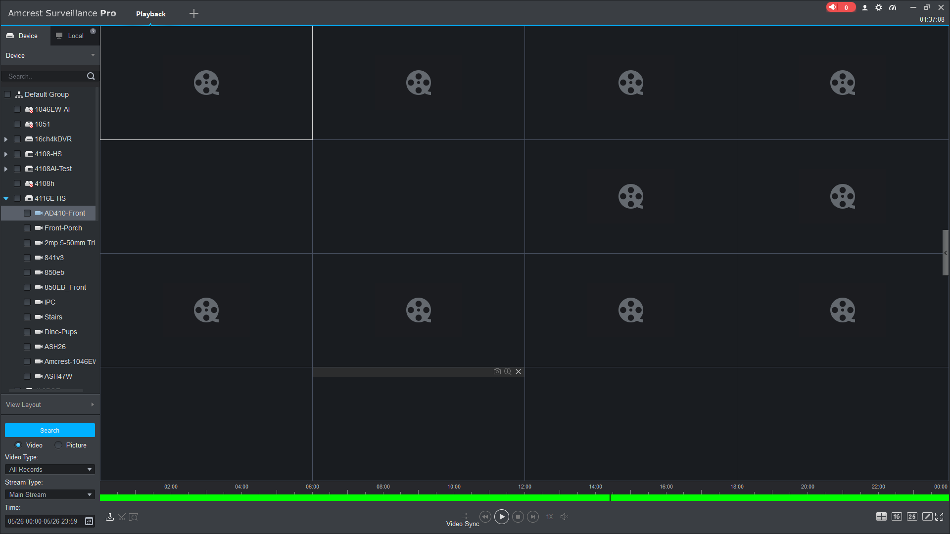

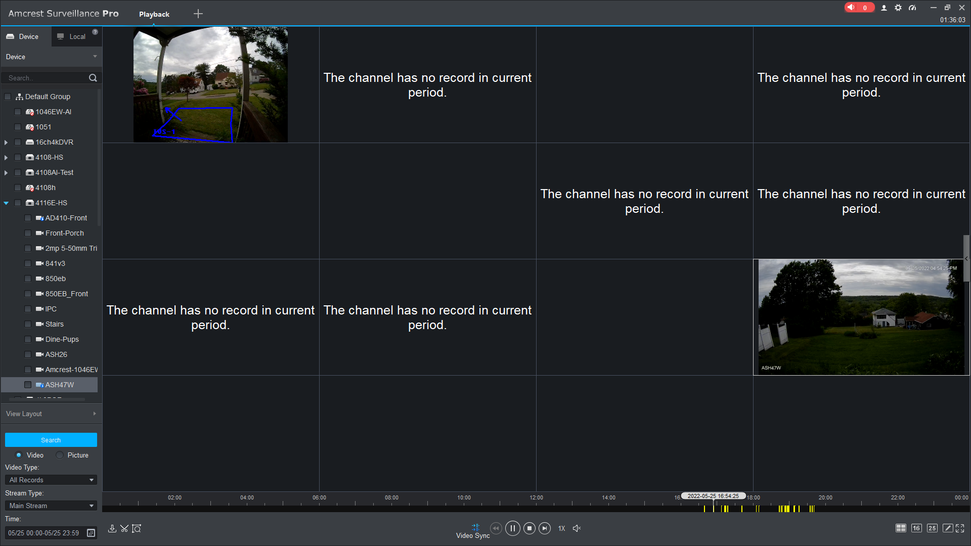

So I did a couple of searches and one was in a playback I have different type of Recording types for most of my cameras if they were all on full time like my ASH47 and my AD410 then they would have been running as well however when I press the Sync for video only 2 showed up and others were offline with message now when I did a search for that day not all had events the next day I choose I had more events on more cameras and so I wanted to show what it will look like for the channels that have events before you start to play them back.. In the first picture you can see some of them didn't have events so the Channel was empty then the ones that did displayed message when I went to sync as stated before.. Second picture shows what it will look like if the Channel has events..
Screenshot (2510).png (380.17 KiB) Viewed 569 times
Screenshot (2511).png (79.84 KiB) Viewed 569 times

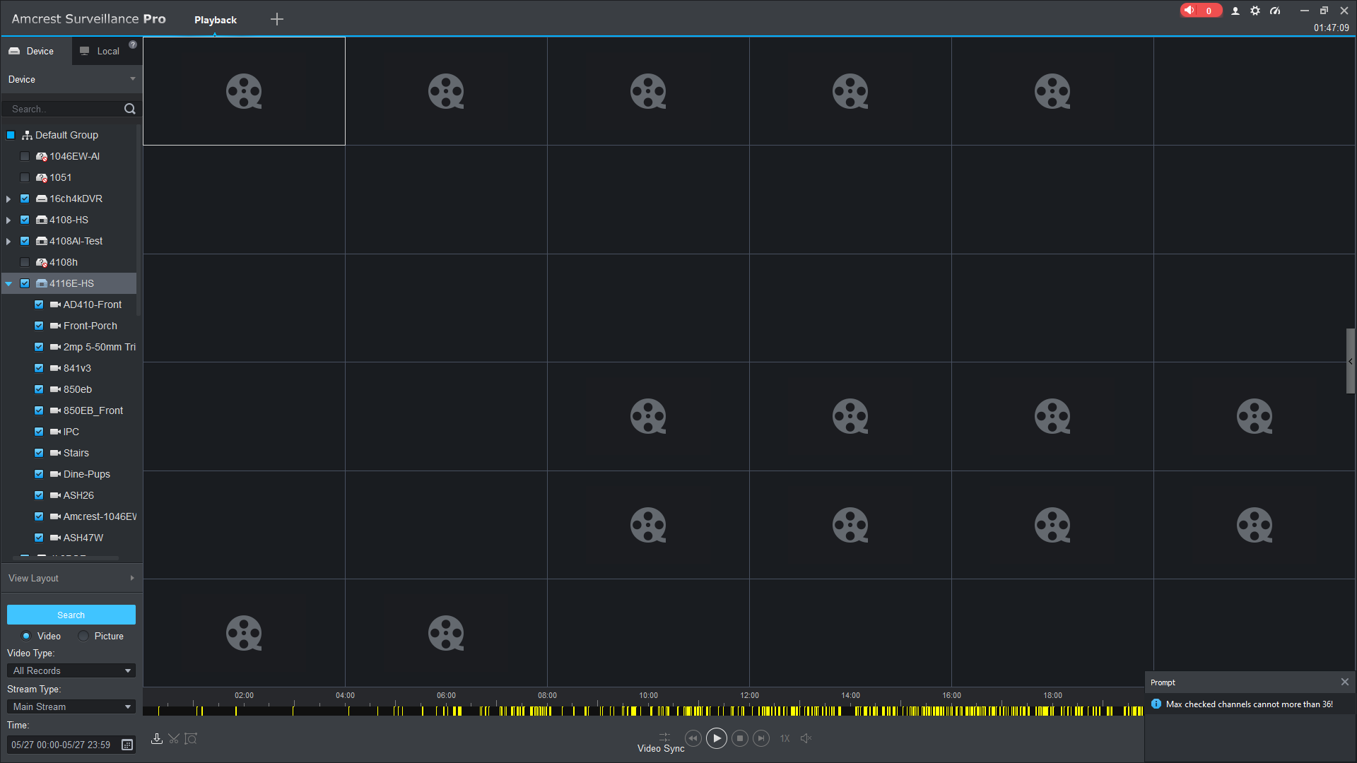

So as I said I don't normally do much with ASP.. I do have some Remote locations I use it for however I normally only watch 1 or 2 cameras at max 4 at a time however Normally 1 or 2.. I just looked with a few of my Recorders and I wish they would have put the ones with footage in the other spaces however it seems I only can do a Max of 36ch playback.. I had more then 36 choose and gave me a error at the bottom of the screen.
Screenshot (2512).png (86.8 KiB) Viewed 569 times
