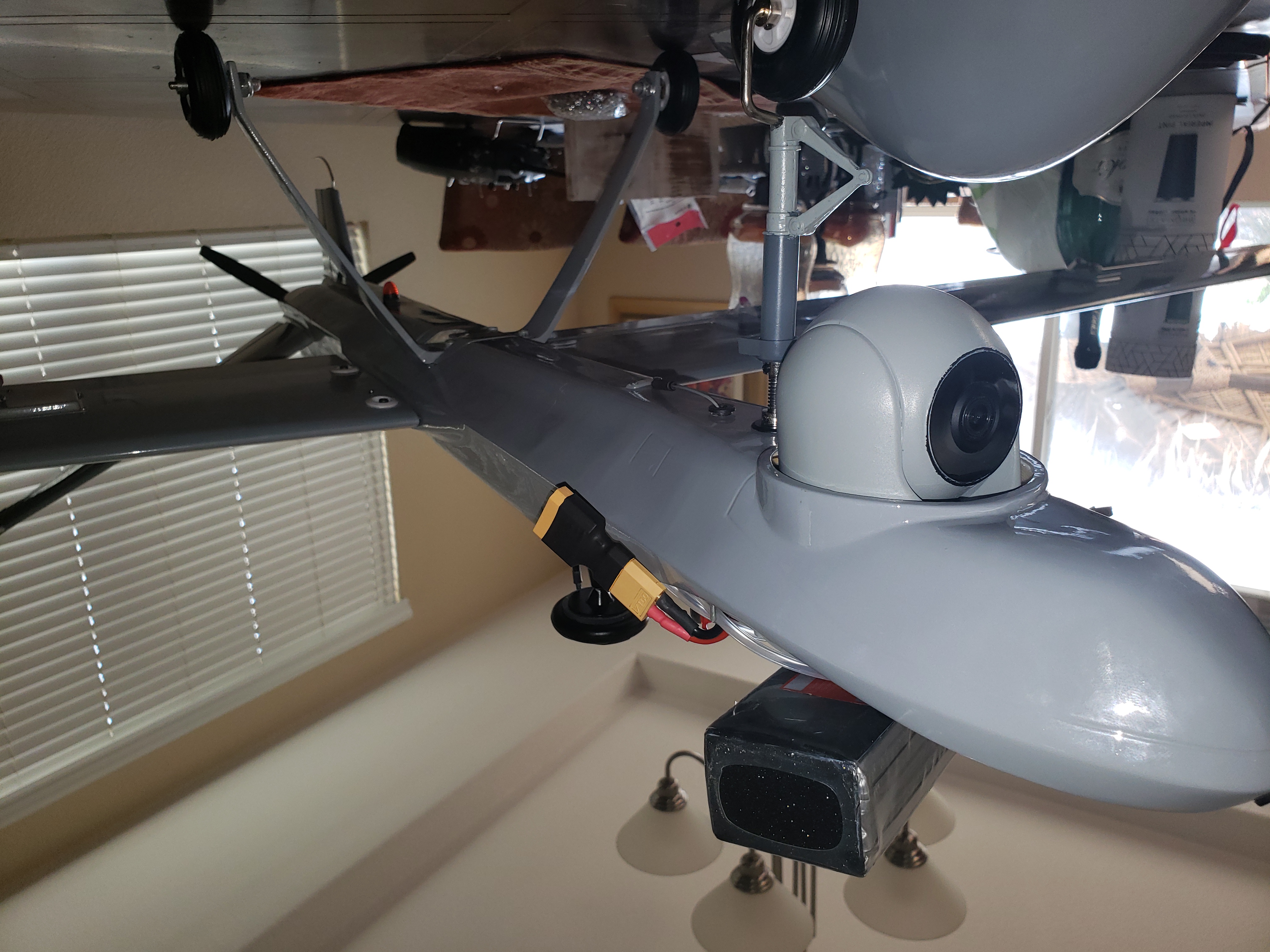

So, the project...
I am not using the camera for traditional home security. The camera will be used on a drone. I chose this camera due to the fact that it incorporates a working gimbal.
Hopefully this explains why I only need to connect 1 camera to pi via cable.

OH! Wow - a mini-Reaper.
From the Raspberry Pi forum, this might help...
https://www.raspberrypi.org/forums/view ... hp?t=78676
Re: Raspberry pi and Amcrest 2K remote cam setup
Yeah anything that looks like a MQ-9 I wouldn't be trying to put it in the Sky myself.. Looks cool wish you luck
