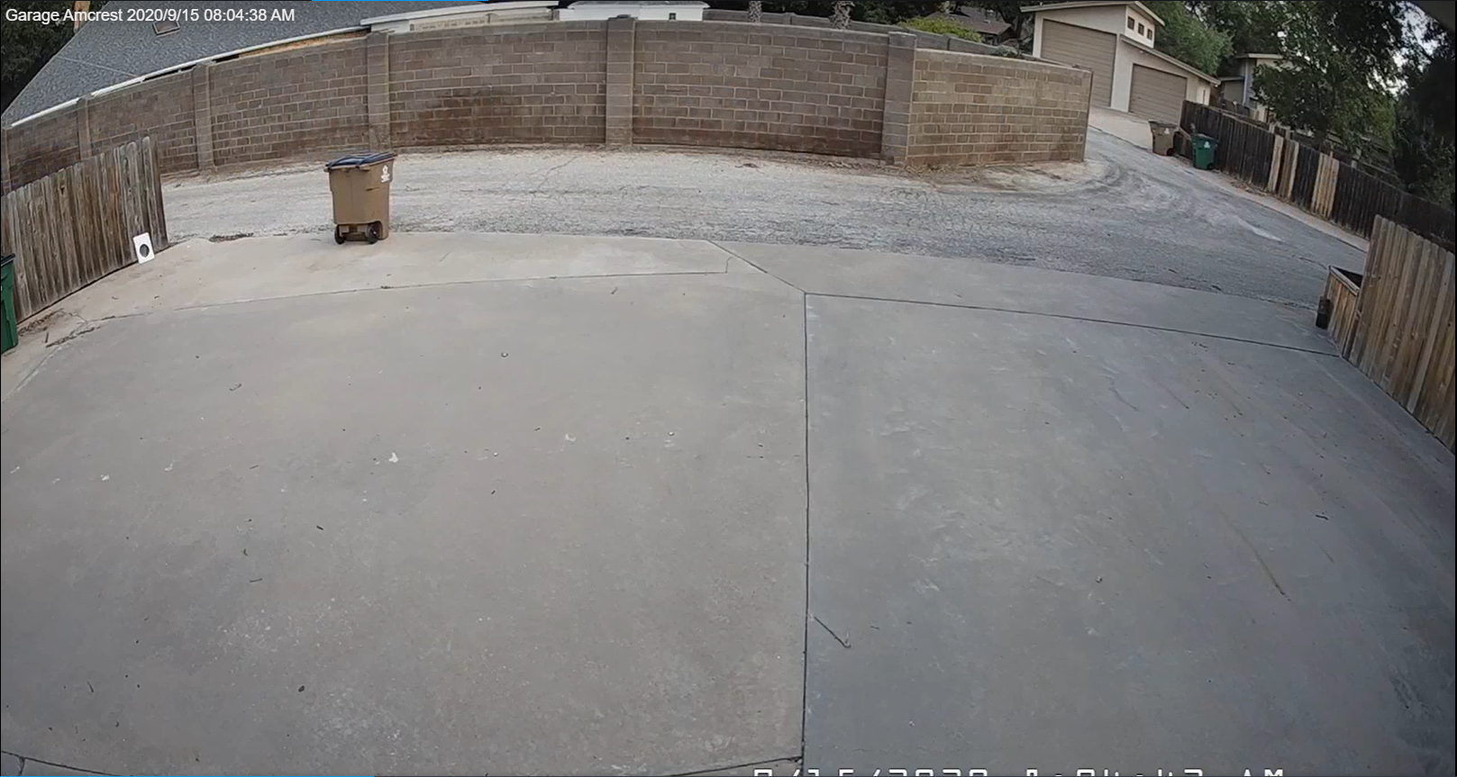

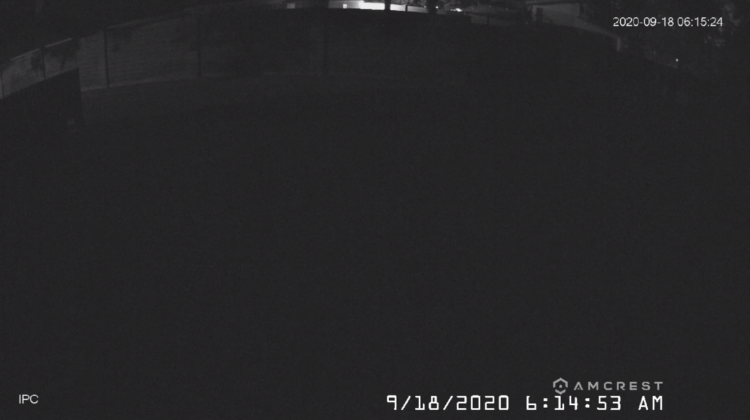

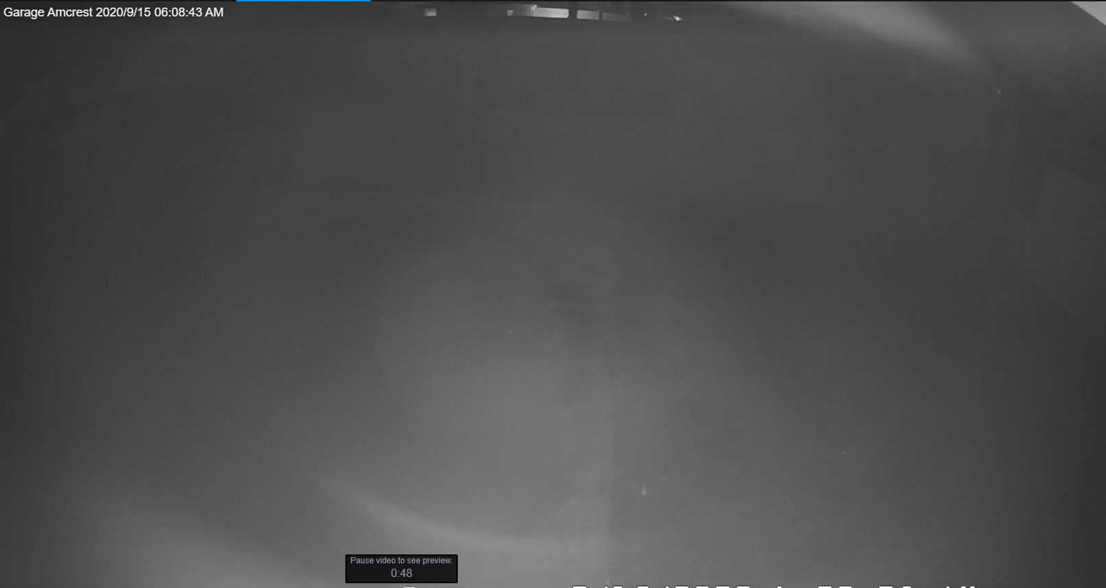

I purchased two of these cameras from Amazon. I only have one connected to see how well it works. So far the results have been very poor. The image is great during the day, but at night I cannot make out anything other than a few faint objects. It does not matter if the object is 10 feet away or 50 feet away. I tried with the camera default settings and then I tried to adjust the settings (increase IR power, etc.) but nothing seemed to help. I have attached the image of what this camera shows during the day and the same image during the night.
I am trying to determine if this is the actual quality of the camera or if I have a bad camera or bad settings. I have to assume it is either a bad camera or bad settings since the reviews and pictures on Amazon show great night vision. I don't want to open the second camera until I can get the first working, but I will if the first is deemed to be defective.

- nightvision.png (594.49 KiB) Viewed 2502 times
- day.png (1.49 MiB) Viewed 2502 times

Is the camera behind a window or inside some sort of protective enclosure? That looks like a reflected blur to me.

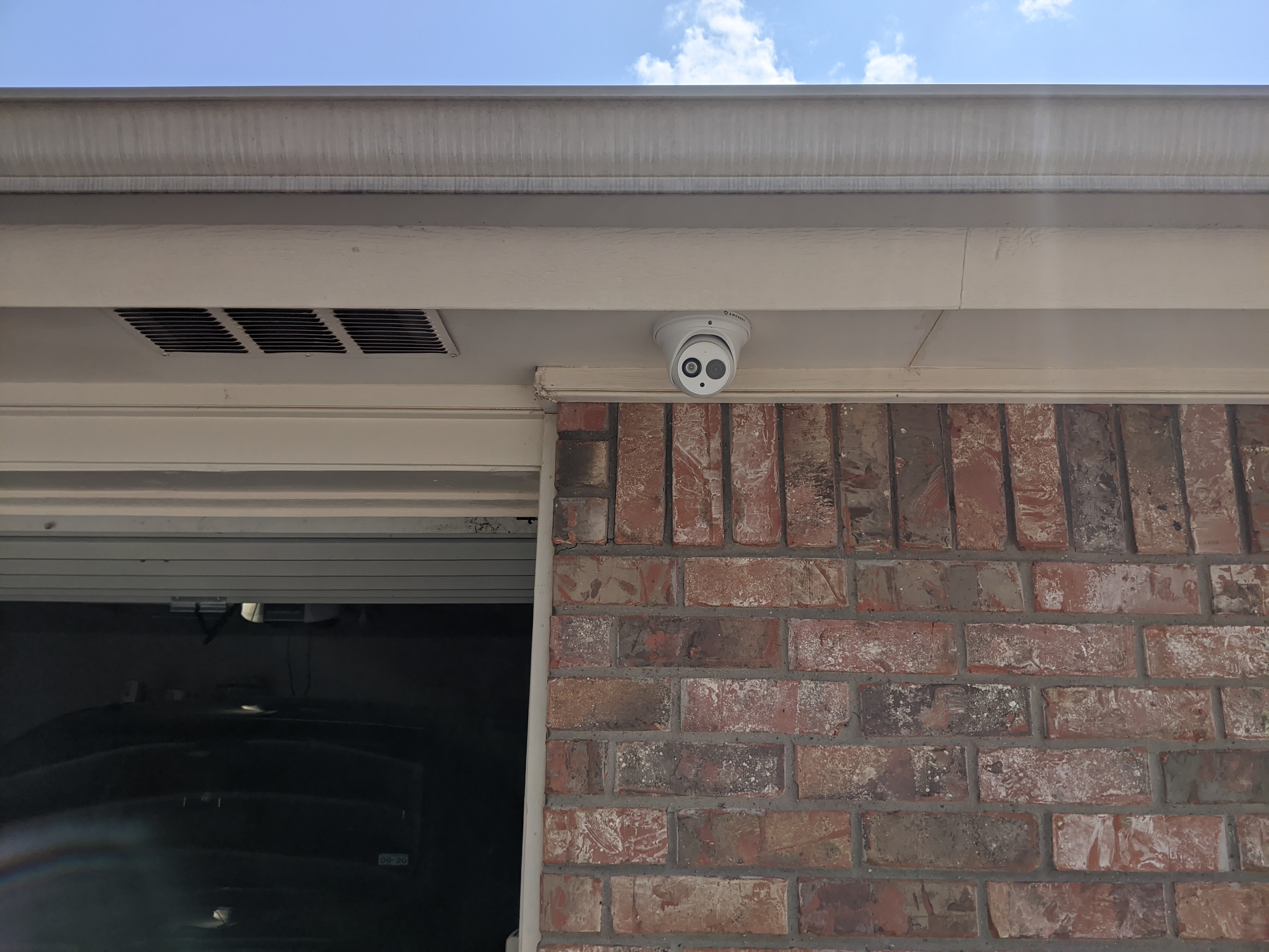

The camera is located on the soffit. I have attached a picture for reference. The is nothing in front of it that could be reflecting the IR beam.

The lens flares do strongly suggest infrared reflections. You can verify by shutting off the IR illuminator with the camera set to black-and-white at night.

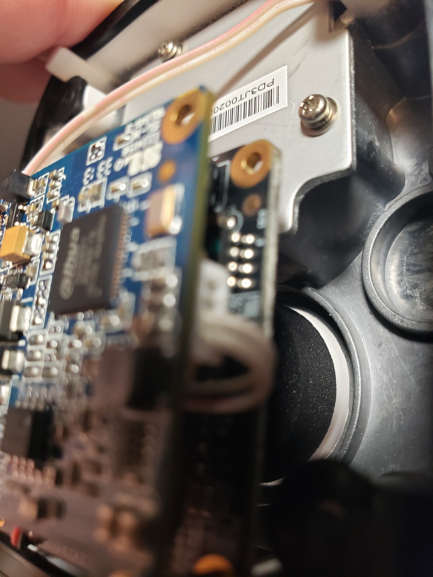

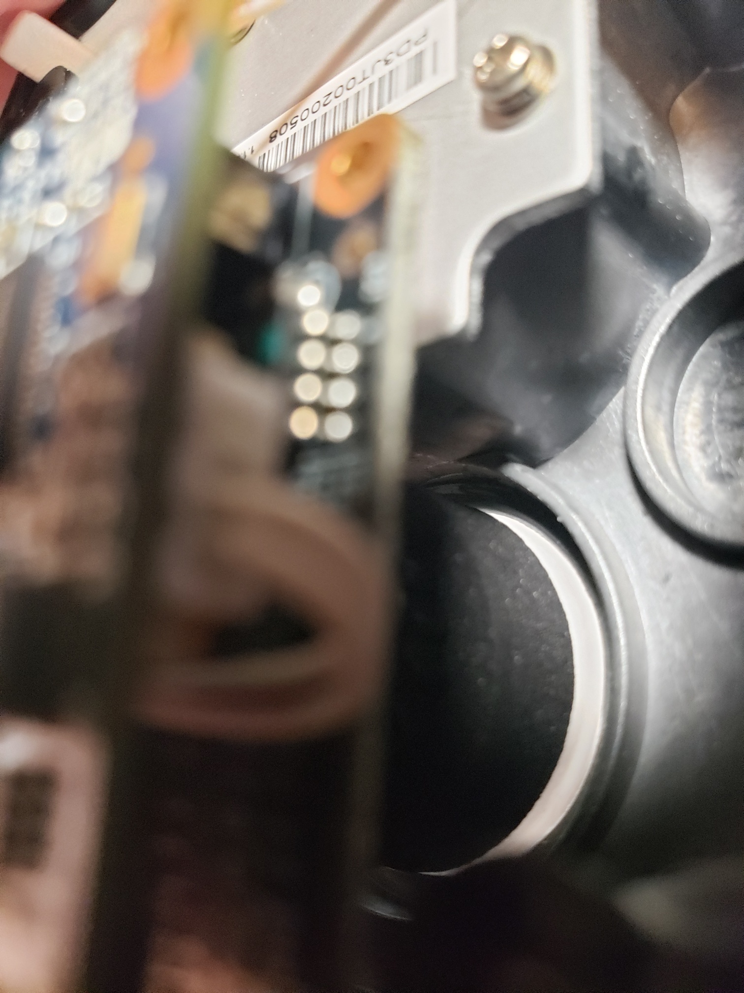

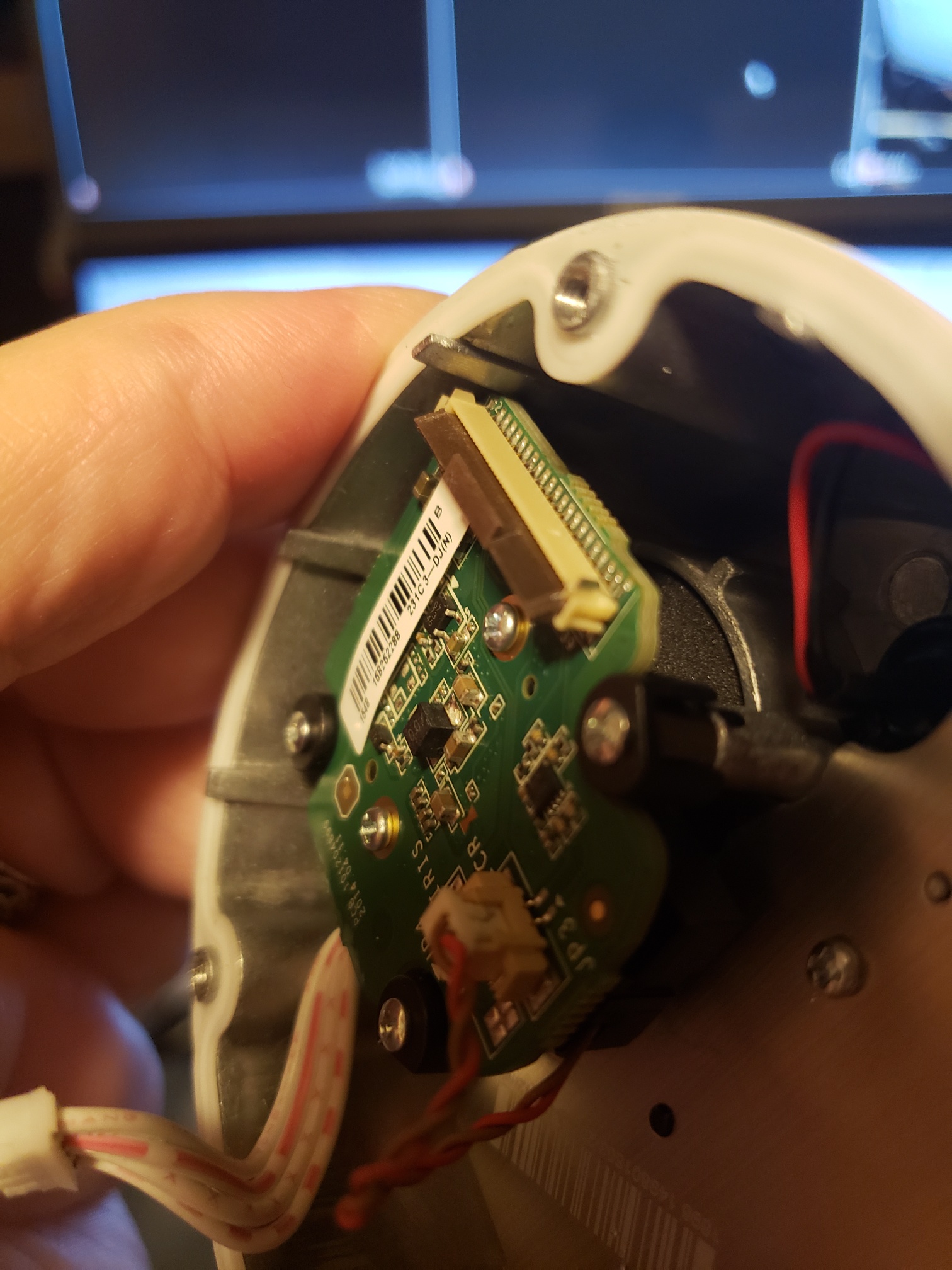

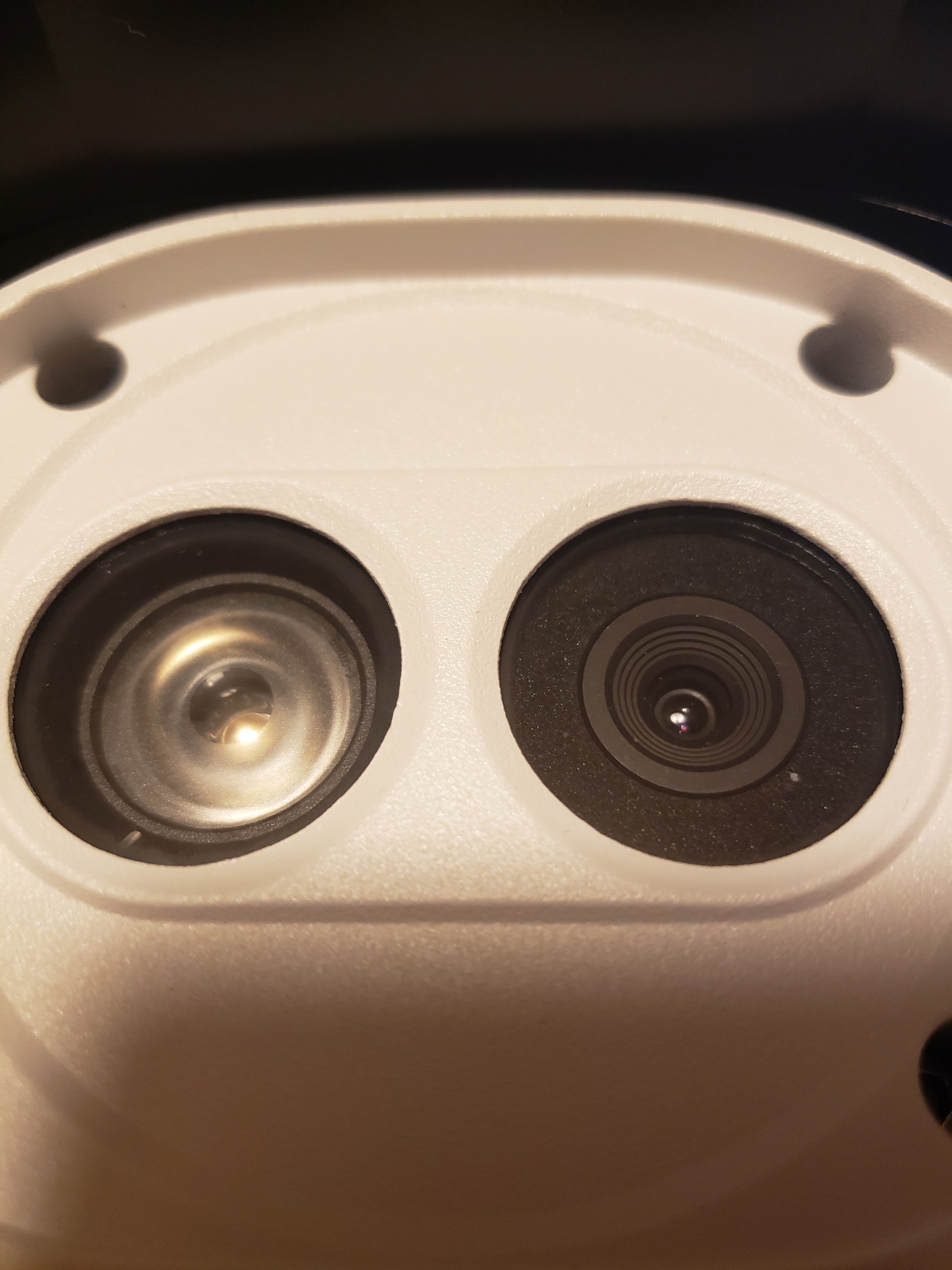

I took apart 2 cameras I own that look like this.. First was a TVI 1080P camera from 2014 and sadly there is no way that the camera and IR on my model could leak IR to the camera from within the housing seeing the IR is sealed away from the Lens area.. So I thought ok well I do have some Dahua CVI cameras that are kind of built this way however they are box cameras.. So I went took one down from my Shed and installed one of my Amcrest cameras in its place so I could take that one apart.. The Dahua is from 9-2013 and after taking this camera apart the IR is also closed off from the lens area...
Front of Dahua CVI camera Front of my Turret TVI camera Inside of TVI camera Inside the CVI Dahua Camera x 2 pictures

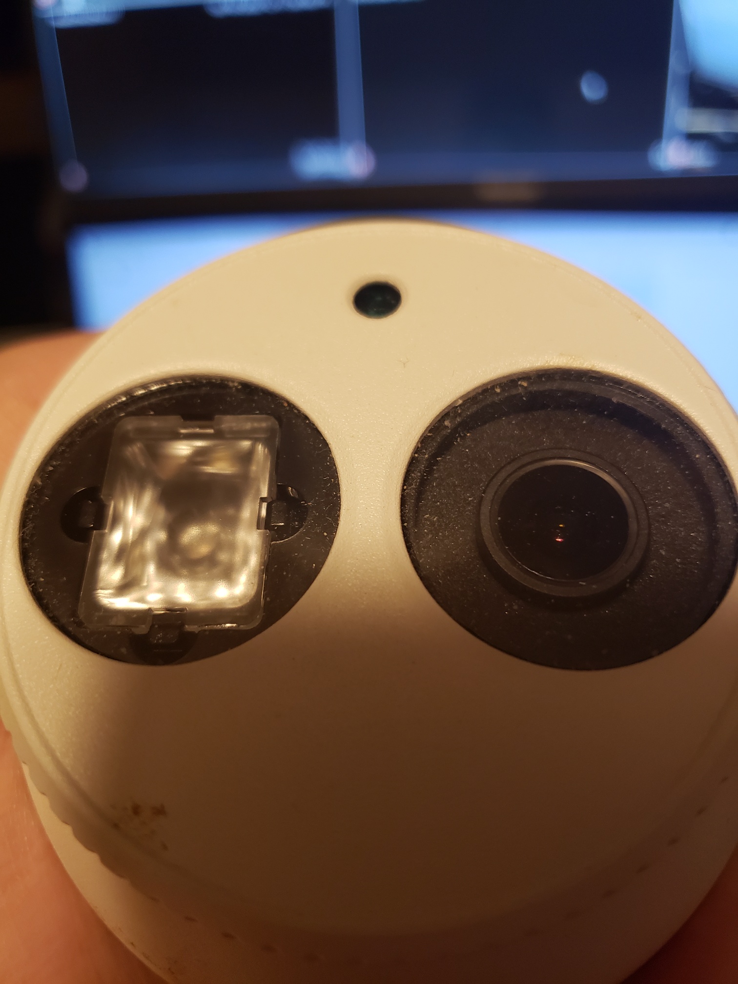

Thanks for the suggestions everyone. I experimented with the shutter priority and noticed it was already set to 1/30. I changed it to other settings(1/120, 1/250, etc.) and while the picture changed it didn't get any better. A little darker or a little lighter, but still washed out.
I tried turning the IR light off and the picture looks normal, but obviously very dark. That picture is attached.
I am going to try taking the camera down today and moving it to a dark room so that I can experiment with it at times other than the middle of the night.
