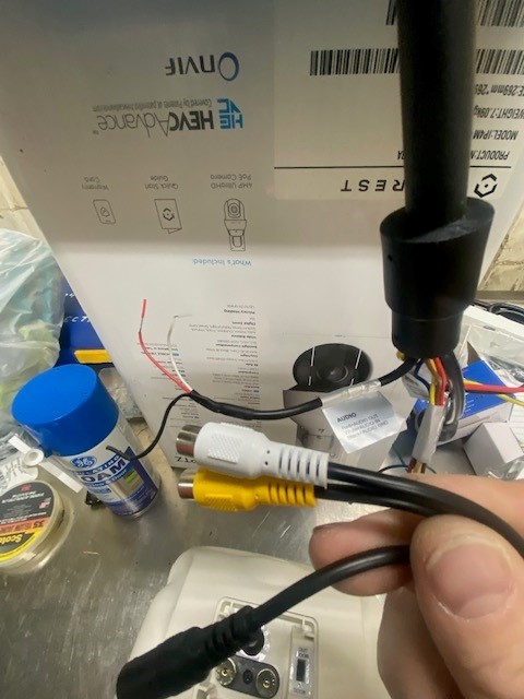

Camera has bare ends for Mic and Speaker with shared ground for power mic and speaker.

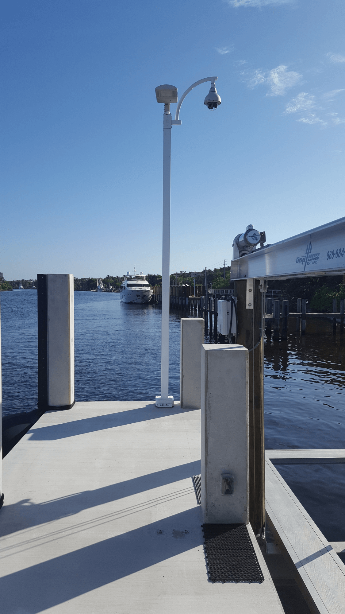

Thank you Jack7
The link to strongpoles and the amcrest 1083EW information this is very helpful. I think the pole is very stable at this point in winds (hopefully I am right). I don't see any issues at the moment with the shakiness of the lights. However, I was wondering about the lights being on at night interfering with the image of the 1083EW camera. Maybe I should get one of those arms that attached to the metal pole and go out about 3' and the 1083EW camera would mount onto that arm. What's your thoughts on mounting the camera this way? Would you mount above the lights at like 40' or would you mount below the lights at 30'ish. I know the mounts are pricey, but the camera will be up there a long time and I want the best picture and the best range of motion form the PTZ
- Boat-Slip-Pole.png (724.08 KiB) Viewed 1374 times

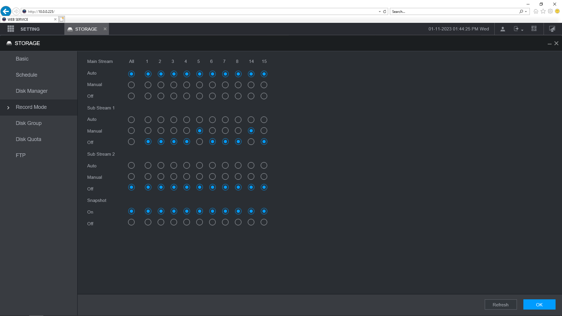

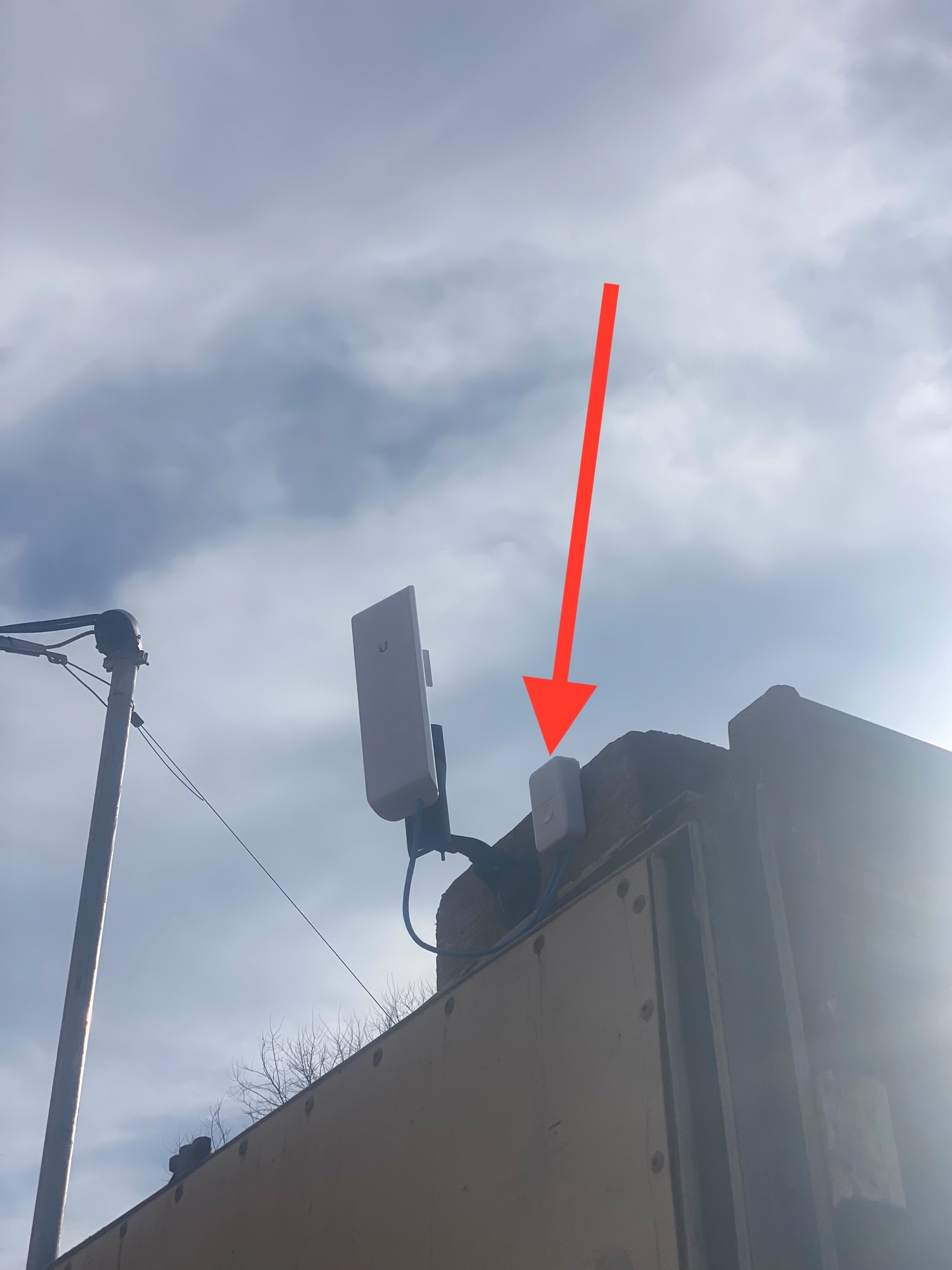

So, If I am reading your statements right ... I should put one of these ethernet surge protectors on the actually 1083EW camera? Like mount the surge protector onto the metal pole? And then also another ethernet surge protector on the inside of building before it plugs into the NVR?Revo2Maxx wrote: ↑Wed Jan 11, 2023 1:19 pm Yeah personally your pole seems to be well enough for 4 large lights. I wouldn't worry about a Stronpole unless you need to for business reasons. If you have a camera already looking at the area behind your PTZ then I would personally have no issue using a Dahua Pole mount adapter with the camera and mount it to the pole. If you were going to do so at the Corner. Or just mount to the pole if your able to would be strongest way to mount it

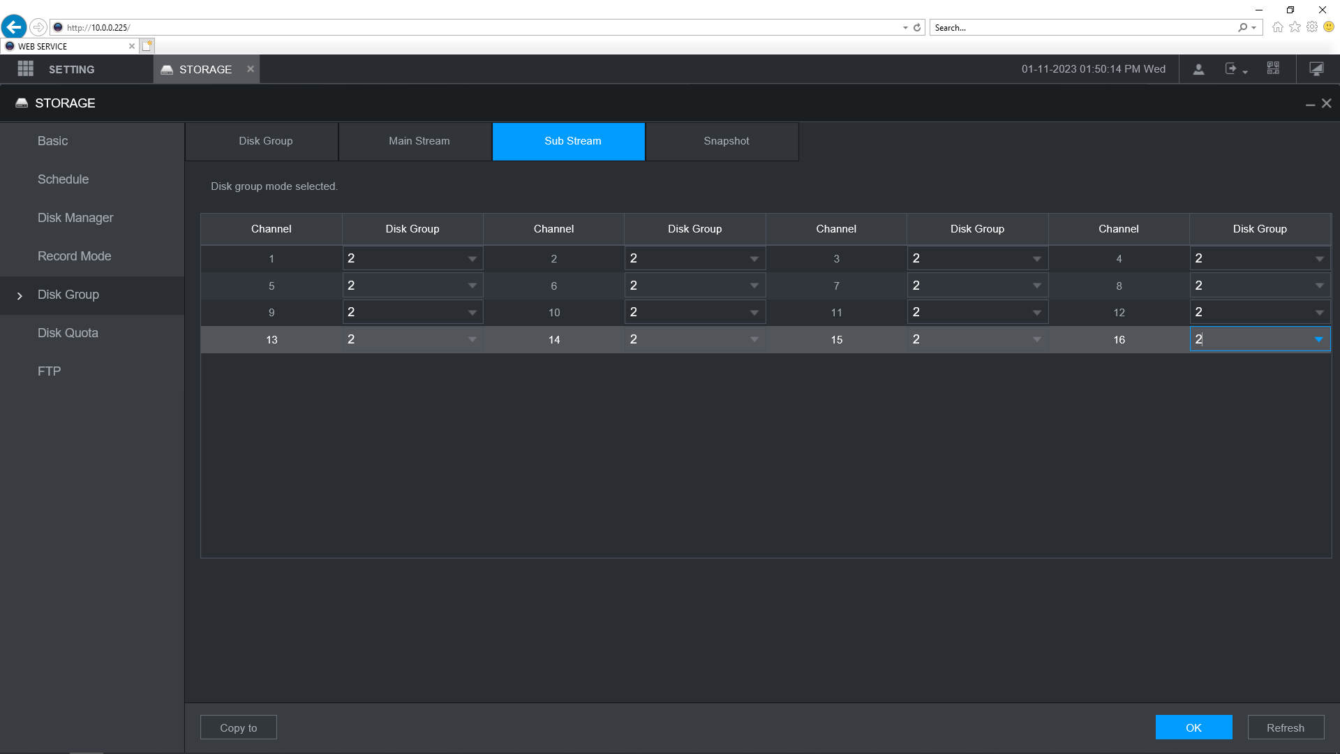

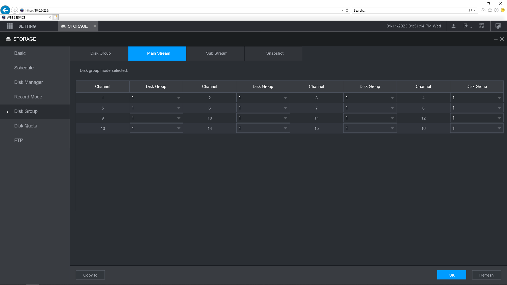

So Disk Group is the area where you can pick what and where your system is recording. It is kind of a Pain to setup the first time. Just click the area you want to setup, (Main Stream) it will load in and show all 16ch then use the drop down to choose what HDD you want it recording too. Then sub channel and snapshots again you will have to set them one by 1.. (See Pictures Below) Glad I just looked lol. I had 16 on the wrong HDD all the rest of them were right. I guess I got side tracked.. Anyway
About the Ends. I am not sure how far or where or how your running you're cables to your camera. The location of your NVR to that. But the reason I was saying STP is that it has Shielding that runs the length of the cable and with the ends connected where they are grounded as should be when running outside where lightning could be an issue. Ends are grounded and they connect to an connector that is then grounded to a ground rod and when working with a camera that is almost a grand that is one step I wouldn't pass really. However having your camera mounted below the lights and all wires running in pipe then my guess is it should be fine..
I am sure there are a lot of people that have just tossed a camera in the air and had it there without issue and Sure I have been one of them. I have also lost a few cameras along the way. Lucky for me I work in Electronics so I make my own repairs. But when it comes to a new 1083 that isn't a camera that I would be tossing around asking for lightning to try and fry it..
About shooting data. I personally wouldn't be for the camera feed. I have and do use a Nanostation loco but if it isn't perfect feeds can have connection issues. Using the data for connection to a outbuilding with a NVR and access WebUI over the air is best. 100% data coming from a Nano that you want to use for security it can happen but can have issues.

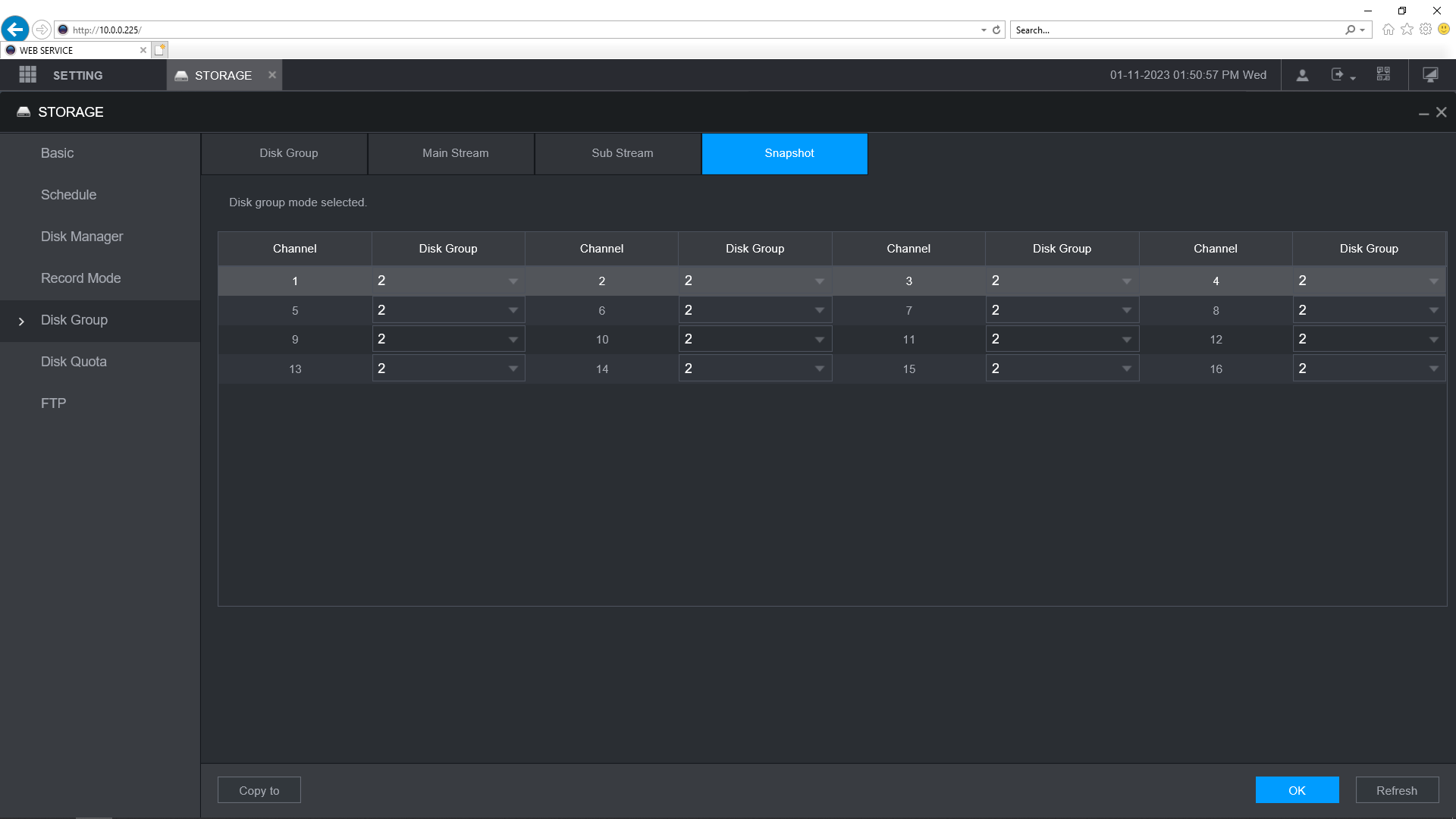

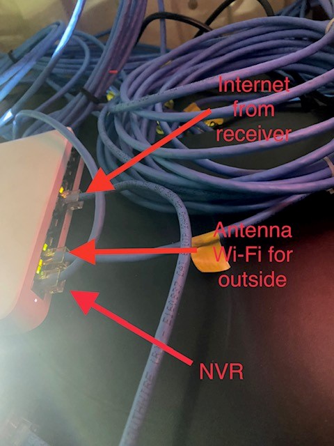

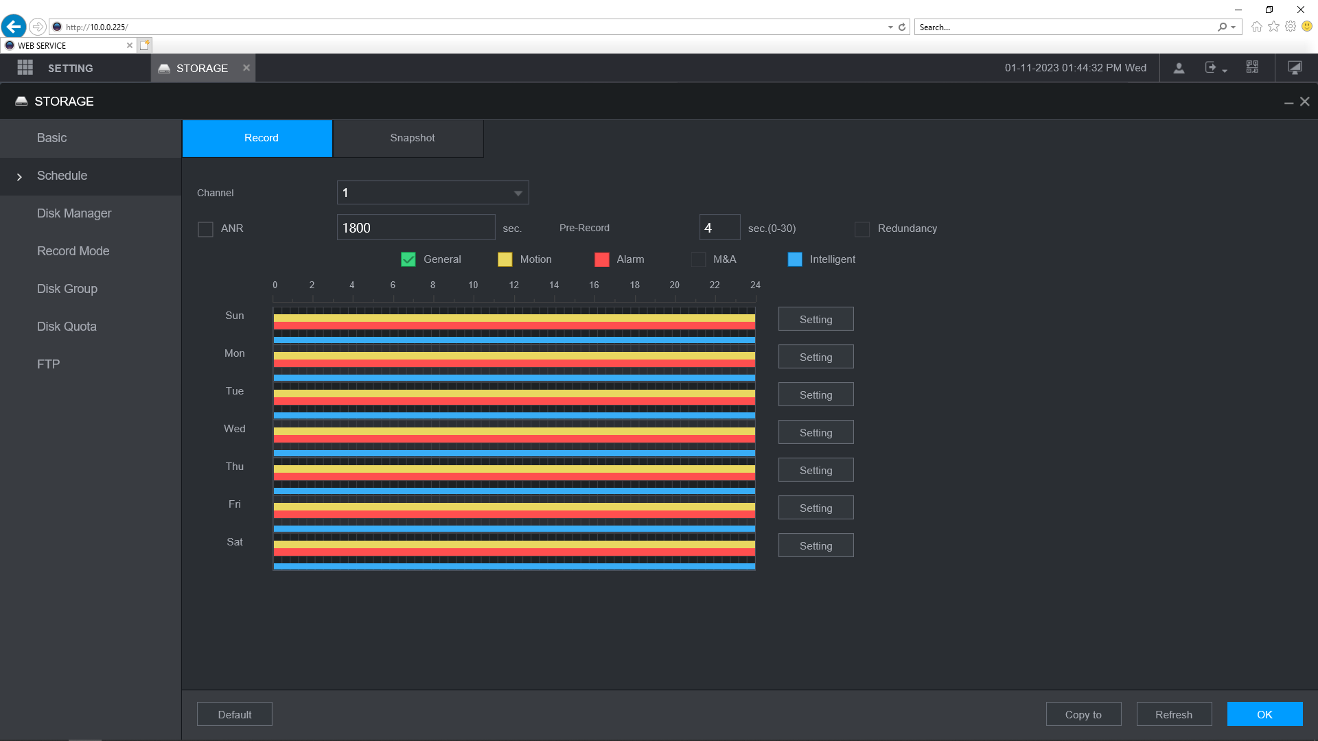

I have included some pics of the wifi set up (shooting internet from house) and the NVR and how I have it hook up right now. I have used all ubiquiti supplies for the wifi and for the external wifi for outside the shop. I have this set up on another network. The house is set up on its own network.
Switch Lite 8 PoE
https://store.ui.com/collections/unifi- ... lite-8-poe
Ethernet Surge Protector
https://store.ui.com/collections/operat ... -protector
- Wifi Switch.jpg (68.14 KiB) Viewed 1364 times
- Wifi 2.jpg (99.35 KiB) Viewed 1364 times
- Wifi 1.jpg (260.32 KiB) Viewed 1364 times

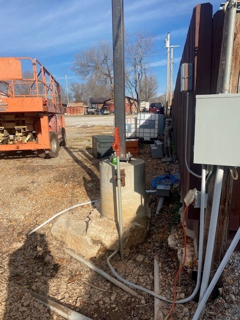

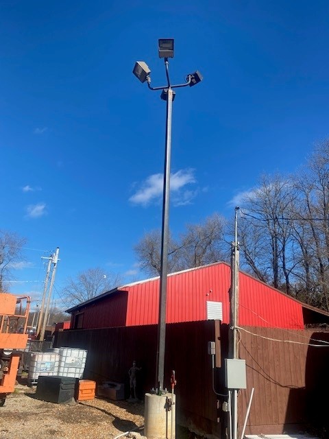

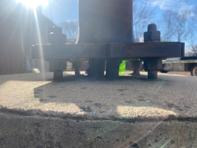

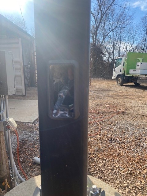

Here are some pics that also might help better understand my set up.
- Pole 3.jpg (117.06 KiB) Viewed 1359 times
- Pole 2.jpg (67.05 KiB) Viewed 1359 times
- Pole 1.jpg (100.11 KiB) Viewed 1359 times

2 things to think about when it comes to Shaky videos. 1 it is really a mess like jack7 was saying. Looking at your pole first thing that came to mind was that it was strong enough and while I might be wrong but your pole kind of looks like Steel and is on a large well planted base.
Second and worst part about these type of cameras is that the head is outside of the base of the camera. I have some normal dome cameras that I still use today that the camera is inside the dome and there is less shake. However them cameras also offer a DIS feature and is one thing I wish the Amcrest had. At least I have not been able to find one on any of my 850's or 853's. Might be a option on the 1083 I personally don't know. However keep in mind that if there is some shaky Video with the 1083 I would double check the cameras head. If the Belts stretch or wear out it might cause the shake even without the pole shaking. I have some older open head PTZ cameras that I have 4 of. 3 of the 4 was always very tight the 4th one even with DIS turned on would drive me insane. Even after replacing the belts in the camera there was shake and found that the motors were just not good. The thing with the Amcrest cameras they are very well built and normally the head once turned on is very stable. However I do have my 850's that the heads are starting to take on more air travel then I care and they are very well mounted. My guess is that it could be belt starting to wear or the motors. Going up to the camera I can move the head slight up and slight left to right. Because these motors are stepper motors it has to be bad belt or warn motors. (My camera is mounted to an area that it will hold my weight and I am not a little guy) So keep in mind that with the type of head the 1083 PTZ camera has there can be issues that are not related to the mounting area.
Looking at the manual there are features I think are in the camera that the manual don't talk about and there are parts of the manual that alludes to the idea of what I am thinking and that is why I say there isn't any or enough data about the camera. Lets just say this. I have a camera from 2014 that has the ability to setup per Preset if I want it color or B/W (Day or Night) and if I want that Preset to be IVS Intrusion or Tripwire. I know there is Deep IVS in the 1083 but I just don't know how Deep it goes as it really don't say when looking at the manual. So that is why I said first hand knowledge would be great. To be Clear, Manual shows features in Deep IVS preset under 1 and all the features are showing under 1 so that is why I am wonder if preset 1 can have Tripwire in an area that it could be used and then in preset 2 have it setup for Intrusion. My guess is that the answer is yes, However the manual don't show that in each of the presets it only shows 1 preset with different IVS rules in that 1 preset. Then there is MetaData info and my guess this is going to give stats on how many people, cars or non cars have passed the IVS scene. However in the manual it don't show any live info about it so one has to guess what it is. Also in the Report field again one will have to guess. I mean I have some stats on my 1046EW-AI Camera that I can get a Heat Map. Manual says you need a AI NVR to use the feature that isn't the case, I do have AI NVR and I can get the data from the camera or my AI NVR. People counting don't work as it should..
I was just trying to help with some ideas. I don't have the camera, I do have a good few PTZ cameras and was offering some things that I seen on what I would do and or have done with my own system.
Last part of the OP and Lights. Personally if you were under the lights on the pole I think would be best placement for your camera. If you are in an area like my where I have many days that are Humid, foggy, rain filled and or snowy keep in mind that you might need to make some adjustments on them days at night. I would look at using your cameras in Color at night and will be the best way to keep your scene at best view power. Reason I was asking about wanting more info with the camera, is my camera from 2014 that is older AI Tech I have the ability to setup Globe night time use in B/W and setup each preset in a different format. no matter time or day going to that preset it will change to color if set for color and or black and white if needs be. With a scene like yours, You could benefit from such setting. Have Global setup for Auto and this is good because if your normal preset areas are within your lighted area then color could work however if you happen to move the camera into an area where you light don't reach or would be good to work in IR mode with zoom ability the way I normally have my Amcrest PTZ's setup with ZoomPrio turned on. Sure my 853 wasn't setup that way because it was not being zoomed to far out so there was no need to use anything besides SmartIR. On my 850's I have them setup with Priority and when I zoom it to an area it turns on the Hi Beams lol. Having a camera 20 or more in the air with large zoom area I would look into using ZoomPrio rather then SmartIR. just saying. With having enough light and camera in Color it can help push past the beam that you might get from fog nights or nights with rain or snow. And having ability to have Global setup for IR will help to see things past your lighting area.
