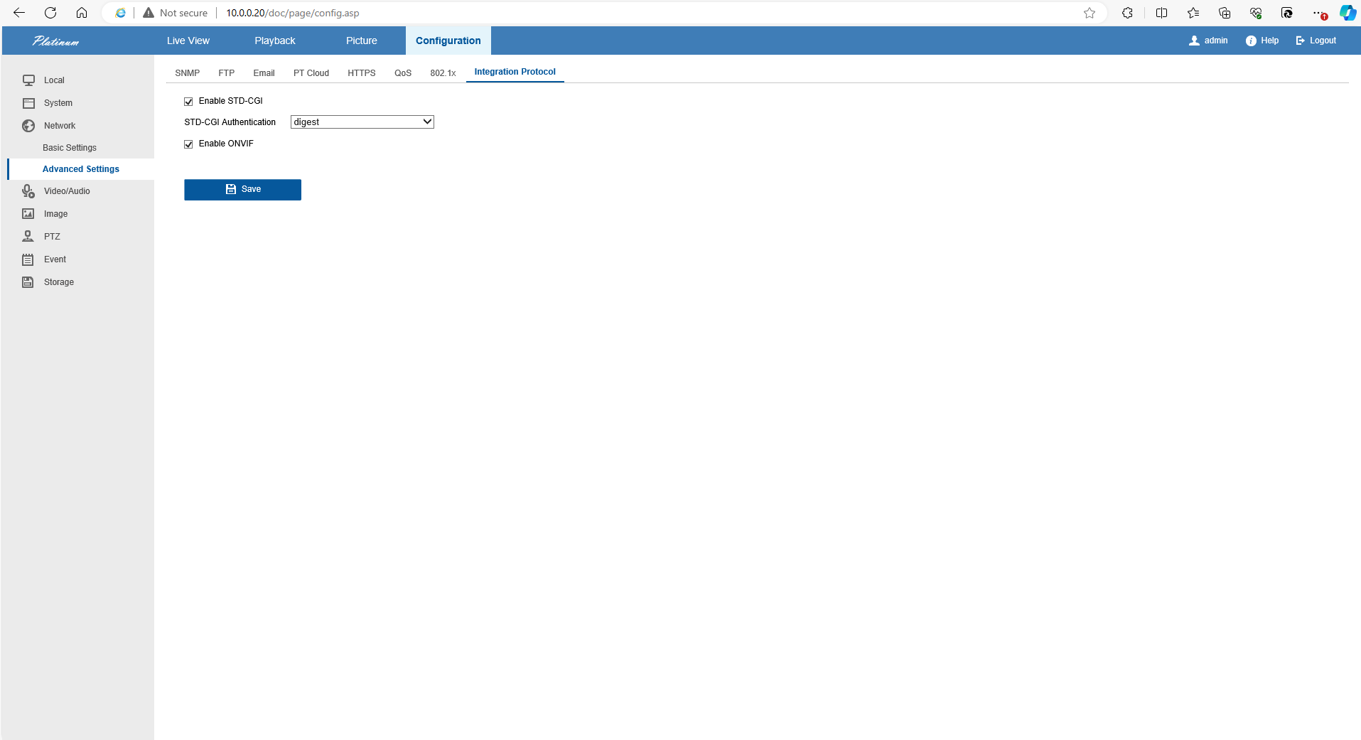

Also to dispel the idea of Dahua being ones using. This is from a Hikvision OEM PTZ camera
Screenshot (825).png (40.26 KiB) Viewed 32622 times
